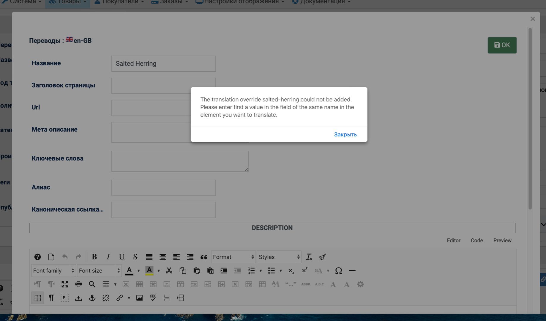

-- Error-message(debug-mod must be tuned on) -- : The translation override could not be added. Please enter first a value in the field of the same name in the element you want to translate.

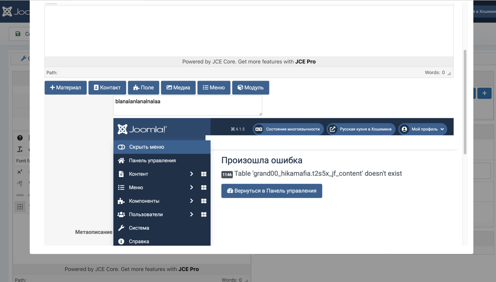

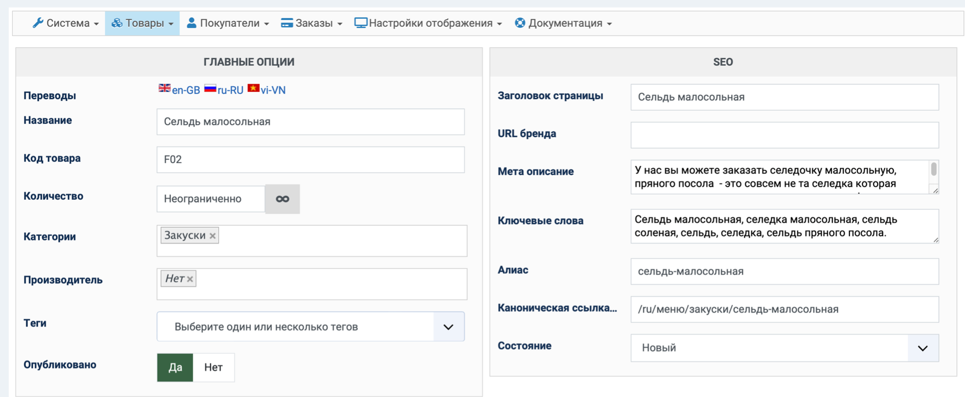

just bought hikashop. I did the translation manually, but I get an error when saving. meta description, keywords and everything else is not saved
Why do three languages appear along with my main one, instead of two additional ones ???
Why does this error appear in the translation window _hikamafia.t2s5x_jf_content' doesn't exist ?
Wtf there is no documentation on creating a multilingual store ???

The first message indicates that you're trying to add a translation before adding text in the main field.
So before you fill the translation popup, please make sure you fill in the main product fields.
You can't enter a translation for the product name if you didn't enter yet the main product name.
Regarding the "jf_content" table, that's a table from Falang. Are you using Falang on your website ?
Could you activate the "debug" setting of the joomla configuration and try again ? It should display an error message with more information on where the problem comes from which will allow us to tell you what to do.

Thanks for the quick fix. Please tell me why the Russian language is repeated in the translation? My site defaults to using it. Before I used the component VikRestaurant. there were only two languages additional English and Vietnamese

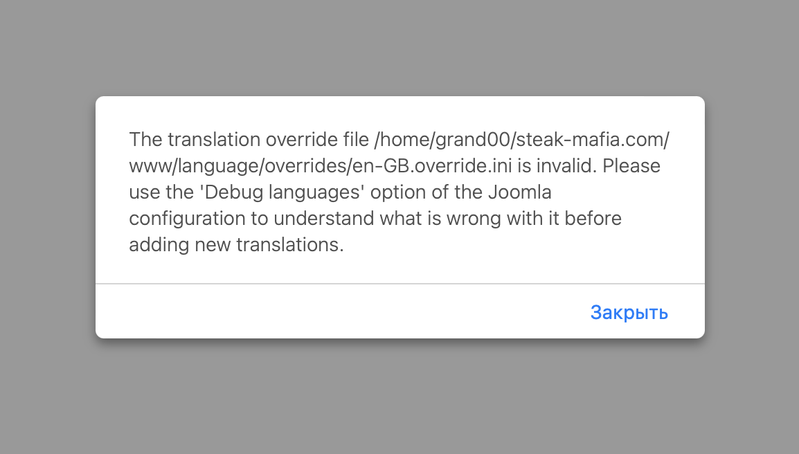

But And when saving the translation, a window appears with the message
The translation override file /language/overrides/en-GB.override.ini is invalid. Please use the 'Debug languages' option of the Joomla configuration to understand what is wrong with it before adding new translations.
No work again. Vietnamese saves translation but English does not save...((( For sample Salted Herring
Canonical links not generated, Product name and Category not translated

Regarding the error "The translation override file /language/overrides/en-GB.override.ini is invalid. Please use the 'Debug languages' option of the Joomla configuration to understand what is wrong with it before adding new translations.", I do get that message. I actually had that message before when I first arrived on your website. I followed the instructions of the message and edited the language override file under the Languages tab of the HikaShop configuration. There, I could see an invalid line:
i.imgur.com/94gwGxt.png
If I remove that invalid line, then I can translate text again on your website and everything works fine.
The problem is that I don't know how you are able to get that wrong line added to the language file.
Could you provide precise instructions on how you added that "<p>salted-herring</p>" text ?

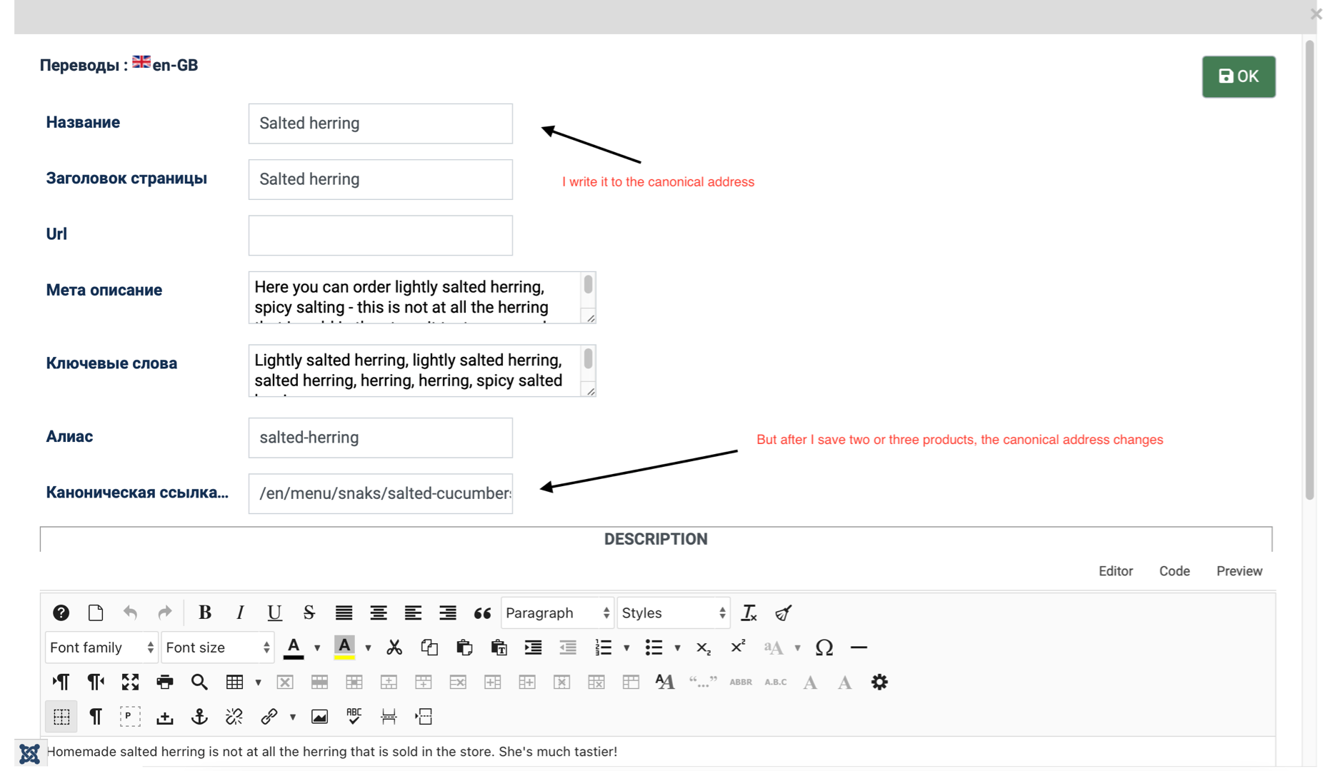

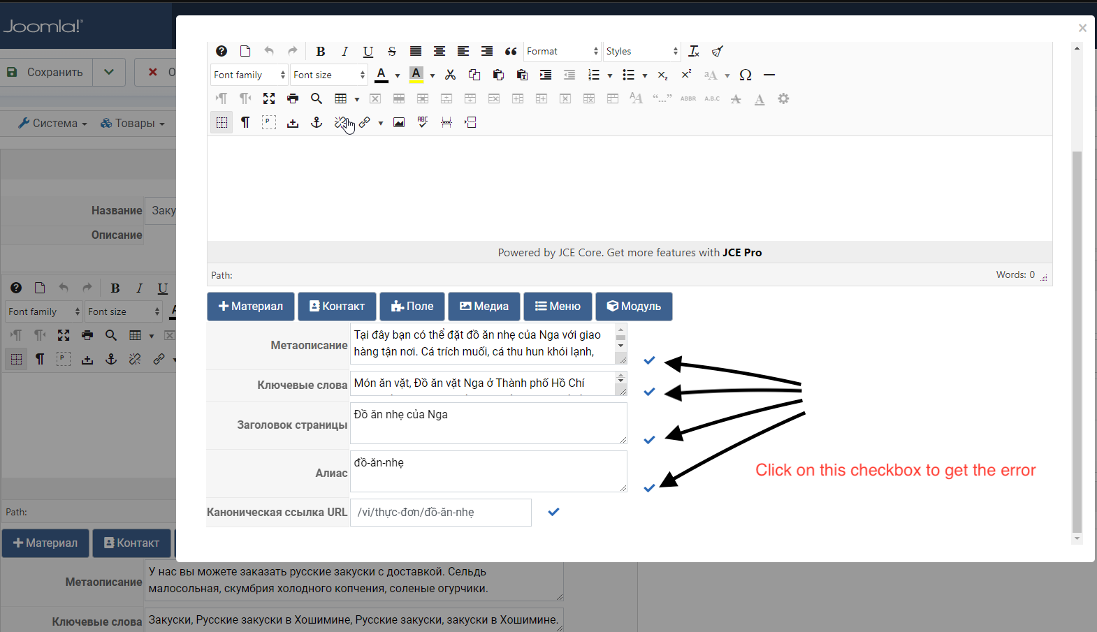

1) Vietnamese and English names of products and categories are not translated. Although they are translated in the editor
2)Why are canonical links not generated?
3)Why if I remove the canonical link in one product - it is removed in all products
4)For example, I am writing canonical links for three products. Well, when I go to see what the canonical address of the first product is, for some reason it changes to an arbitrary one. As a result, I click to see a herring, but I see a cucumber. This is some hell!!!

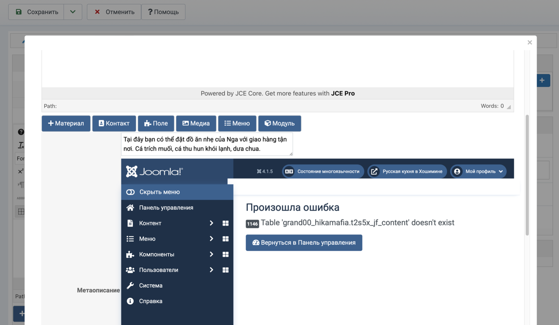

Error for sampe:
1146 Table 'grand00_hikamafia.t2s5x_jf_content' doesn't exist
Call stack

And regarding points 1, 3 and 4 you raised, these are all coming from the same issue. The system wasn't meant to support non latin letters for the key of the translation. The patches I made earlier were incomplete. So I worked further on them and ended up adding an extra option "Non-latin translation keys" in the HikaShop configuration which I've activated on your website. That way, with that option activated, the translations work fine. So please test but it should be much better now. Thank you for your feedback on these too.
Regarding point 2, canonical URLs are generated, however, the translations of the canonical URLs is not yet supported by the system generating the canonical URLs. There is no easy fix here. It would require complex coding. I'm afraid you'll have to enter the canonical URLs for the translations manually for now.

Thanks for the work you've done! Unfortunately, point 4 does not work. :(
You can see for yourself. Manually write down the canonical address for lightly salted herring and salted cucumbers. And you will see that after saving it will change. Accordingly, when you go to the product, you will see a completely different product. :(
I found a pattern: I wrote the canonical address in a category or product. And the same address was automatically cloned into all other categories and other products. Product description is not translated either. I hope I explained clearly. I do not understand what the problem is... I hope I explained clearly.
What can I say ... I was lucky with languages :) :) :)
