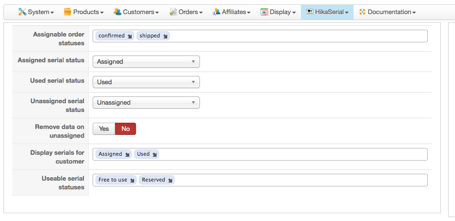

How to configure hikaserial to send to user his serial by email after payment confirmation?

You just have to set the option : "Display serials for customer"
www.hikashop.com/support/documentation/1...play_serial_statuses
Once the order have the "right" order status, HikaSerial will add automatically his content (with the serial information) into order status notification emails.

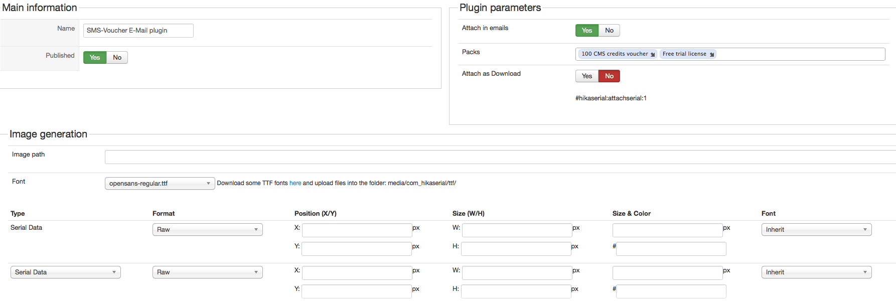

today I test the attach serial plugin. The Standard setting was set. (confirmed, shipped). I test with sandbox. I don't know why IPN does not work via sandbox. So when I manually set the status to confirmed, no e-ail with serial will sent out. When I set status shipped, e-mail goes with serial out. What could be wrong?

About your attach serial configuration ; the configuration is currently "empty". There is no image so the plugin won't provide you anything if it does not have a image to work with.
