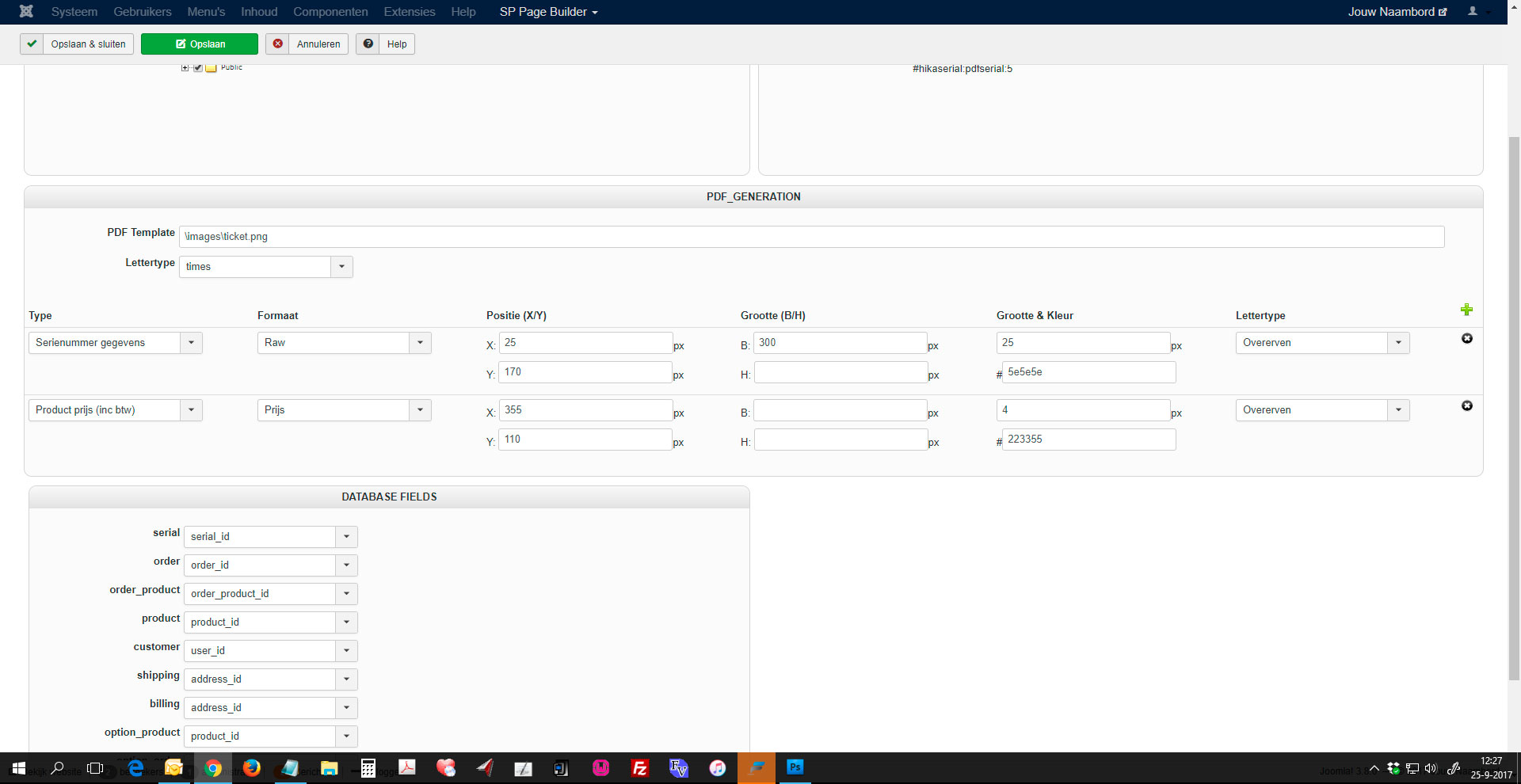

9 years 1 month ago #279181 by jouwnaambord.nl
Hi Jerome,
My pdf is about a A5 format, so that should not be a problem then. The file in the attachement is my pdf file. The path is /images/cadeaubon.pdf

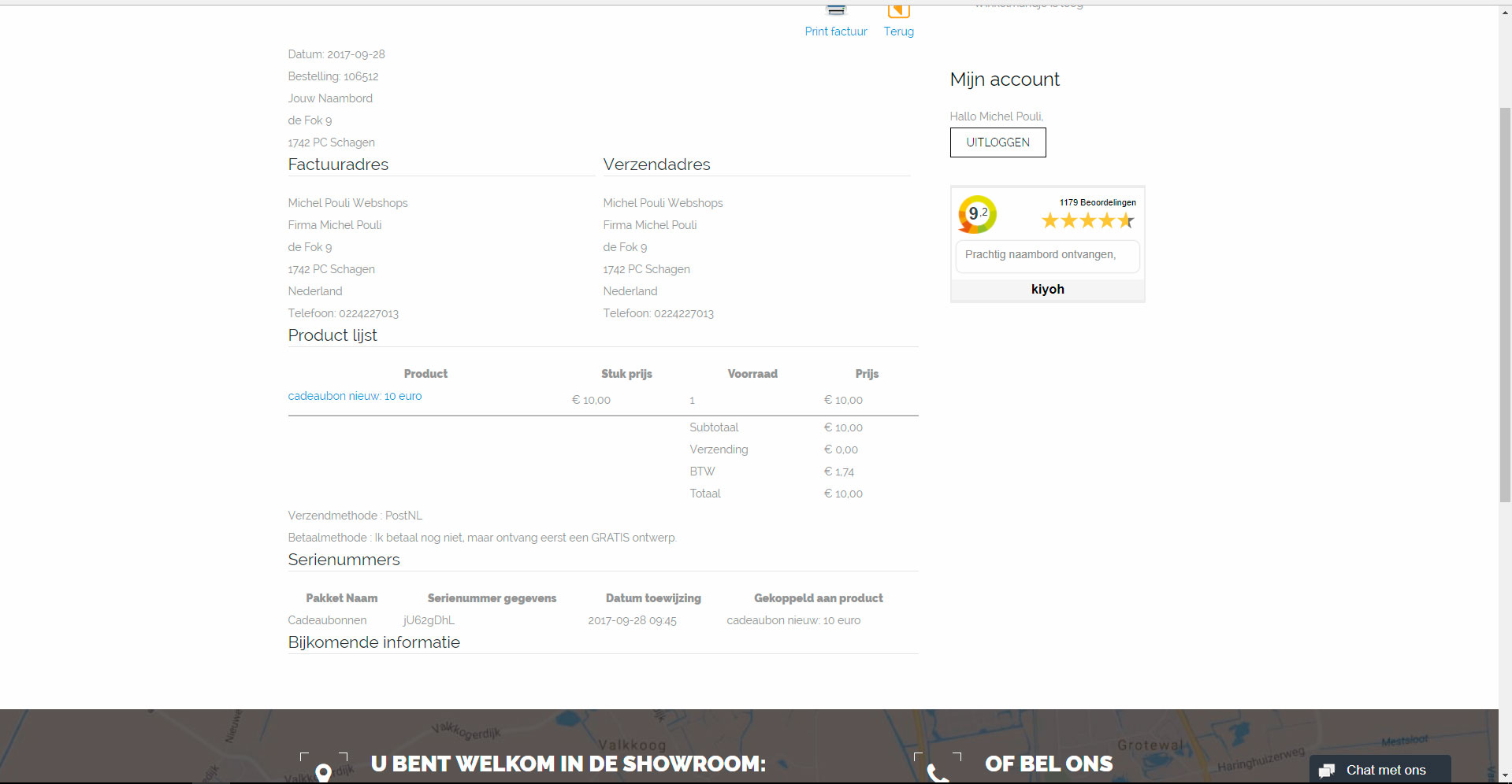

Sorry, my mistake, usually a relative path starts at the root. That's solved, thanks.
The pdf is send to the customer as attachement in the email, but it doesn't show on the orderdetails in the frontend for the customer. The serial info is shown, but no download is available (see screenshot).
9 years 1 month ago #279316 by Jerome
If you want to provide a downloadable file ; you need to add a "file" to your product.
And instead of providing an URL, you give the code that the plugin indicates you in the configuration (just below the "yes/no" of the attach as download setting).

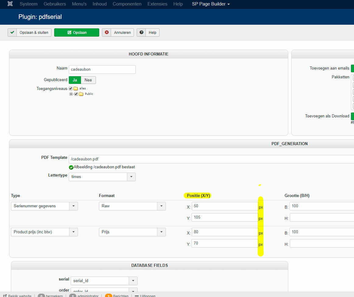

9 years 1 month ago - 9 years 1 month ago #279556 by jouwnaambord.nl

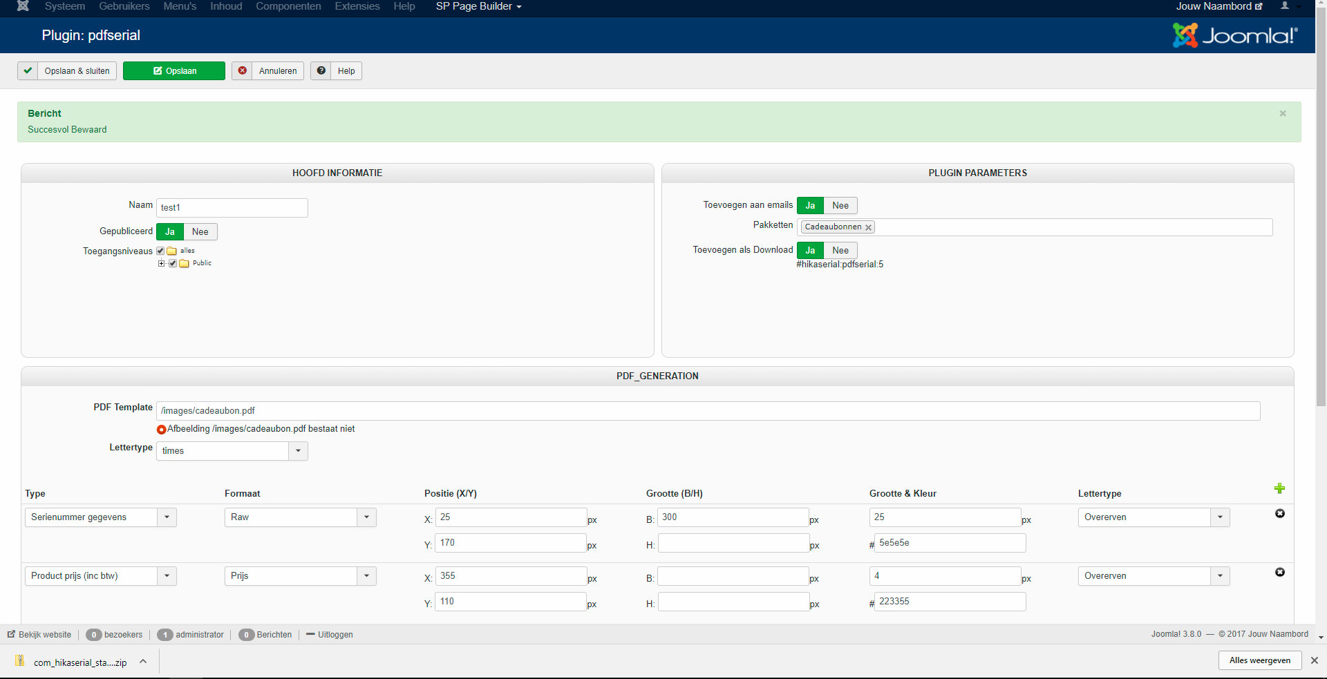

Thank you! Could it be that I was somewhat misguided as the pdf layoutsheet has pixels as input instead of mm (see screenshot)?
I want to add the price to the giftcard, but none of the fonts accept the standard € (eurosign), see screenshot.

9 years 1 month ago #279598 by Jerome
My bad !
Because I forked the "attach serial" plugin to create the "pdf serial" plugin, the configuration view did not evolve a lot.
I'll change that.
Regarding the fonts ; I just included the basis fonts in HikaSerial because the UTF8 fonts are really heavy.
For example the "fonts" folder in TCPDF is 28MB (15MB once compressed).
I didn't want to let HikaSerial package become huge since most of web hosting won't authorize the upload if the installer is bigger than 8MB.
That why, I let a special directory to let users place their fonts.
It's in media/com_hikaserial/fonts/. You will find two folders for the two libs and you can upload the fonts you want there.
The PDF serial plugin will automatically detect the fonts in the configuration so you will be able to have an UTF8 support with the € character.

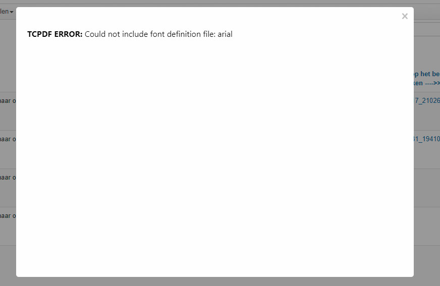

9 years 1 month ago - 9 years 1 month ago #279640 by jouwnaambord.nl
Ok, I did understand and tried that earlier, but I get an error, see screenshot. I placed Arial.ttf in all 3 the folders to be sure, but no success.

9 years 1 month ago #279642 by Jerome
You have to put fonts from the TCPDF lib itself.
Unfortunately, it does not work with TTF files ; it needs special converted files.
So please download TCPDF to get the fonts from it.
As I told you the fonts of that lib are huge and I can't include it into HikaSerial.

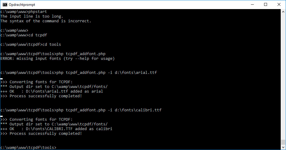

9 years 1 month ago #279741 by jouwnaambord.nl
Sorry, I think I need some more help by that. Downloaded the package, used the tcpdf_addfont.php to generate pdf font. I get 3 different files (calibri.php; calibri.ctg.z ; calibri.z) wich I copied to media/com_hikaserial/fonts/ . But the new font is still not recognized. The font files are quite small, so maybe I'm doing somtehing wrong?
Please let me know the procedure how to get the correct large files your talking about?
