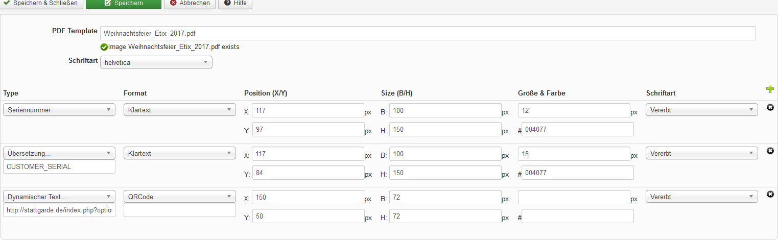

I tried to configurate the PDFSerial. There is no problem to integrate the serialnumber or the customers name. But I do have problems with integrating the QR code. I do use the dynamic text (like I do with the AttachSerial) and set it to "QR Code" into the field below I copied the following:
stattgarde.de/index.php?option=com_hikas...k=consume&hikaserial [serial_data]={serial.serial_data}&hikaserial[format]=html&tmpl=component
When I set the order on "shipped" to create the email with the PNG and PDF I get the following error:

Hi!
