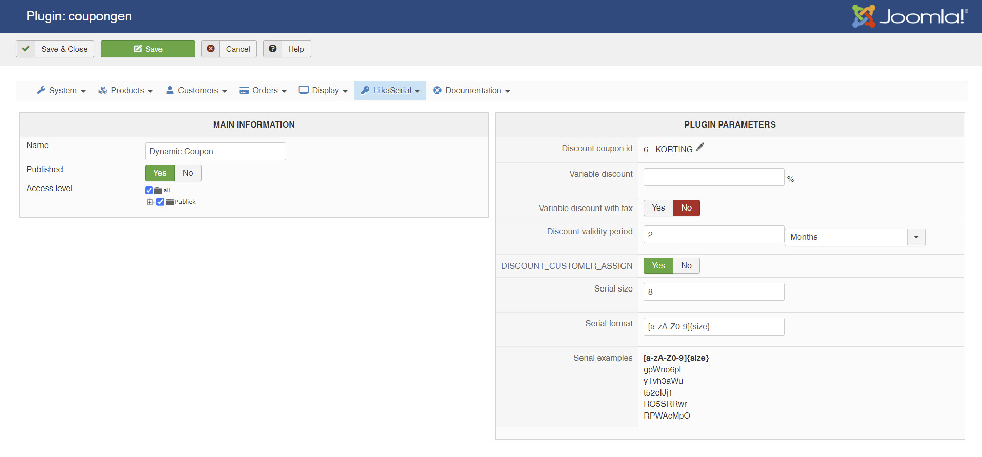

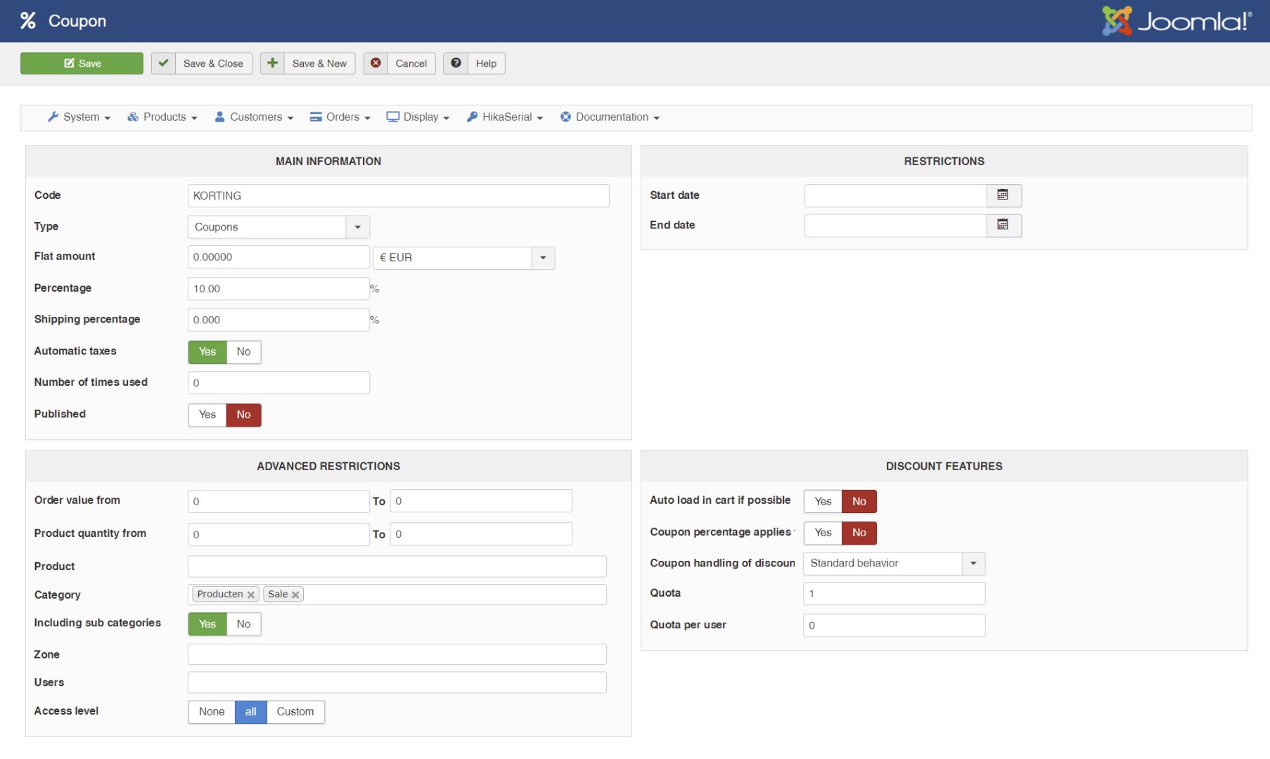

For your coupon "KORTING" (your template), you want to set the "quota" so it can be use only once.
If you just want the customer to be able to use it, in the generator, you can use the setting "Discount Customer Assign" (even if the translation is not up to date, I'll look into that).
For the rest, it looks good.

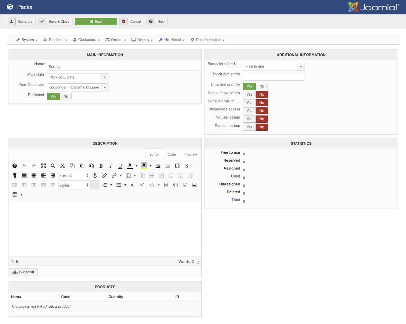

Replied by Lumiga on topic How to add a coupon to every order with HikaSerial?
Hi Jerome,
we have adjusted your two points but how do we get this linked to the e-mail?
At the moment we see no coupons in the confirmation emails.
Maybe because we haven't linked it to a product. But we want to link it to all products. Where can you determine that?

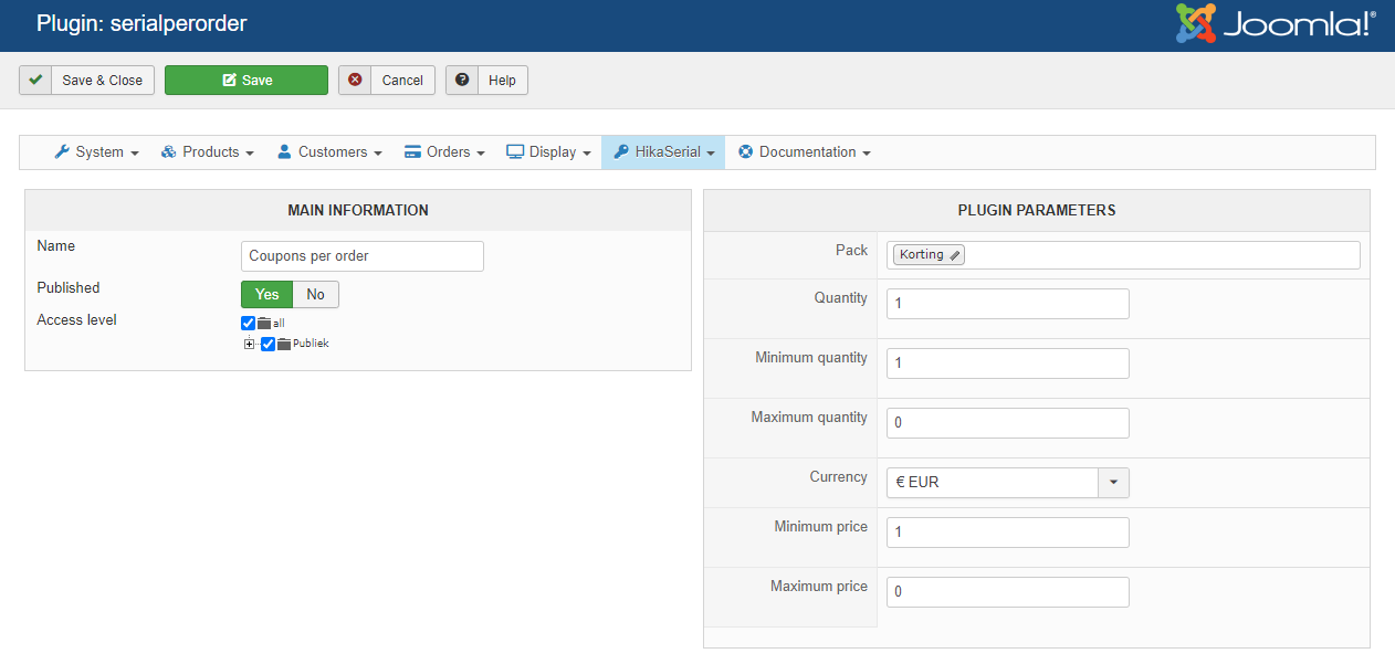

Do you have the plugin "Serial per order" ?
Hi Jerome,
Sorry for the late response!
But today we have published the plugin en did this configuration.
So you think now everything is fine?
Do you know where can we provide coupon information (a short description that will appear with the couponcode) in the e-mail?

With that plugin configured and enable, you should have a serial (coupon) created for each order yes.

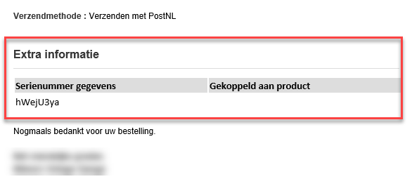

Hi Jerome,
It's working perfect. Thanks!
One last question:
It's working fine with real orders and real payments.
But when we create an order by ourselfs on the front-end and then cancel the payment and conform it in the orderlist at the back-end then we receive the same e-mail as the customer but without the additional information with the serial like the part below.
But hikaserial did create a serial as we can see on the backendpage serials, but it's not attached at the e-mail.
It's not a big issue but for testing it would be nice when it's working the same way as a real order.
Kind regards,
Lumiga

4 years 2 months ago #344923
by Jerome
Replied by Jerome on topic How to add a coupon to every order with HikaSerial?
I'm not sure to fully understand your message.
But, one HikaShop issue is known with HikaSerial ; you can't confirm an order in the HikaShop backend order listing.
The email which will be sent are generated before the order is confirmed so, before the serial is generated.
The only real way to confirm an order is to go in the order details ; change the order status there and use the mail button to send an email.
