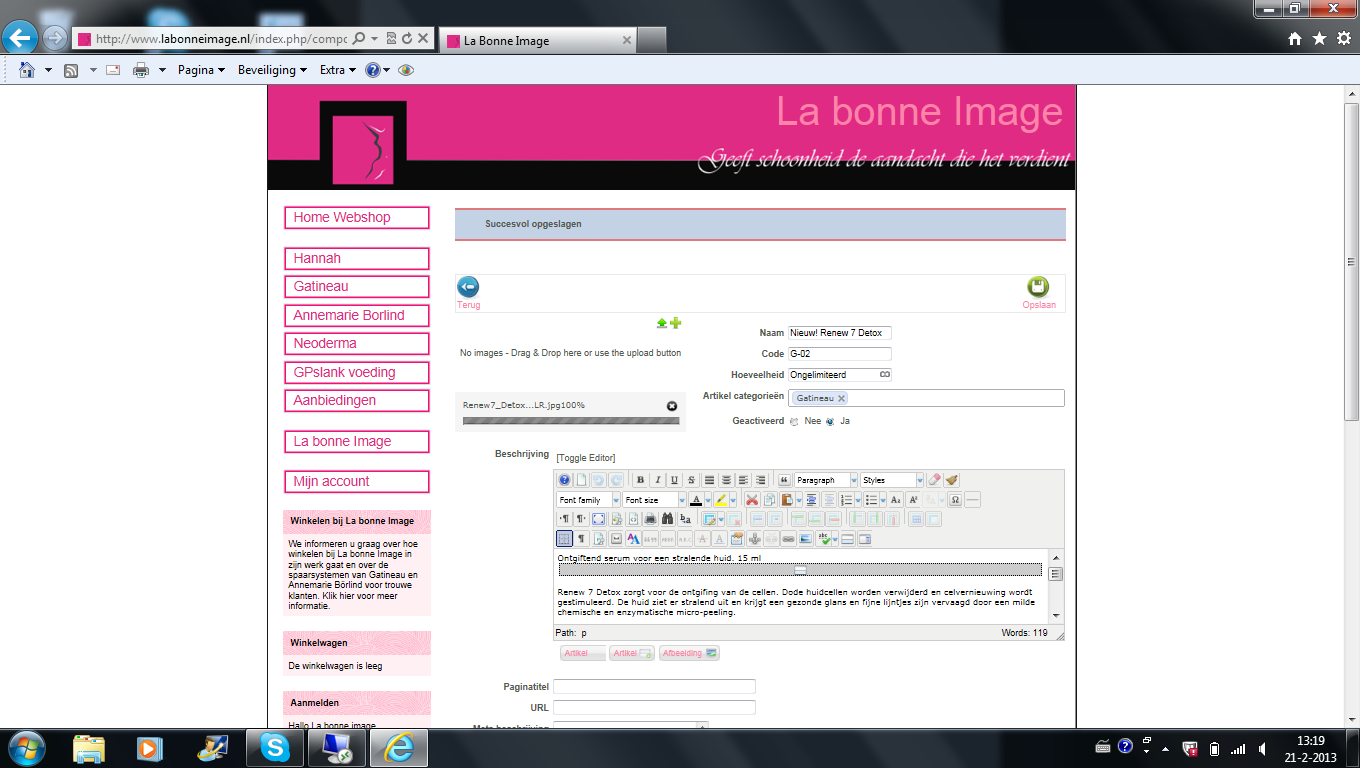

Hello again,
I have a question concerning uploading photo's in the frontend using Hikamarket.
My customer has problems to upload photo's. When doing this the screen 'hangs' and the photo is not uploaded (see attachment).
When I try to do this I have no issue. I have tried on 4 different PC's with the same customer userid.
Have you seen this issue before?
Do you have an idea what the issue could be?
Thanks a lot!
Hugo

13 years 8 months ago #91827
by Jerome
Replied by Jerome on topic Upload photo's in Hikamarket
Would it be possible to have an access to the website in order to test it ?
With some browser trace, it would be possible to see the ajax return content.
It is possible that some data broke the JSON content.
Do you have some PHP debug traces activated in the website ?
Does the HikaShop upload folder have right write accesses ?
I see the problem once when I had the PHP debug trace activated and I got a PHP notice. But I fixed the notice so it should not happen (but it's possible that you have another notice).
That's why, using some development tools in order to see the HTML requests content would help me to understand the problem.

13 years 8 months ago #91832
by hugojacobs
Replied by hugojacobs on topic Upload photo's in Hikamarket
Hi Jerome,
Yes, I can give you access. Where can I send it to?
I don't have debug traces activated.
Problem is that I can not reproduce the issue. This only happens with my customer.
On my PC I can upload issue without any issue.
Thank you
Hugo
Thank you
Hugo
13 years 8 months ago #91851
by Jerome
Did you test with Internet Explorer too ?

13 years 8 months ago #91922
by hugojacobs
This could be an IE issue indeed. When I tried on my PC it did not work with IE, but it worked with Firefox.
Hugo
Hugo
13 years 8 months ago #91939
by Jerome
I made a test with IE on the demo website and I can't reproduce the problem.
Would it be possible to have an access to the website in order to make some tests with IE, try to reproduce the problem and fix it ? (you can send me it by private message).
In IE, you have some development tools too (shortchut is: F12). You can check the console in order to see the javascript error, you can read the network data, etc.
Which version of Internet Explorer do you use ?

13 years 8 months ago #91963
by hugojacobs
Hi Jerome,
I have sent you the login details via a private message.
The issue occurs in IE v8 and v9.
Hugo
Hugo
13 years 8 months ago #92050
by Jerome
Thanks for the accesses.
I have reproduce the problem with IE 8 and 9. It is a problem with the javascript library which is used by HikaMarket.
After several hours of tests, I don't understand why the upload works with IE8&9 on the library demo website and why it does not work in HikaMarket and other minimalist implementations.
So I have put the upload fallback for Internet Explorer < 10.
