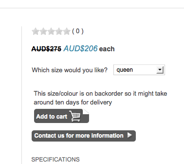

I really needed this function and I have no idea how to code, I found a simple solution that I wanted to share just in case anybody else was in the same situation.
First, I added 1000 to my all of my inventory. this way, if it says 1023, I know I have 23 available.
Second, I found this line, I had no idea what I was doing but it worked, I added "-1000" after product quantity. This way my front end displays the product inventory -1000, which is the real inventory.
class="hikashop_product_stock_count">'.JText::sprintf('X_ITEMS_IN_STOCK',$this->row->product_quantity-1000).'</span><br/>';
In the following link it explains how to add some code to notify the customers if there is less than a certain quantity.
www.hikashop.com/en/forum/search.html?q=...antity&childforums=1
Here is the code after I changed it.
if($this->row->product_quantity<1001)
echo '<span class="hikashop_product_stock_count">'.JText::_('This size/colour is on backorder so it might take around ten days for delivery').'</span><br/>';
I added the <1001 here, and my backorder message. This way as soon as the item reaches 0, it informs the customer of a longer waiting time, this is where my plan takes effect. Customers can order with the knowledge that it will take a bit longer due to the item not being in stock.
The only negative effect I can see here is that my inventory has plus 1000 products, But this doesn't bother me at all.

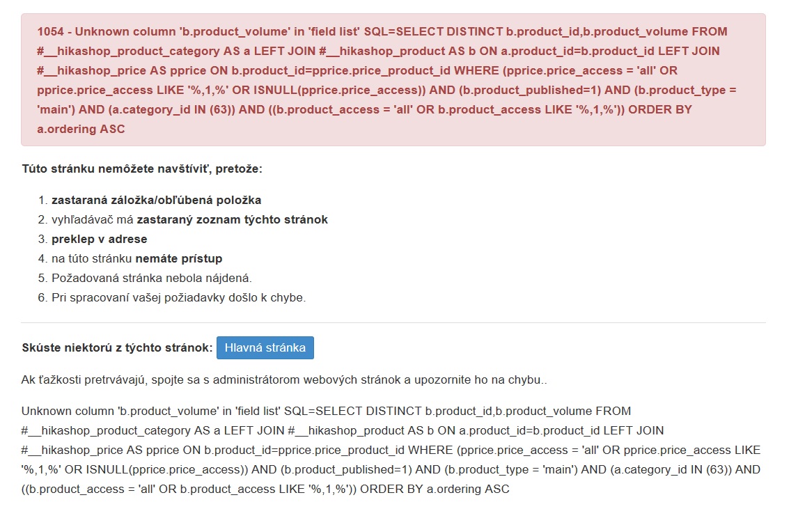

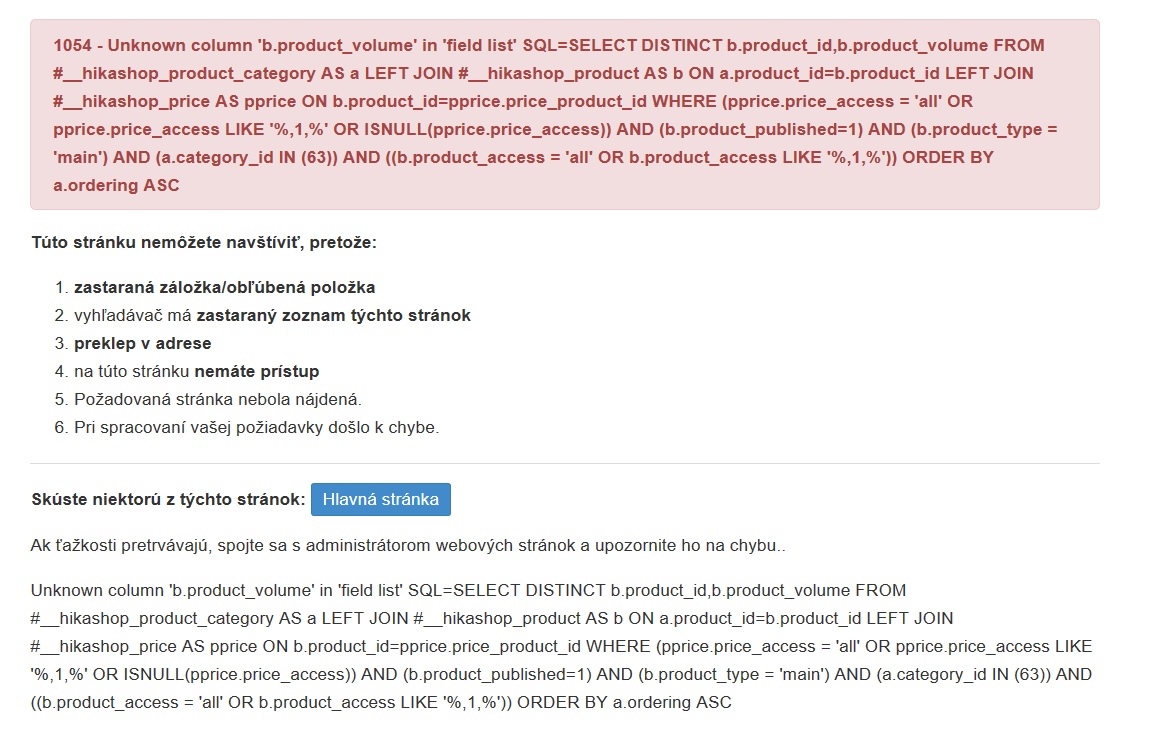

9 years 8 months ago #259560
thank you for your effort, but when I use it, I get this error in frontend.
Error is still there also when I use the originial piece of code. I had to unpublish the filter and e-shop works again.
Any ideas why?

Try adding the code:
	function getFieldToLoad($filter, $divName, &$parent){
		return '';
after the line:
class hikashopInStockCheckboxClass extends hikashopFilterTypeClass{
in the file administrator/components/com_hikashop/classes/filter.php
That should fix the problem.

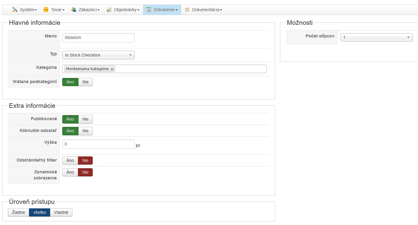

Then could you provide a screenshot of the settings of your filter and a link to the page where we can try it ?
  • Posts: 46
9 years 8 months ago #259671
Here is the filter setting.

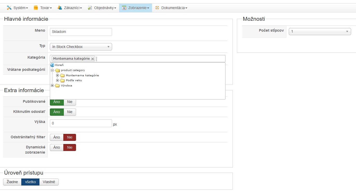

You can try the result here: montemama.eu/index.php/eshop
I tried to select"product category" in fileld Categories.
but, I got this error in frontend when I used the filter

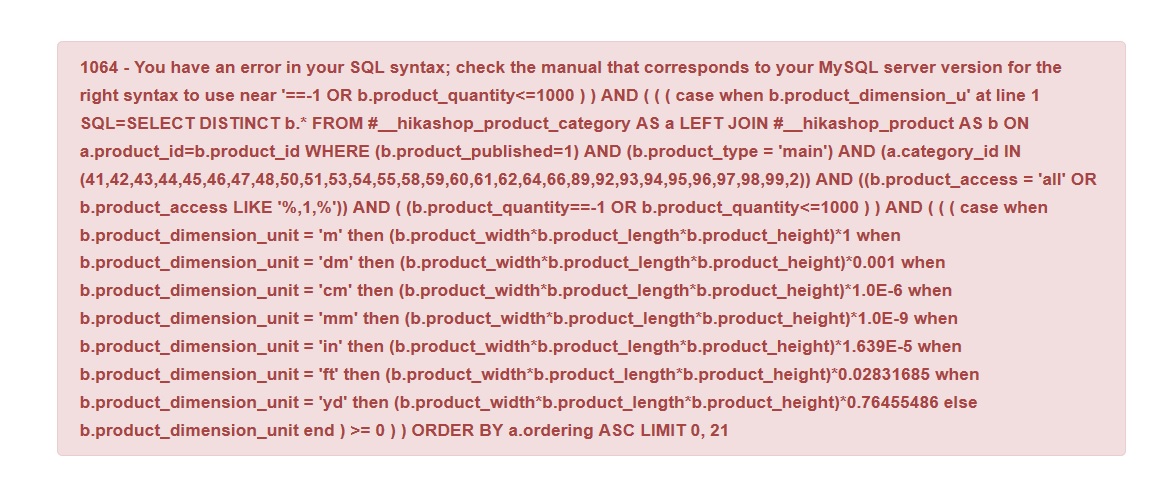

  • Posts: 46
9 years 7 months ago #260361
there is no error, but the filter doesn´t work. I get a list of all products, but not only those which are on stock, but completely all.

Ok. Then try with this line of code instead:
$filters[]=' (b.product_quantity=-1 OR  b.product_quantity>=1000 ) ';
