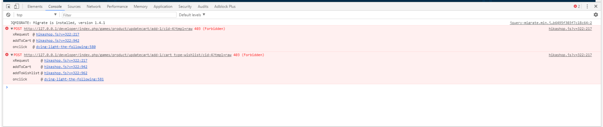

But here comes the problem, the first variant is working normally but the second does not allow me to add either the cart or to wishlist.
Error
POST http://127.0.0.1/developer/index.php/games/product/updatecart/add-1/cart_type-wishlist/cid-4?tmpl=raw 403 (Forbidden)
xRequest @ hikashop.js?v=322:217
addToCart @ hikashop.js?v=322:942
addToWishlist @ hikashop.js?v=322:962
onclick @ dying-light-the-following:317

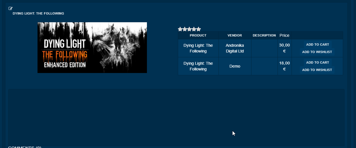

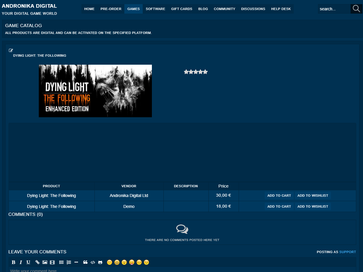

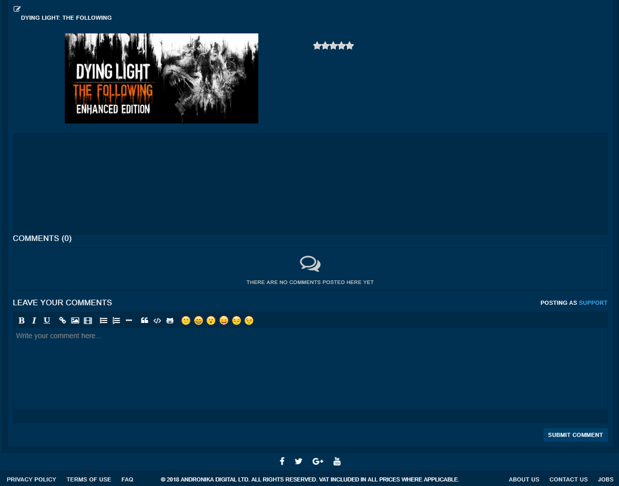

8 years 9 months ago - 8 years 9 months ago #285402 by neo191987
Hi thanks for responding to my problem. Now I will describe all the steps.
1.There is the position of the table before all changes
2. This is the code before editing it (show.php)
3. After editing
4. Result
5. This is the code before editing it (show_tabular.php)
6. After editing
7. Result, I now have to design and remove the fields I do not want to see in the table
8. The error of adding the second variant to the cart and wishlist
Last edit: 8 years 9 months ago by neo191987.

8 years 9 months ago #285405 by nicolas
The problem of doing that change is that now you have one form around each add to cart button and one form around the whole product page.
And you can't have a form in a form in HTML, that's not valid and it creates that issue.
You have two solutions:
- You edit the file "show" of the view "product" and you remove the main form of the product page.
- You remove the form around each add to cart in the "show_block_characteristic" view file.

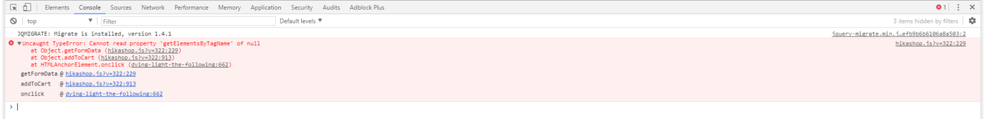

8 years 9 months ago - 8 years 8 months ago #285450 by neo191987
Hi, now it really works, but there is another problem. Adding a product to cart or a wishlist no longer shows popup for that the product has been added and directly redirects to an order or wishlist, I also get one error.
The steps that I made
1. I removed this code from show.php (row 58) - Incorrect. Fix: Move to show_tabular.php, above characteristics code (row 116)
Code:
<form action="<?php echo hikashop_completeLink('product&task=updatecart'); ?>" method="post" name="hikashop_product_form" onsubmit="return hikashop_product_form_check();" enctype="multipart/form-data">
2, Whether I add the product to the cart or wish list I get this error
Is there a way to fix this or if I'm wrong what exactly do I have to do?
Last edit: 8 years 8 months ago by neo191987. Reason: Fix
More
8 years 8 months ago #285455 by nicolas
That's normal as HikaShop is normally expecting that this form element is present on the page.
Instead of removing it, place it just before the </form> tag in that same file.

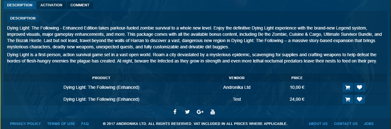

8 years 8 months ago - 8 years 8 months ago #285611 by neo191987
It took me 5 minutes to do it right. You gave me good guidelines for which I am grateful to you. :)
