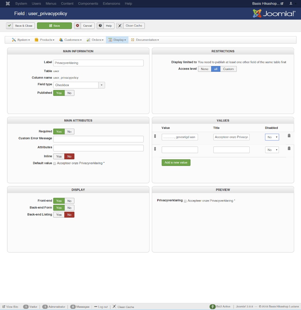

8 years 5 months ago #293601
by nicolas
Replied by nicolas on topic GDPR - Consent to use personal information
The value of the checkbox there should be the same as what the user did.
Please provide a screenshot of the settings of your custom field.
Regarding the 3.9, we'll see how we can integrate with it. There might be something else than a custom checkbox field but it's too early to say.

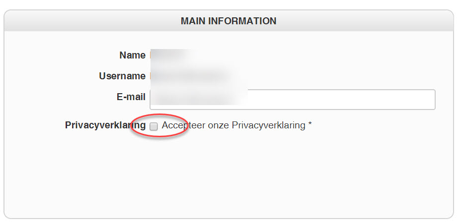

Replied by Lumiga on topic GDPR - Consent to use personal information
See here my screenshot.
And where can I see the value from the checkbox after someone has accept it.
I can't find it in the customers menu?
Kind regards,
Lumiga
Kind regards,
Lumiga

8 years 5 months ago #293671
by nicolas
I've created a similar custom user field on my end and it works fine with the 3.4.0.
During registration, I see the checkbox and I have to check it, and when I check the user information via the Customers menu, the checkbox is checked corresponding to the fact that the customer checkec the checkbox:
monosnap.com/file/EdmKwMoSc5fqLTi4fkEaTB4RyZbWCr
monosnap.com/file/LdwnIFKyThYxrZzFmQmHq8RsQEKhql
