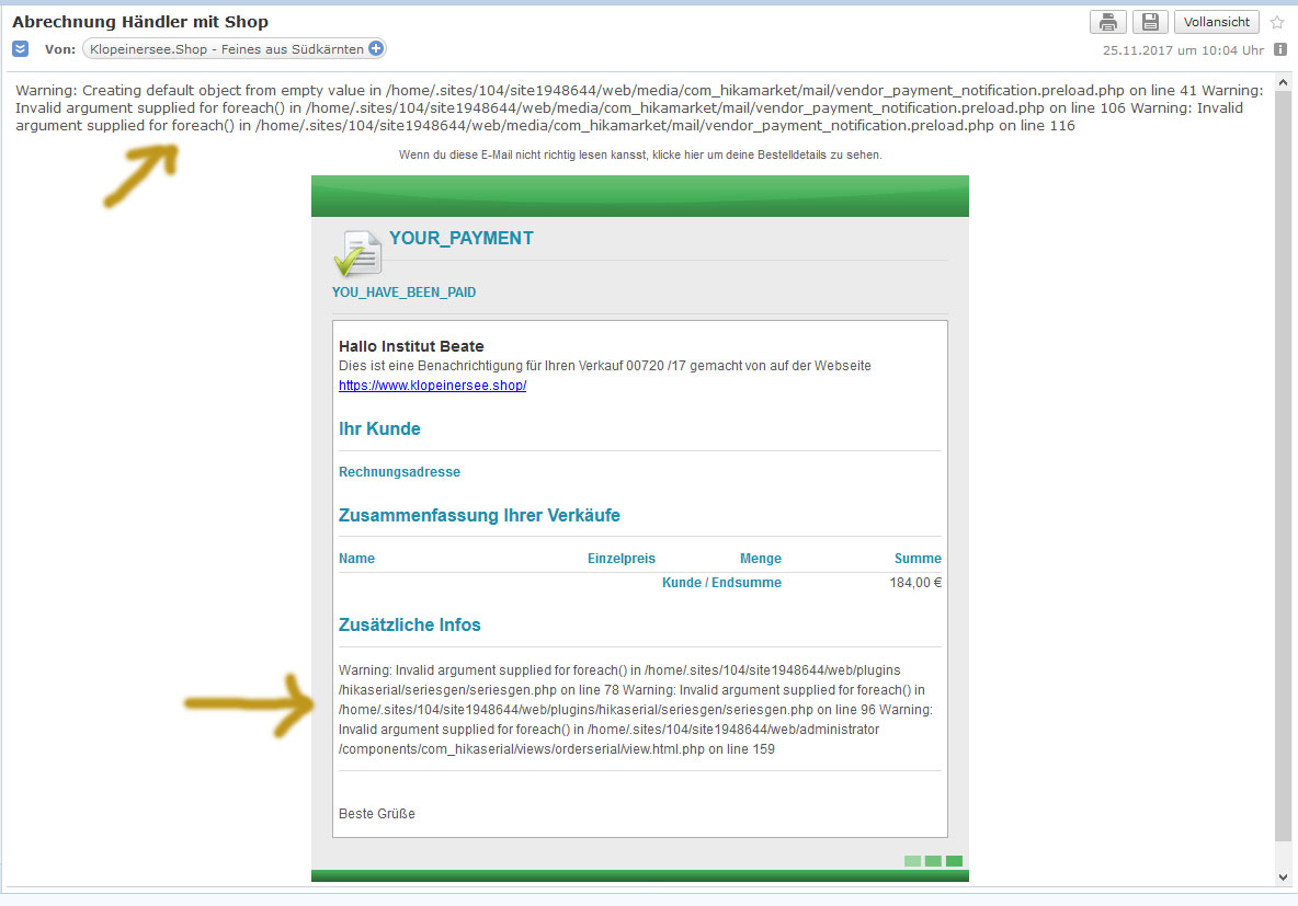

8 years 11 months ago - 8 years 11 months ago #283130
by woidl
Replied by woidl on topic Problem with "Pay" the Vendors
Installation
installing 2.0.0 did not work without error - error message of Joomla:
WARNING: Duplicate entry '1-1-Vendors-*' for key 'idx_client_id_parent_id_alias_language'
Then I did it again and it worked, no error message anymore.
Did the installation a third time:
Using Pay function
I can do the "Pay", send an "You have been paid" Email with the correct amount to the correct vendor. So far so good.
But the email has errors, one in the head of the mail one in the content.
Please see screenshot
thanks for help

Code:
Warning: Creating default object from empty value in /media/com_hikamarket/mail/vendor_payment_notification.preload.php on line 41 Warning: Invalid argument supplied for foreach() in media/com_hikamarket/mail/vendor_payment_notification.preload.php on line 106 Warning: Invalid argument supplied for foreach() in media/com_hikamarket/mail/vendor_payment_notification.preload.php on line 116

8 years 11 months ago #283146
by Jerome
Replied by Jerome on topic Problem with "Pay" the Vendors
The error regarding the duplicate entry is not related to HikaMarket directly (Because I do not have any mention of "idx" in HikaMarket.) but it might be related to the Joomla installation system ; and I think it's regarding the menus (which should be added via the install XML).
I'll have a look and try to reproduce it in a local website.
Regarding the vendor pay ; please re-download HikaMarket 2.0.0 in order to get a patch to improve the data in the object passed in the function which generate the email.
