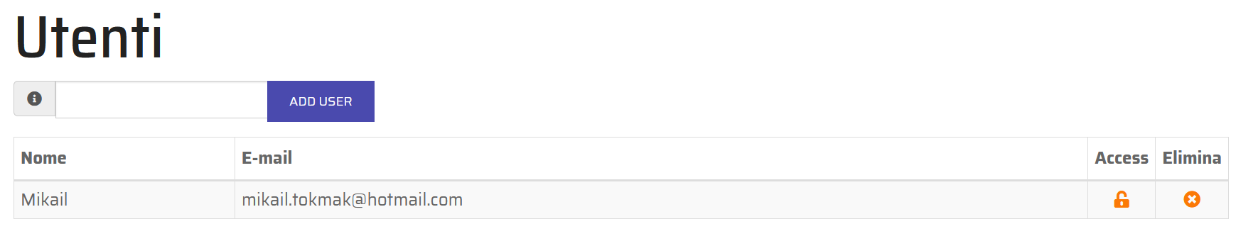

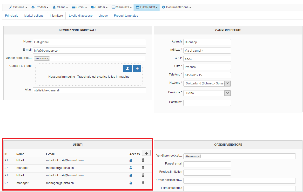

I try to modify a vendor with another account vendor from the frontend. But if I Save the modify, after I lose the permssions for manage this vendor. Maybe is because in the bottom the current user "manager" doesn`t appear in the users list (you can see in the attachmnet) and maybe after I confirm to save I confirm to save without this user, but in the backend is set (as you can see in the attachment).

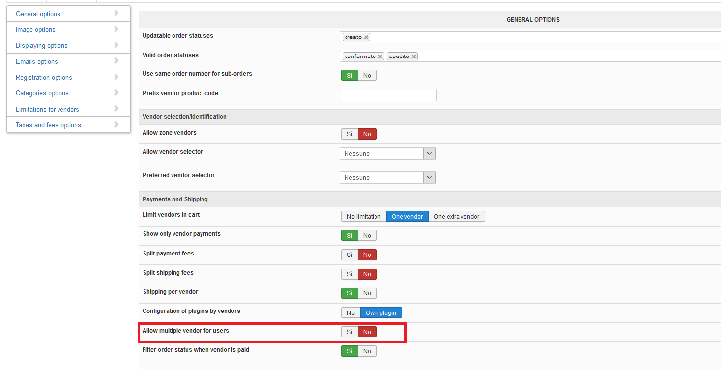

If you want to avoid the issue for the moment, the best is to deactivate the "Allow multiple vendor for users" setting.

  • Posts: 85
  • Thank you received: 9
6 years 3 months ago #320493
Ok, but in this way is not possible to let to manage someone all the vendors

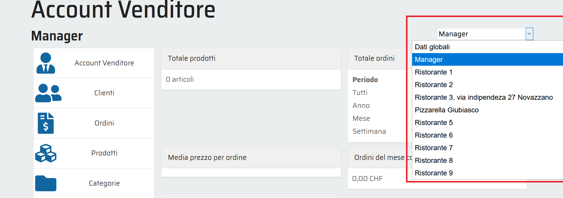

6 years 3 months ago #320533
I added the accounts related to the main vendor (as you can see in the screenshot marked in red), but if after I deactivate the "Allow multiple vendor for users" setting I can`t see the list of the vendors in the cPanel in the frontend for manage and see the statistics of the vendors.
Let me know if I proceeded in the right way.
My best regards

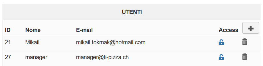

I just upload a new version of HikaMarket 3.1.0 with an hot-patch regarding your issue.

6 years 3 months ago #320788
thank you very much for the update
Now it works :)
