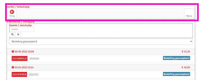

Otherwise, using a view override, you can retrieve the current URL of the page and change the toolbar content depending that.
You have HikaShop helpers to get the URL or read the Joomla parameters ("ctrl", "task", etc)

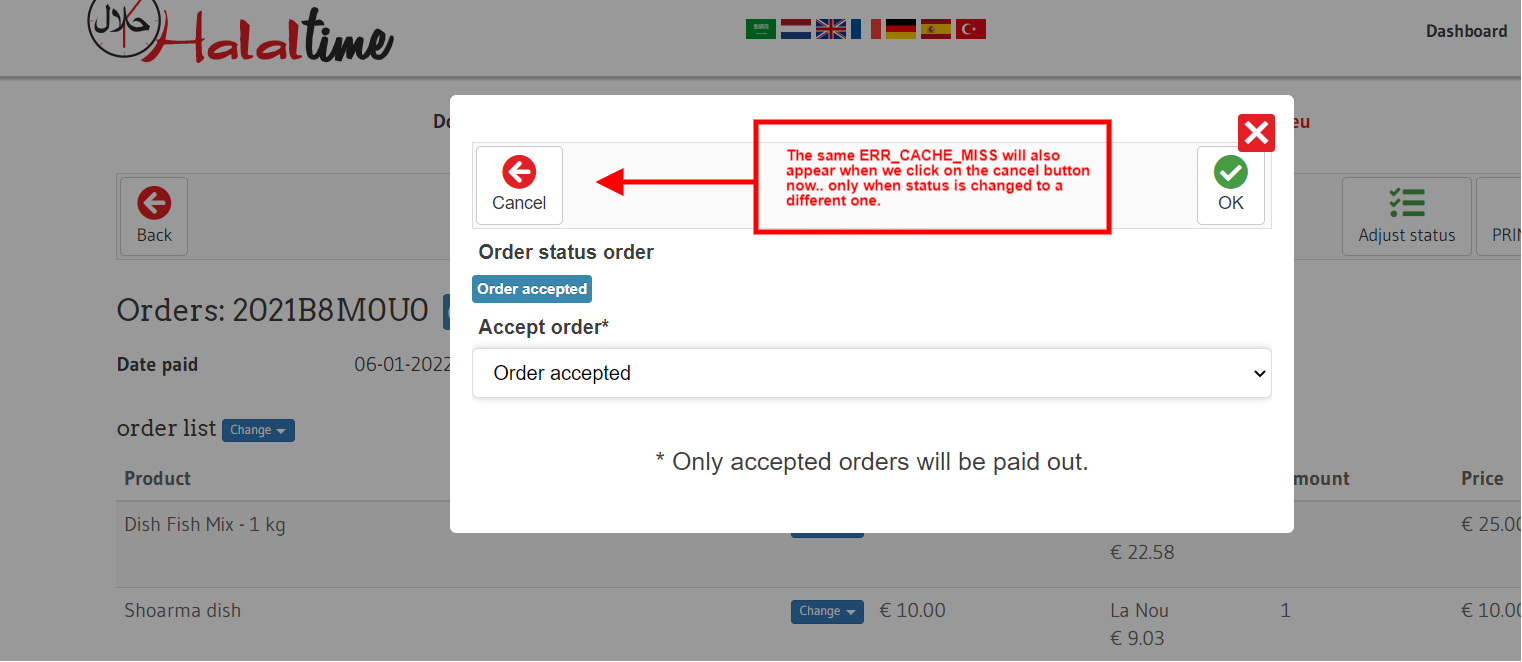

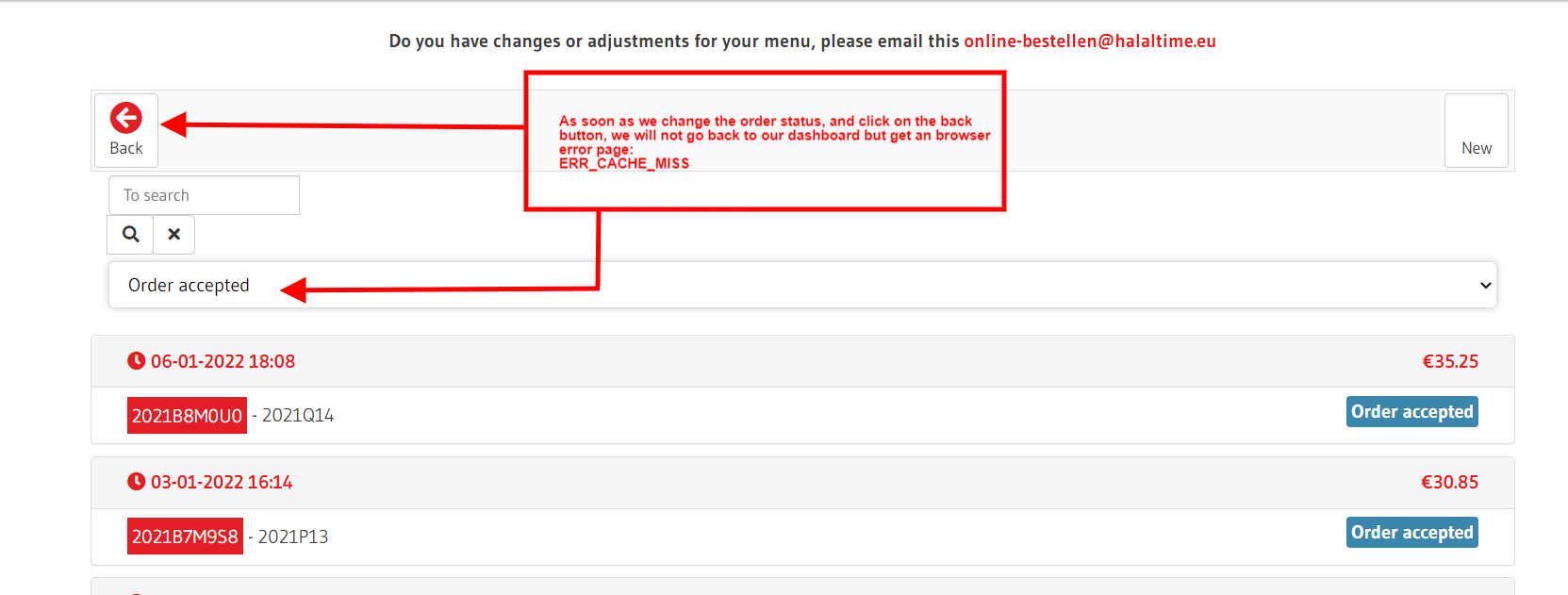

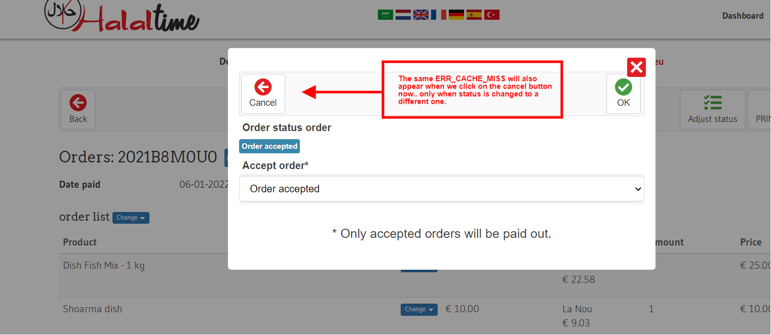

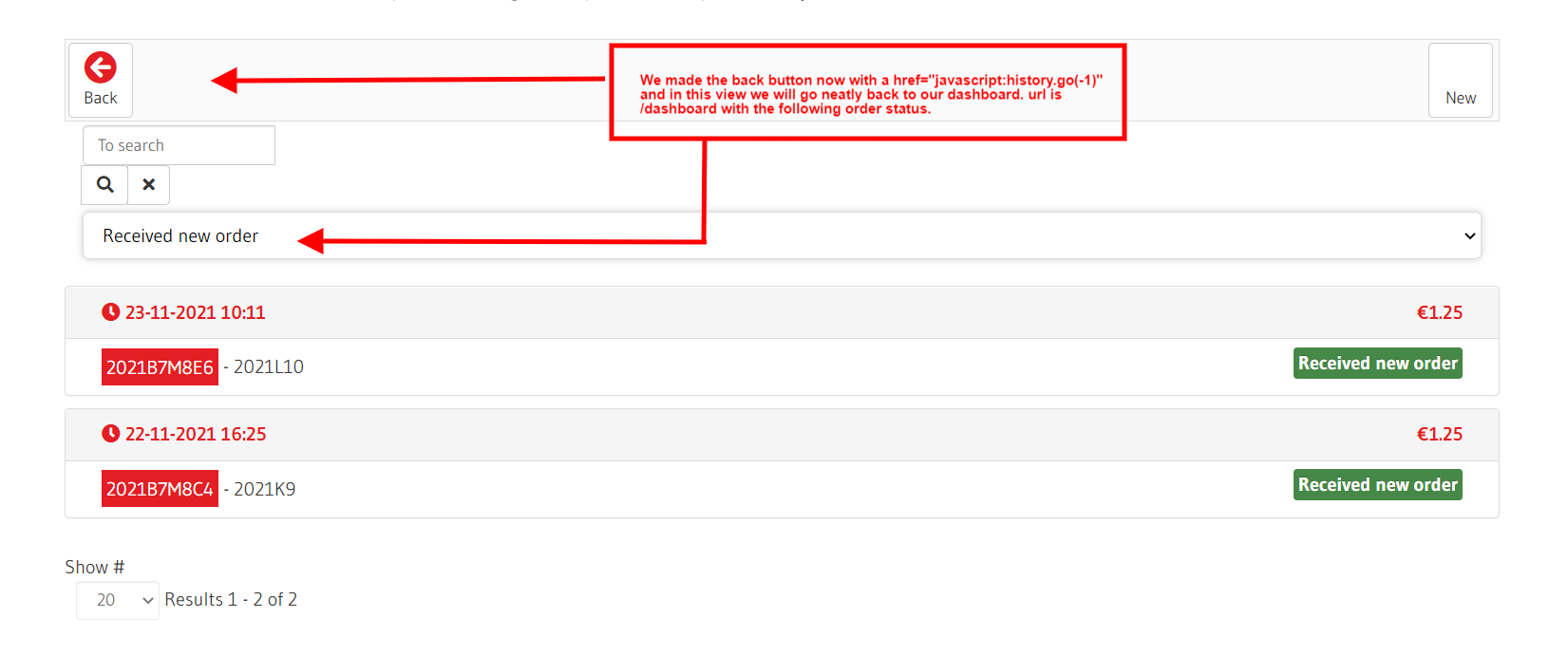

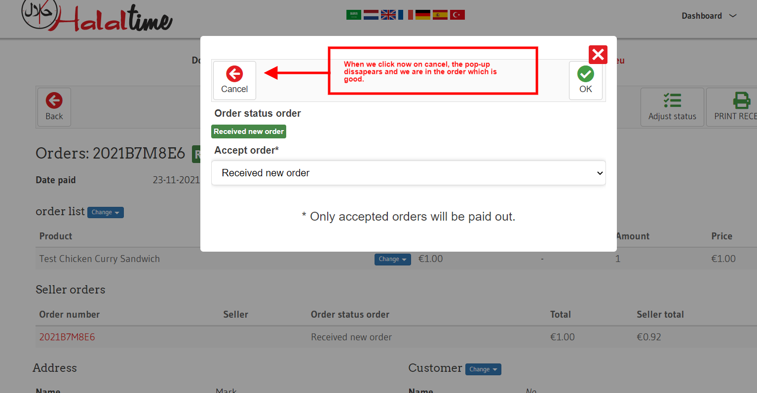

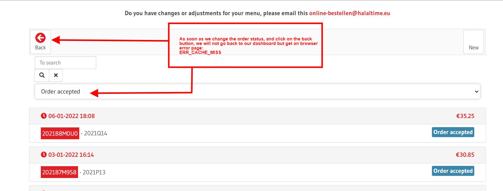

To explain it a bit more, i made some screenshots for you..
As long as we stay on this order status it is fine but when...
Then we get the error and we can not go back to our dashboard. Hope you can help.
If we use the original code we then go back to the hikamarket vendor dashboard but we do not want that..
Really hope you can help.

Your "ERR_CACHE_MISS" seems to be an issue with a cache component/plugin you have in your website.
Regarding the modification of the toolbar content ; my previous message contains two solutions to perform such modification.
