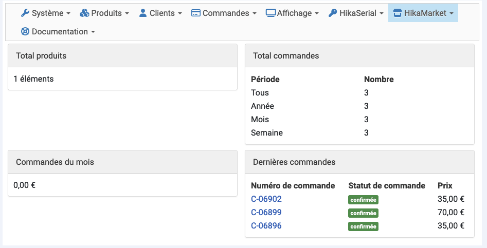

5. I select vendor1 and click on the "Rapports" button: I see the right number of orders with the right amount due for each order but not the resulting amount (see attachment1)

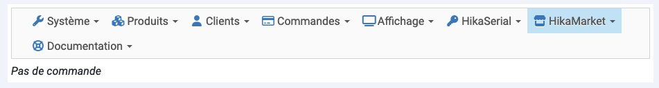

6. If I go back to HikaMarket > Vendeurs and I click on the "Payer" button: The result is "Pas de commande" (see attachment2)
What's the issue?

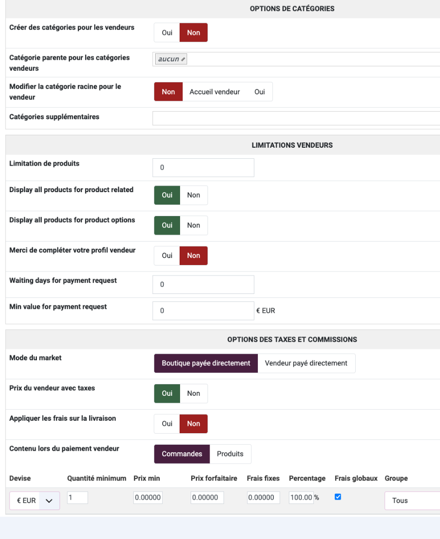

  • Posts: 74
  • Thank you received: 7
1 year 7 months ago #365213
Thanks for your answer.
I was aware of this part of the documentation, especially this :
HikaMarket will start to look at the fee configuration in the product itself, then in the vendor and finally in the global configuration.
There is nothing set, regarding the fees, in the products or the vendors. So all is in the global config.
But maybe I've misunderstood something?
Here my the market tab in attachment.
For the fee part I've tried "commandes" et "produits" with the same result
Last edit: 1 year 7 months ago by marcmarc.
1 year 7 months ago #365217
A 100% on Global fee means that your store will earn 100% of the price.
  • Posts: 74
1 year 7 months ago #365229
ok but what should be the right settings?
0% doesn't work
I have tried every possible combination that makes sense and it is the same result: orders are successfully assigned to the correct vendors but the amount due is still 0
1 year 7 months ago #365242
"0%" is the right configuration for your need.
Afterwards, I don't know what test you're performing ; so it's difficult for me to tell you what is wrong.
Please change the setting, perform a new test order and provide the details of the HikaShop order in the backend.
With the order product listing and other HikaShop order related stuff, HikaMarket also adds its content and we can see how the vendor total is processed.
