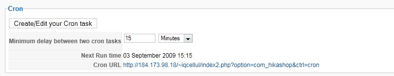

Replied by nicolas on topic Re: Cron is gone!no emails! it was working fine before
You don't have the index2.php file. Did you deleted it ?
You can edit the cron and change the index2.php in the url to index.php and it will work.

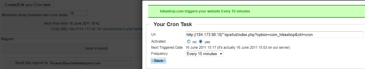

15 years 5 months ago #19040
by Rickhavoc
Replied by Rickhavoc on topic Re: Cron is gone!no emails! it was working fine before
15 years 5 months ago #19041
by nicolas
It should work now.

on the past screenshot i was trying to point out that the corn url still had index2.php even tho i edited the cron job.

Yes I understood. It's just a display issue so don't worry of the index2.php there.

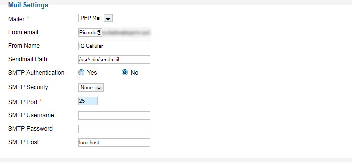

if it helps to know, i just moved the site yesterday to a new server, i used akkeba back to move it with kickstart.

Probably because your new server does not handle emails like your previous one... I'm almost sure that the registration emails of joomla do not get sent either on your website.
Maybe your new server requires you to use a SMTP connection to send the emails ? You should ask your hosting company about that problem.
