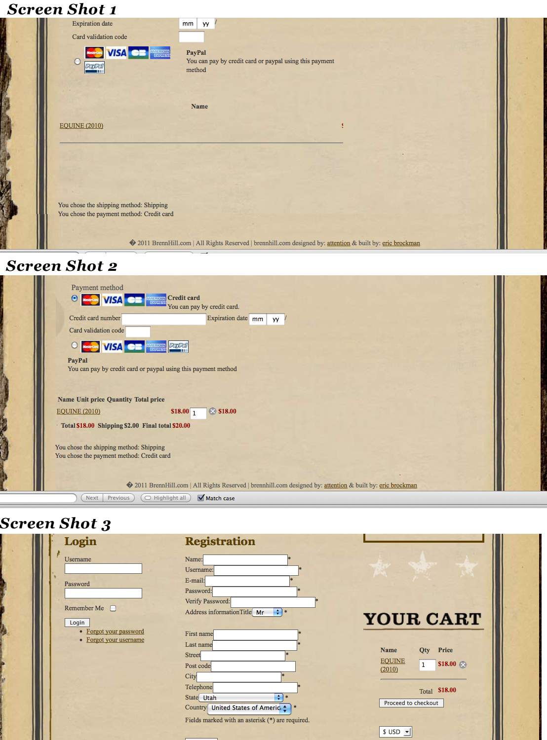

15 years 9 months ago #8391
by ericbrockman
Replied by ericbrockman on topic Re: Check Out Area Is Running Out of Defined Area
Okay sure, if I add items to the cart and then proceed to the checkout for area, the spacing for the cart at the bottom is all screwy - screen shot 1
If I left justify those items, the spacing is still screwy, but you can at least see everything - screen shot 2
But if I left justify those items, it screws up the whole right side of the form - screen shot 3.
Hope that helps.
Hope that helps.
15 years 9 months ago #8407
by nicolas
Replied by nicolas on topic Re: Check Out Area Is Running Out of Defined Area
Please try that CSS:
#hikashop_checkout_cart p{ width: 380px !important; }
- ericbrockman
Topic Author
- Offline
Less
More
- Posts: 8
- Thank you received: 0
15 years 9 months ago #8417
by ericbrockman
Beautiful, thanks so much for helping out a new comer to the world of programming.
I'll be sure to leave a 5 star rating and comment on how great the component and support is for this extension in the JED.
Great work.
