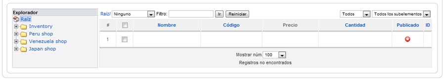

As a result, now all those testing products has dissappeared from searching results, but now i got an empty product in my backend with a curious behaviour: i can´t delete it and if i try to edit it, a new product is created with those new settings and this blank products remains.

image missing http://www.hikashop.com/media/kunena/attachments/legacy/images/01-20101112.jpg
15 years 11 months ago #1577 by nicolas
It's easy to find the culprit. Select the product and click on the edit button. On the edit page of the ghost product, if you put your mouse over the title "Products" you should see in the URL displayed at the bottom of your browser the id of that product. Then, you just have to search for that id in the product table and remove it.

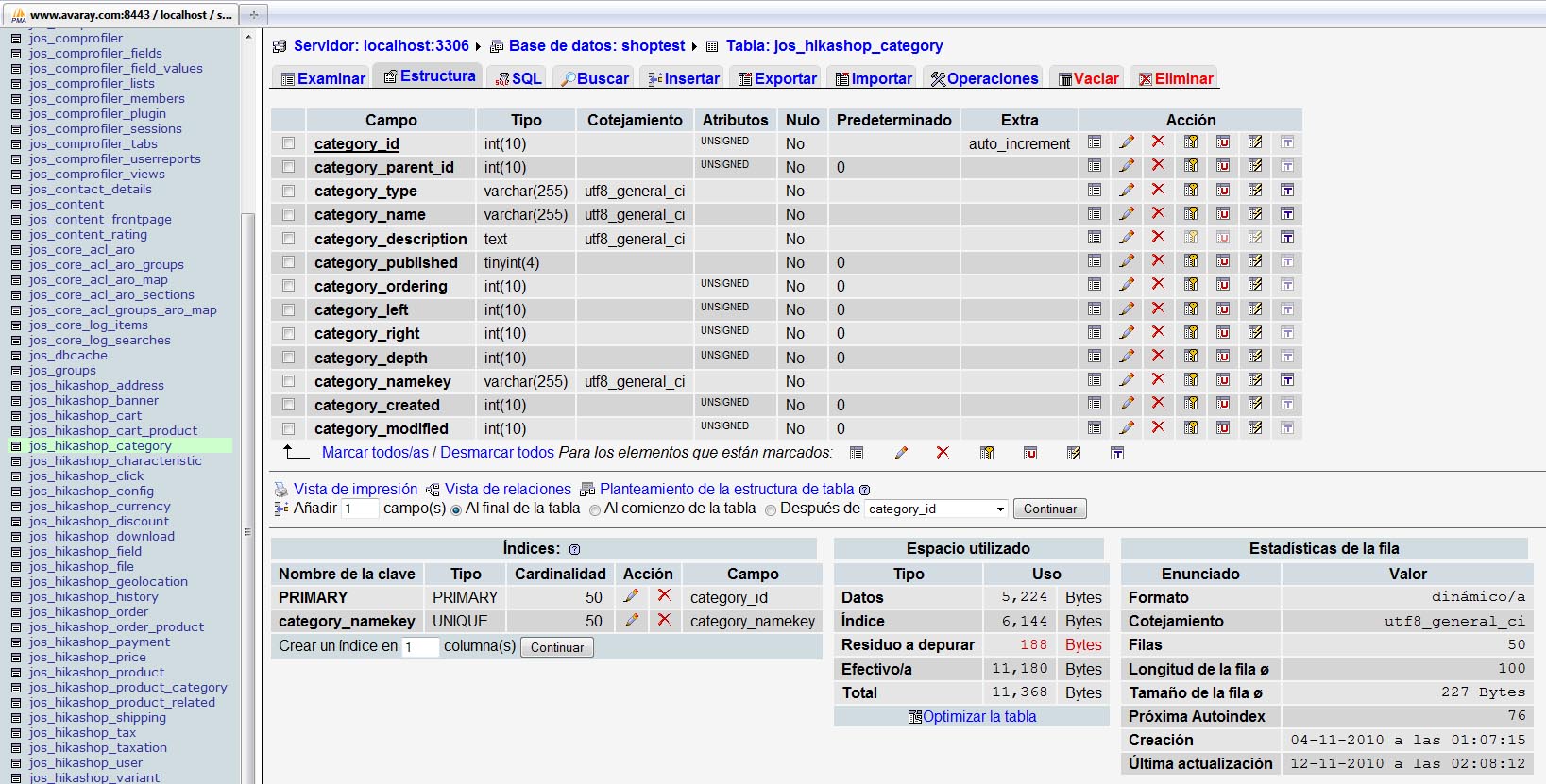

Sorry, but there is nothing related to products in "hikashop_category".
The only two options related to id are "category_id" and "category_parent_id".
The only one with an entry marked with id=0 it´s "category_parent_id".
image missing http://www.hikashop.com/media/kunena/attachments/legacy/images/02-20101112.jpg
