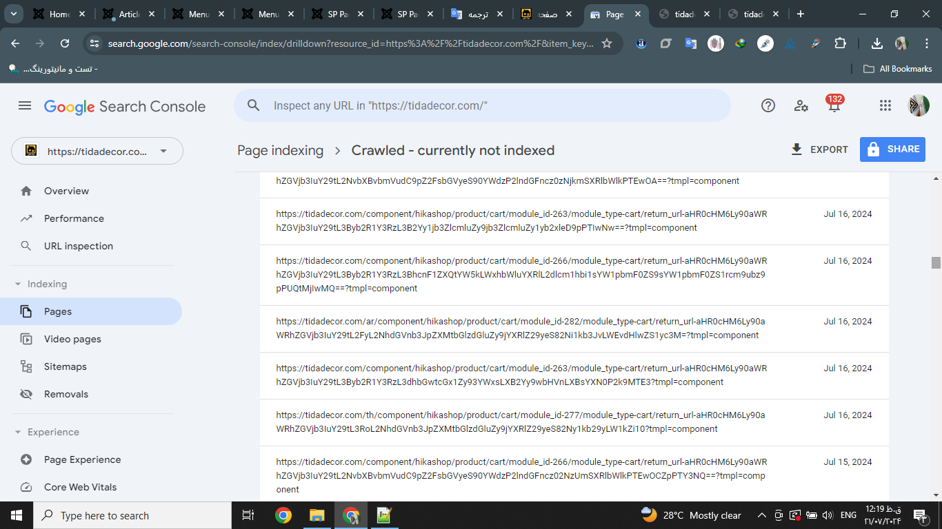

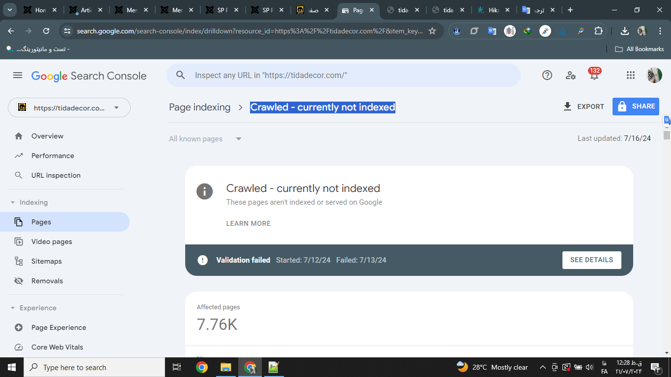

I have encountered a serious error related to HikaShop in Google console
I have a 7.76K error page from HikaShop in the following section
google search consol : "Crawled - currently not indexed"
link problem :
tidadecor.com/component/hikashop/product...ZGYtYXJ0YT9pPTA0OQ==
I don't know what these links are about?
These links have caused my other pages not to be indexed in Google
Please save me from these malicious links
These links are malicious with CSS codes

What you want to do is to configure your robots.txt to exclude the component/hikashop/product/cart/ and the en/component/hikashop/product/cart/ folders from being indexed.
webmasters.stackexchange.com/questions/1...tory-with-robots-txt

These URLs are used to refresh the cart module.
They are in the middle of the javascript code so we can't put an attribute to a HTML tag to tell search engines to not index them.
However, we'll look at doing something for that.
