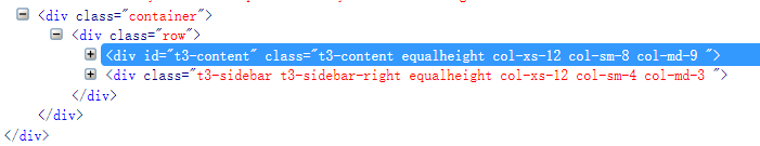

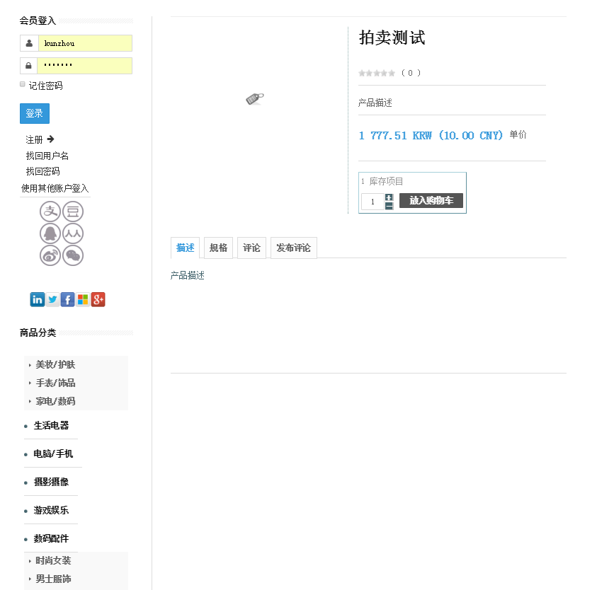

When the auction disabled, the product page displayed normally as shown below
the sidebar is close to the mainbody

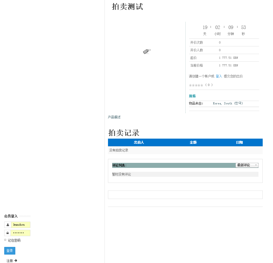

however if the auction enabled, the product pagewill be like this:
the sidebar runs far away
you can use these two pages to compare the difference

and then the auction enabled, it turns to

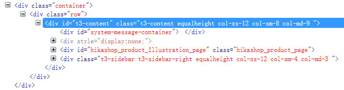

Can you :
- Go to the page "Hikashop->Display->Views"
- Edit the file "Show_auction" of the "productauction" view of your front-end template
- Change that line :
By :
And test it again ?
Thanks.

10 years 9 months ago #224301
by likunzhou
Replied by likunzhou on topic the layout of the product page gets strange
Yes, great, it works!
Thank you~
