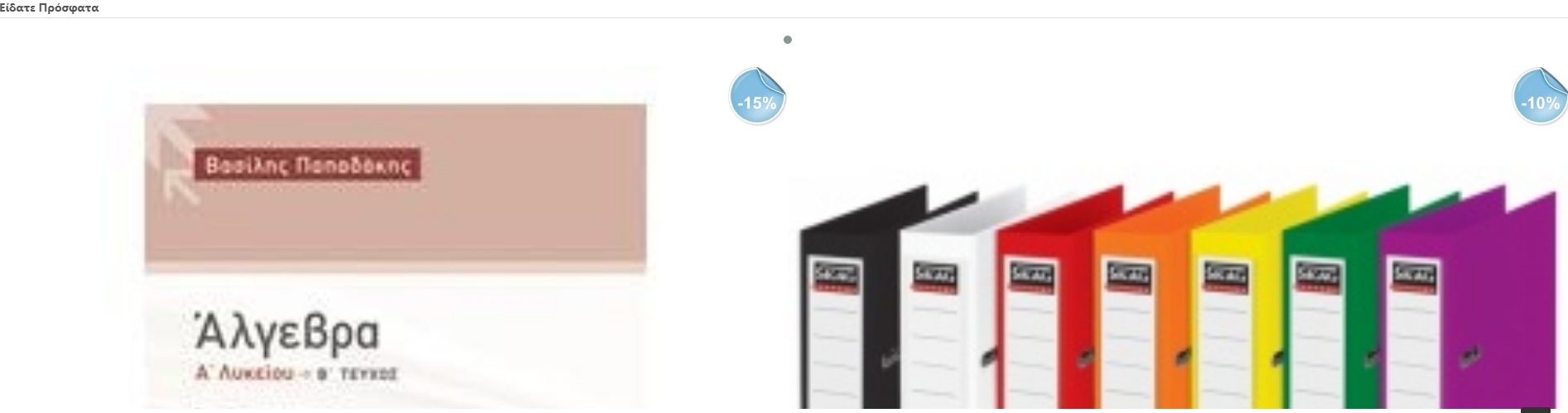

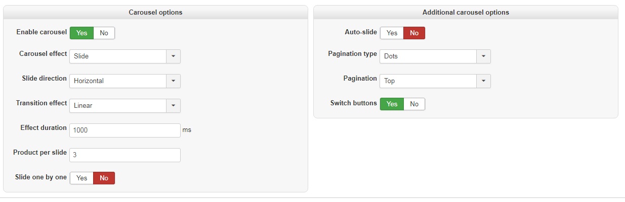

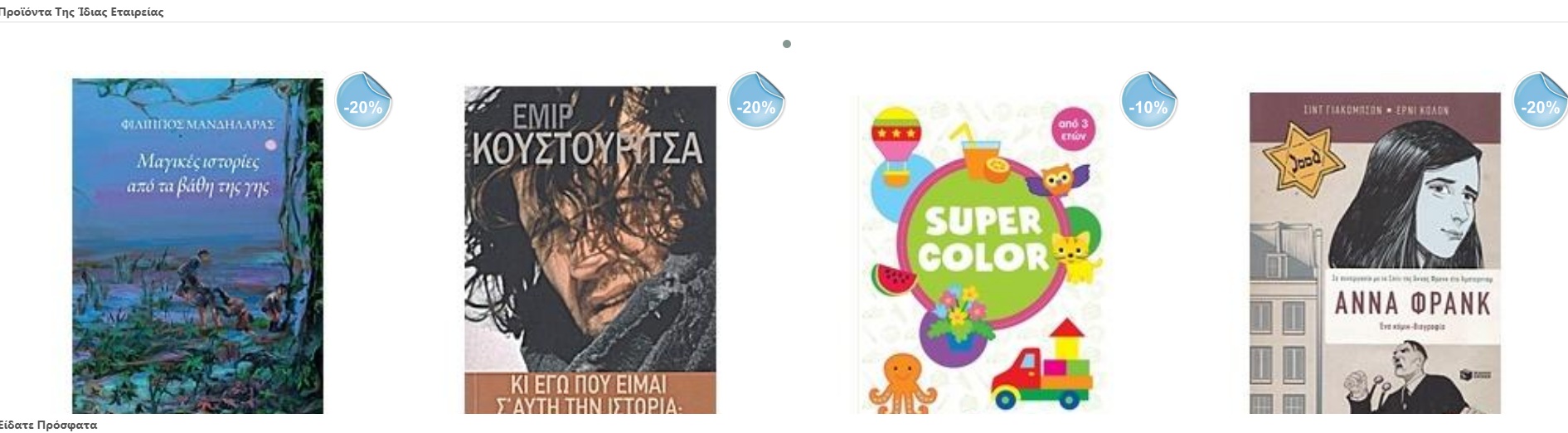

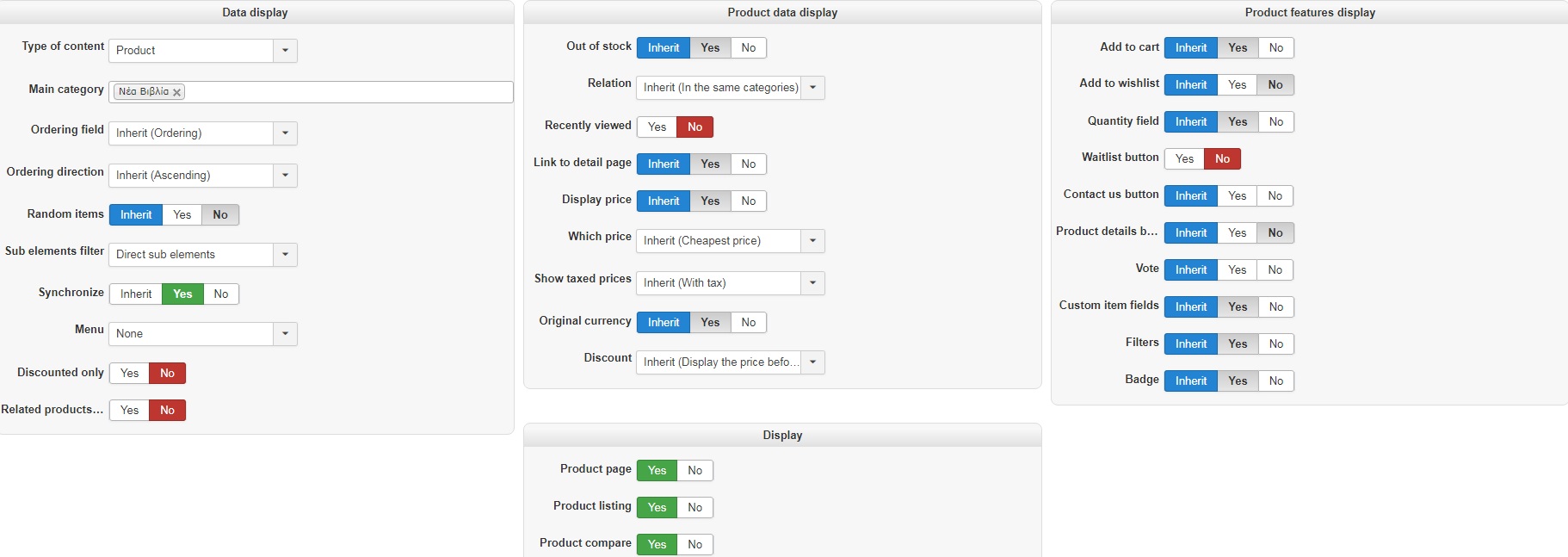

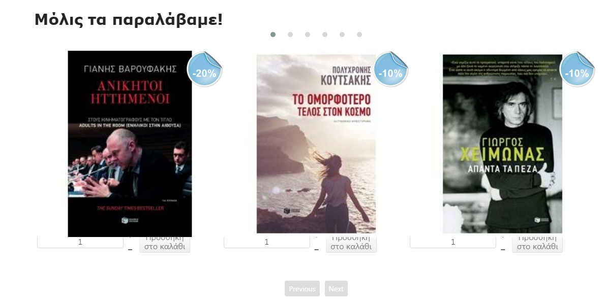

6 years 11 months ago #311557 by Giscard
Replied by Giscard on topic Carousel and MooTools
I tested to disable the carusel legacy, clear the cache without any compression.and the results are the same.
I have attached some photos with examples and the settings on the module that I am using.
Thank you in advance.

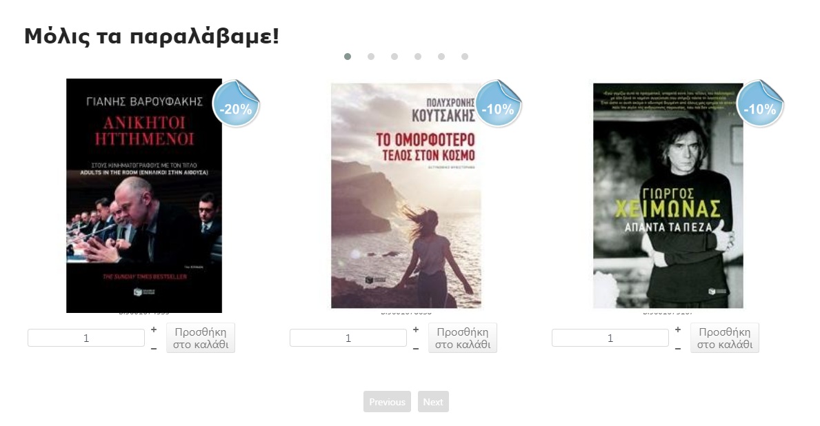

6 years 11 months ago #311686 by nicolas
Replied by nicolas on topic Carousel and MooTools
I've reviewed the situation on your link and the only issue I could find is that the "dot" pagination of the carousel system isn't consistent with the number of displayed elements on each page for mobile devices.
The rest seems to be working just fine.
So I'll assume that it's what you're talking about here.
I was able to reproduce the issue on my end and added a patch for it.
So download again the install package on our website and install it on yours and that issue will be fixed.

6 years 11 months ago - 6 years 11 months ago #311688 by Giscard
Sure, I will do that.
What about the diplayed thumbnails on the modules? They display wrong.
Thank you for your help.
Last edit: 6 years 11 months ago by Giscard.
More
6 years 11 months ago #311692 by nicolas
That's just a CSS issue.
You can fix that by adding such CSS on your website:
Code:
.owl-carousel .owl-item img { width: auto !important; }
More
6 years 11 months ago #311713 by Giscard
Goodmorning nicolas,
I added and now it is working (of course :) )
Thank you very much.
