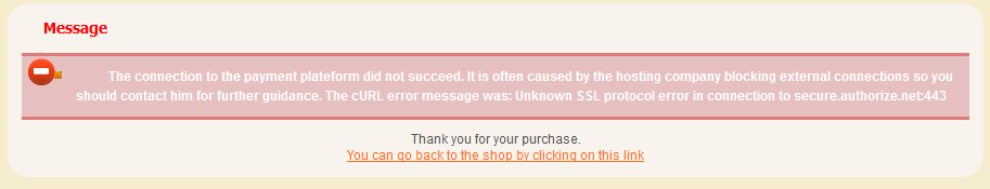

12 years 10 months ago #127658
This page pops up just after clicking the checkout and right before the final page. I have no idea where it's coming from or even how to remedy it. My guess is that it's breaking something so the after_end.php isn't displaying the info.
Thanks again!
12 years 10 months ago #127665
Did you read the error message displayed ?
  • Posts: 10
12 years 10 months ago #130219
We remedied the error that popped up on check out. Don't know if you want to create a separate resolved post just in case it happens to others. Evidently Authorize.net didn't like that our IP ended in .255 and that caused the error shown. Everything checks out now as far as processing the order.

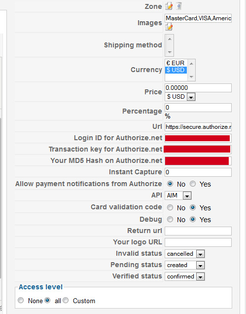

12 years 10 months ago #130550
In that case it means that the "order_id" is missing from $_SESSION. It is stored there by HikaShop when the order is created at the end of the checkout.
So you should definitely have access to it.
If you do:
$order_id = $app->getUserState('com_hikashop.order_id');
var_dump($order_id);
Do you get the id of the order displayed ? If yes, then you should definitely get the order data in $this->order since the after_end() function simply load the order in that attribute of $this for the order id stored in the session. If no, then maybe there is an issue with the session somehow.
By the way, how did you configure your payment method ? Could you do a screenshot (and remove the confidential data in it) ?
  • Posts: 10
12 years 10 months ago #130580
Bingo! That worked. Attached is the screenshot.
