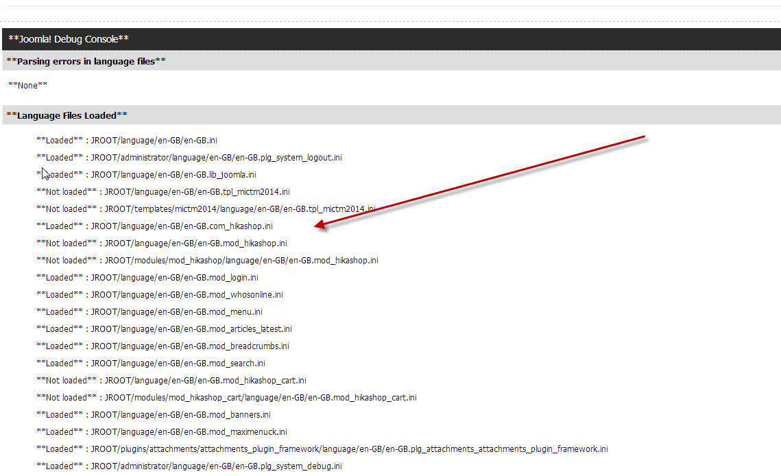

I need the email order confirmation to be changed to "Total with TAX". I have created a language override but it's not being loaded. ( see attached DEBUG language files ).
Any suggestions? See attached screen shot.

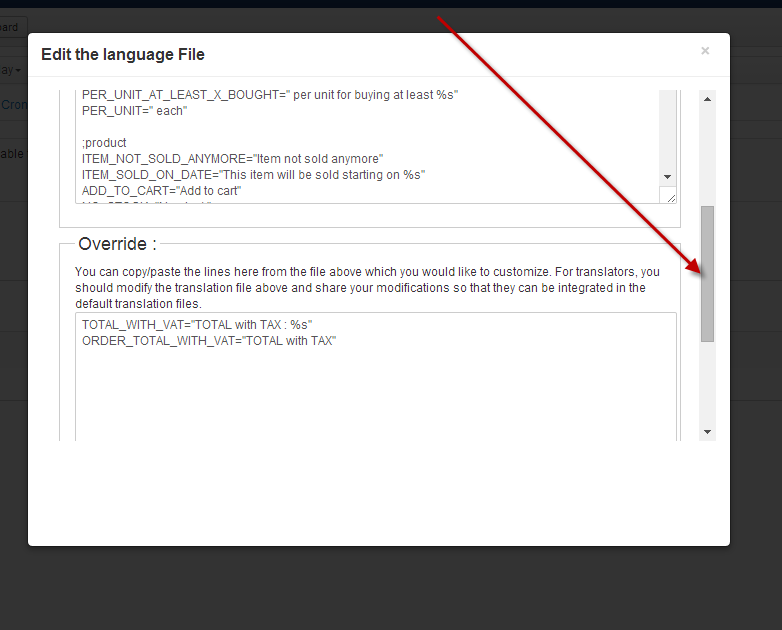

I used the Configuration->Language edit overide to fix this. Be sure to scroll down in the language edit popup. I am mentioning this only because it took me a few times looking at this to see the Overide screen and because I missed this, my regular language overide wouldn't work as you are describing. Maybe you've already done this, but just in case it helps I attached pictures here.

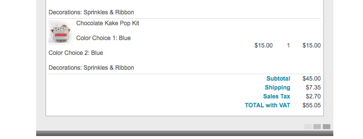

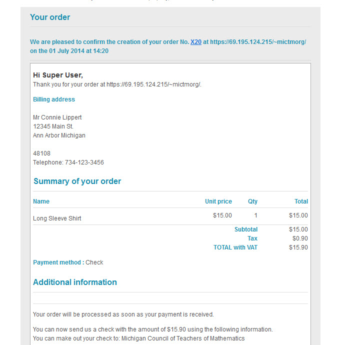

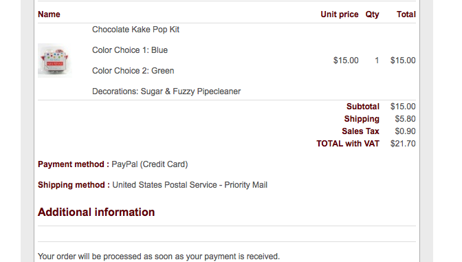

I wanted to change the TOTAL with VAT line that appears in the order notification email (see attached email) for both the customer AND the administrator (see attached screenshots)

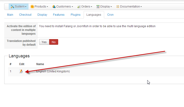

I went to Configuration > Language and clicked on the little edit icon to edit the language file.
Then I found the text I wanted to change, copied it and then scrolled all the way down to the bottom where the override window is and pasted it there. After I had pasted it there, I changed the text. Basically I followed all of your documentation for how to change the language file info and it worked for all other changes I had but NOT for the order notification emails.
As a last ditch effort, I finally opted to change it in the language file itself instead of the override section. I know this is not best practice but I didn't know what else to do because every response on the forum was sending me to the how to edit the language file instructions which I kept saying I understood but in my case was not working.
I am hoping this response makes things a bit more clear and helps you help me figure this out. I really don't know how else to explain my problem.
