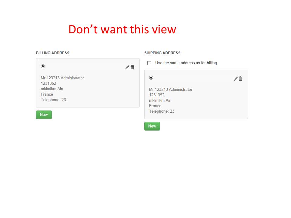

Please could you tell me how I can make the view for billing address to be in the edit mode all the time?
Also, the shipping address (when the the " Use the same address as for billing" checkbox is selected) should be in the edit mode as well.
There rule will be that a customer will only ever have maximum of 1 billing address and/or a maximum of 1 shipping address only.
Please let me know which address view file/code to change?
Thanks.

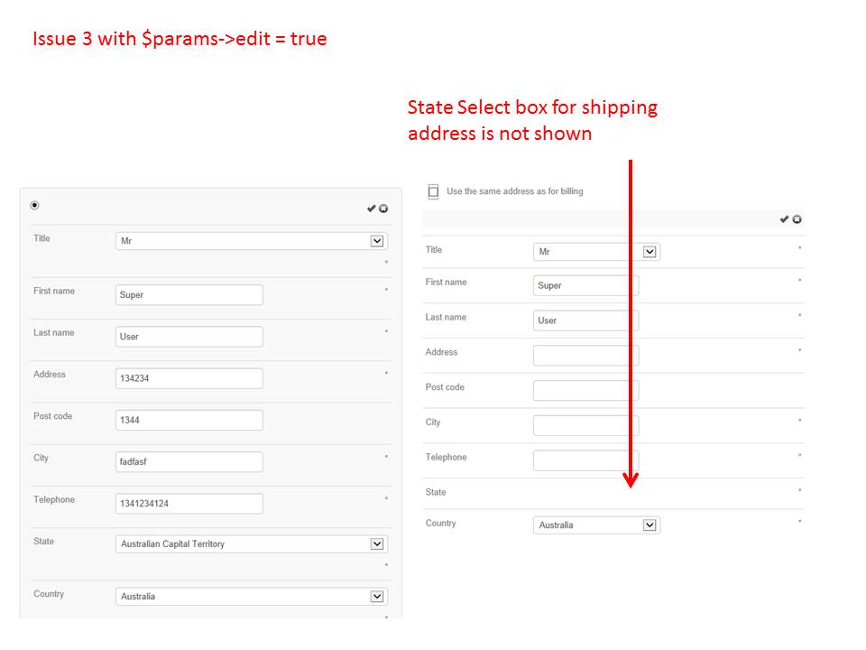

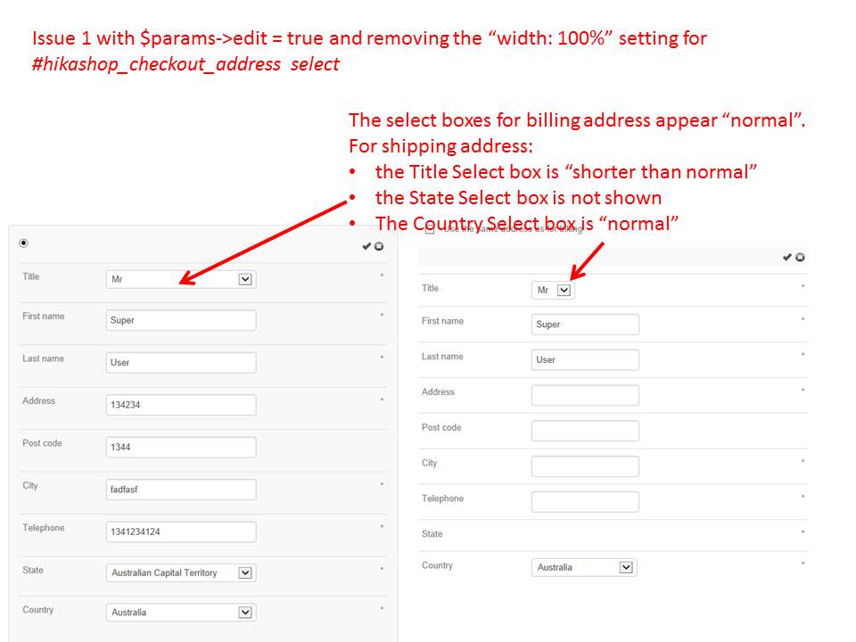

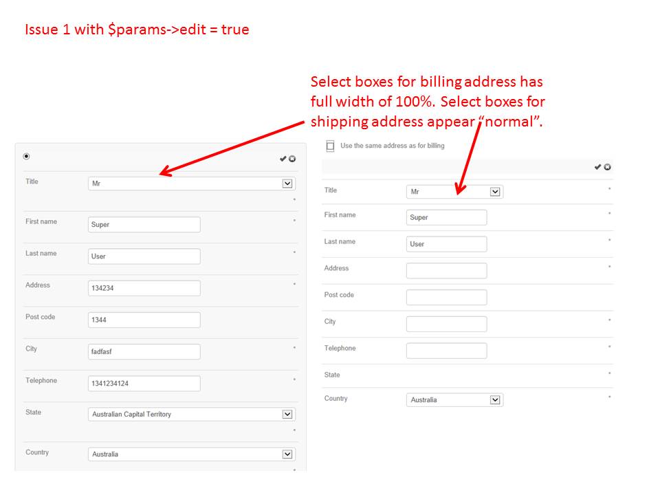

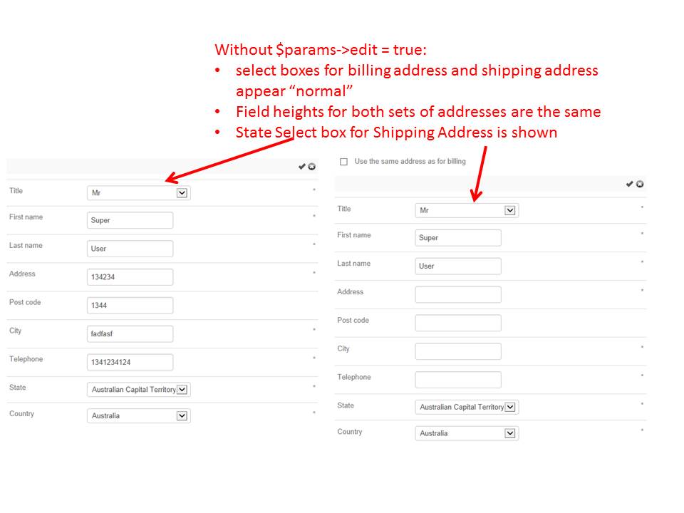

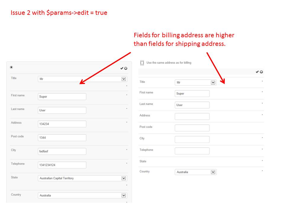

11 years 11 months ago #178466 by Ed_Hika
Hello, Jerome.
Good evening!
The proposed solution works but I have spotted the following issues, which I can't seem to explain nor find a fix. Please could you could provide a suggestion on how I can solve them?
The issues are:
1) the Select boxes have different width
2) the fields have different heights
3) the State select box for Shipping Address doesn't appear
Please refer to the attached images.
Thanks.
Take care!

11 years 11 months ago #179033 by Jerome
The display issue for the size of the inputs (or dropdown) is linked to the CSS.
In the checkout, when you edit an address the edition part is displayed in a different section than the section which display the addresses ; that's why you might have some differences for the CSS.
The line which is higher it just that the dropdown is taking all the width so the asterisk which should be display on the right is display below.
If you want to hide the asterisks, you have to set the field as not required during the call of the display function.
Code:
echo $this->fieldsClass->display( $field, @$this->address->$fieldname, 'data['.$name.']['.$fieldname.']', false, ' ' . $onWhat . '="hikashopToggleFields(this.value,\''.$fieldname.'\',\''.$name.'\',0);"', false, $this->fields, $this->address, false // this parameter is added );
The other solution is to use a CSS in order to hide the span with the classname "hikashop_field_required" in the specific container.
And for the design, the best will be to change a little more the view in order to have the same classes for the container elements.

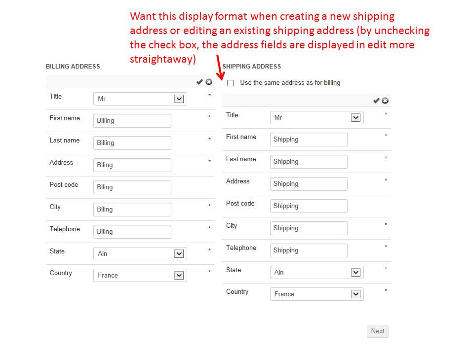

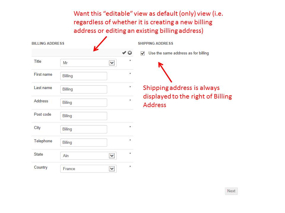

11 years 11 months ago - 11 years 11 months ago #179388 by Ed_Hika
Hello, Jerome.
Good afternoon!
Thank you for your explanation and listing the different solutions.
1) Removing the Asterisks
I have opted for the CSS solution (rather than the php solution) because I think the php solution will actually make the fields optional. I still require for the fields to be mandatory (except to hide the asterisks as the asterisks are displayed next to the labels).
2) Display Issue Regarding the Inputs in Edit Mode

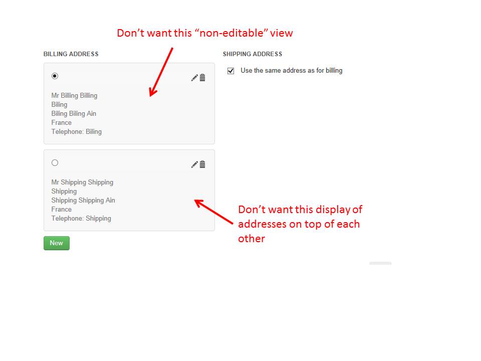

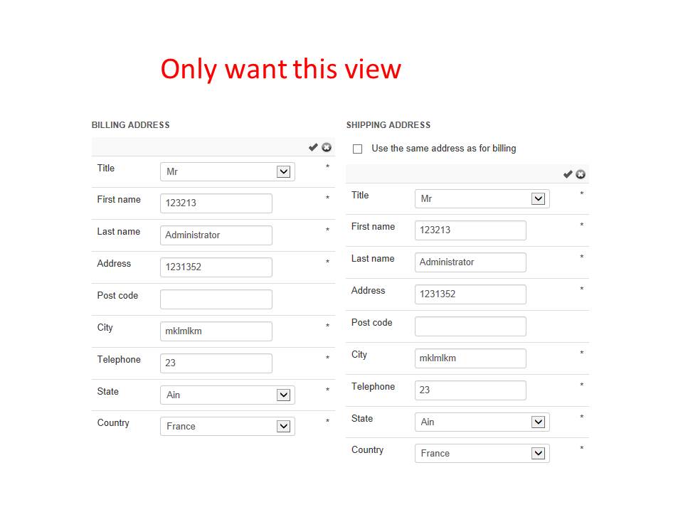

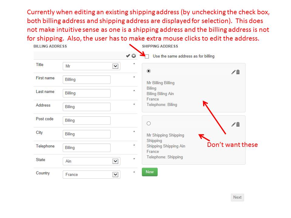

This issue is driving me crazy! Apologies for not explaining the situation clearly before but when the line of code ($params->edit = true;)
is used, the display is different from when the code is not used and subsequently the pencil/edit button is clicked. In my simple mind, these two display modes of editing the same address should be the same.
I have since tracked down to the difference.
a) when the ($params->edit = true;) is not used, the address block falls under the "hikashop_checkout_billing_address_zone" div tag
b) when the ($params->edit = true;) is used, the address block falls under the "hikashop_checkout_billing_address_selection" div tag
Not sure why Hikashop was designed this way; I am sure that there must be a good reason. In any case, this solution is not ideal because once the shipping address is filled in, there will be 2 address blocks displayed one on top of the other and the address management doesn't appear intuitive.
So, I thought it would be prudent to return to the actual requirements that I have. It's to make the address management intuitive and easily navigable by the following requirements:
a) do not display the "non-editable" views for billing address (and also for shipping address - see d) below)
b) always display the billing address and shipping address side-by-side (i.e. never one on top of the other)
c) always display the billing address and shipping address in "editable" views
d) the shipping address block is toggled by the "same as billing address" checkbox.
When the checkbox is unchecked, the shipping address block is displayed to the right of the billing address block.
When the checkbox is checked, the shipping address block is hidden.
There is no need to display a set of addresses for selection when the "same as billing address" checkbox is checked (similar to see a) above)
e) there is only ever a maximum of 1 billing address and/or 1 shipping address per user
Please see attached for an illustration of these requirements.
Hope I have explained the requirements clearly; apologies if it's too muddled.
Thank you very much for your attention and for your help.
Take care!

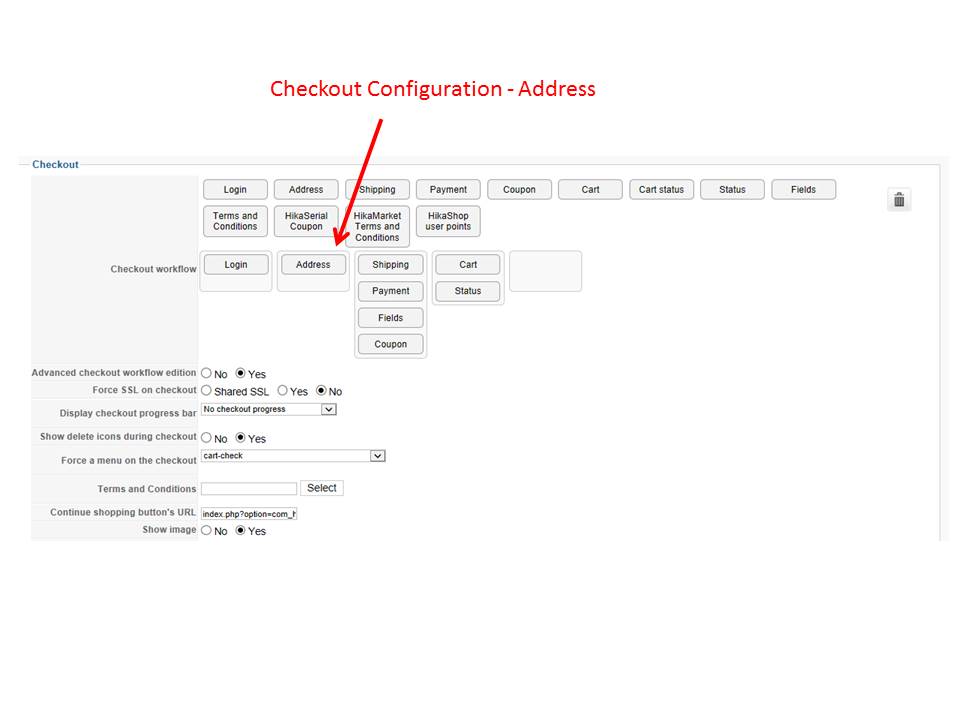

11 years 10 months ago #181957 by Ed_Hika
Thanks, Nicolas.
Yes, your preference for addresses to be assigned either as a billing or shipping address has merits, particularly in the address as dropdown list option and is much more flexible. As I am selecting the address list option, it can appear confusing to the end user, though.
I am not an experience PHP developer by any means. My first PHP code was a Hikashop payment plugin some 3 months ago. Thanks largely to your Hikashop documents, I managed to develop it. Apart from PHP, what I am struggling with in the area of development is getting familiar with the way Hikashop (and also Joomla!) works and the way it is coded.
Coming back to the subject of this topic on customisation of addresses, I have managed to code most of it and have a couple of things left which I hope to pick your brains on.
They are:
1) new rows in the hikashop_addresses table
Using Jerome's suggestion of setting "$params->edit = true" (to always display the addresses in edit mode), the system creates a new row for billing address and another for shipping address even after each checkout, even when no changes are done to the addresses.
How can this be prevented (and not have the new address rows created) whilst having the "$params->edit = true"?
2) clicking on the "Next" button twice
The following discussion assumes that the Address task is the only task in its step (see attached).
Setting "$params->edit = true" (to always display the addresses in edit mode), the user always have to click the "Next" button twice to move to the next step. The first click on the "Next" button brings the user to the address selection mode and the next click brings the user to the next step. As I prefer the user to always be in the edit mode (by setting "$params->edit = true"), the first click is redundant (and confusing to the user).
How can the user be progressed to the next step in the checkout process with only a single click on the "Next" button?
Thanks for your help.
Take care!

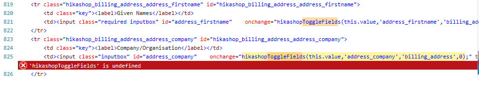

I have one last hurdle (hopefully) regarding displaying the address in edit mode. I am going back to Jerome's recommendation of using
Code:
When a field is changed, the function hikashoptoggleFields is not found.
Please could you let me know what function to call so that the hikashopToggleFields function can be found (i.e. I do not want to remove the call to the hikashopToggleFields function (in address/show.php)? Just want to know why Hikashop cannot find this when $params->edit is set to true and how to fix it.
Thanks.
Take care!
More
11 years 8 months ago #190197 by Jerome
Regarding the "views/address/view.html.php" ; if you are in edit mode or not, the javascript should be added in the page header.
But the easier solution will be to call the getLayout function without displaying his return and with the "edit=false" ; so you will sure that you will have the required JavaScript.
I will continue to perform some tests in order to be sure that the problem will be correctly solved in the next HikaShop release.
