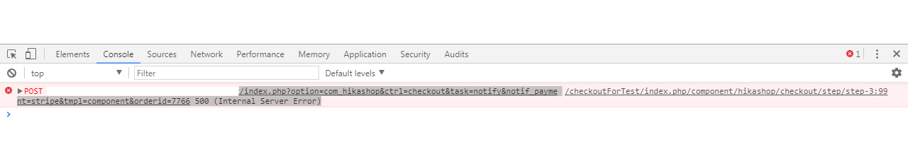

I am getting a 500 Error on Stripe checkout after the user inputs their card and submits their order. This appears to have started after migrating to a new VPS. When looking in my logs, the error appears to be as follows:
[Thu Oct 06 03:58:26.866824 2016] [cgi:error] [pid 15628:tid 140544558708480] [client 64.37.231.173:35304] AH02812: attempt to invoke directory as script: /home/agames/public_html/cgi-bin/
Any ideas on what may be causing this?

error message shows - PHP log
[12-Sep-2017 14:53:09 America/New_York] Stripe Notice: Undefined property of Stripe\Customer instance: sources
[12-Sep-2017 14:54:11 America/New_York] Stripe Notice: Undefined property of Stripe\Customer instance: sources
the page is blank, no other error.
