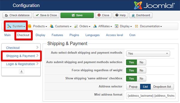

Firstly, can you check that the "Auto submit shipping and payment methods selection" option is set to YES through the page "Hikashop->System->Configuration->Checkout" and test it again ?

Hi Mohamed,
Those options are indeed checked.
The issue is still present.
