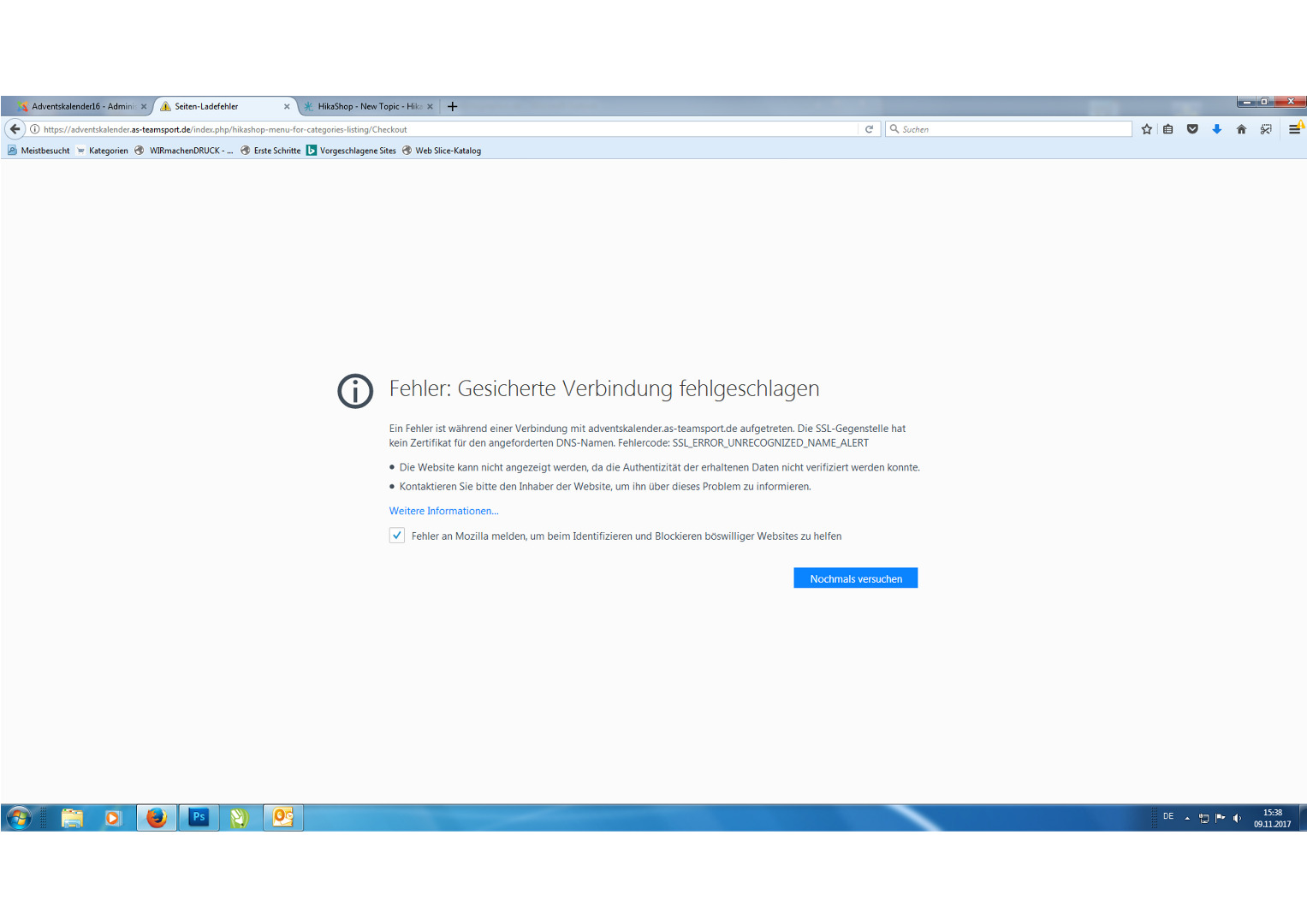

-- Joomla version -- : 3.8.2
Hi guys,

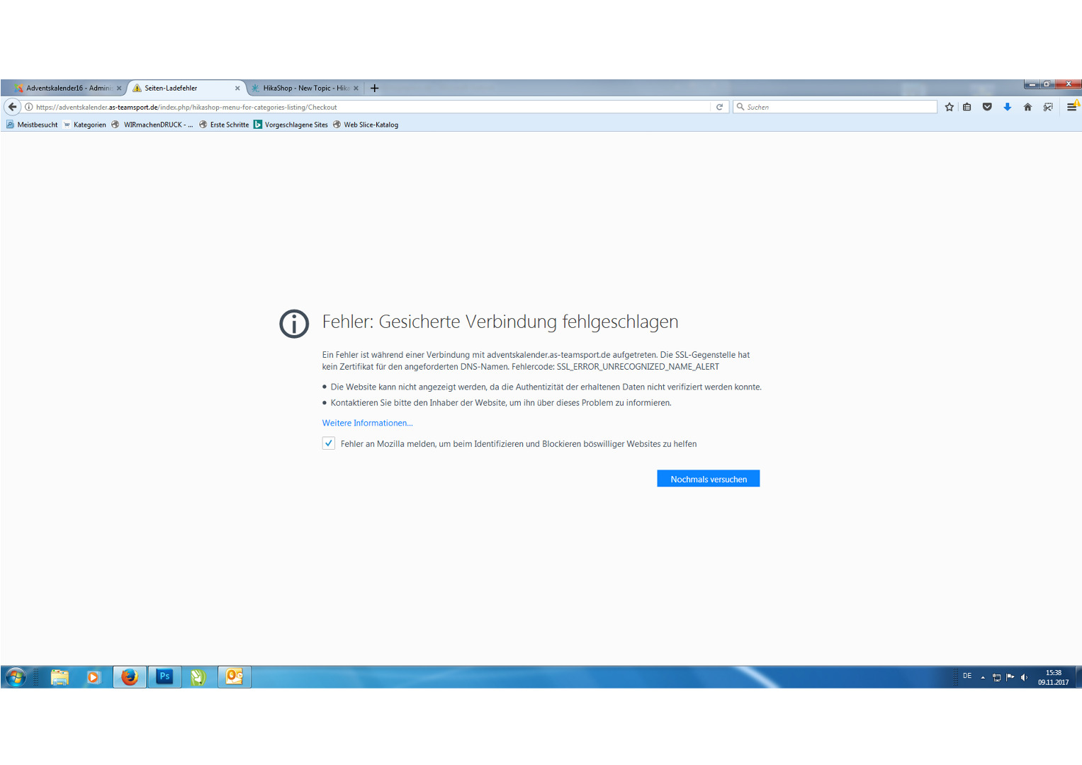

i have a problem. I have a Webseite which i use as an Adventskalender. So we are just selling stuff from the 1st to 24th Dezember. Now i wanted to use the same one like last year and it all works perfekct. I now wanted to do a bought something for test and i dont get to the checkout process i always getting an error massage the setting is still like last year i think.

This looks like a SSL problem. Your website does not seem to have a SSL certificate, but your checkout page seems to try to use SSL.
You can check if this is the case by going to the configuration of Hikashop > Checkout > Checkout. See if the option 'Force SSL on checkout' is [No].
Hope this is helpful!

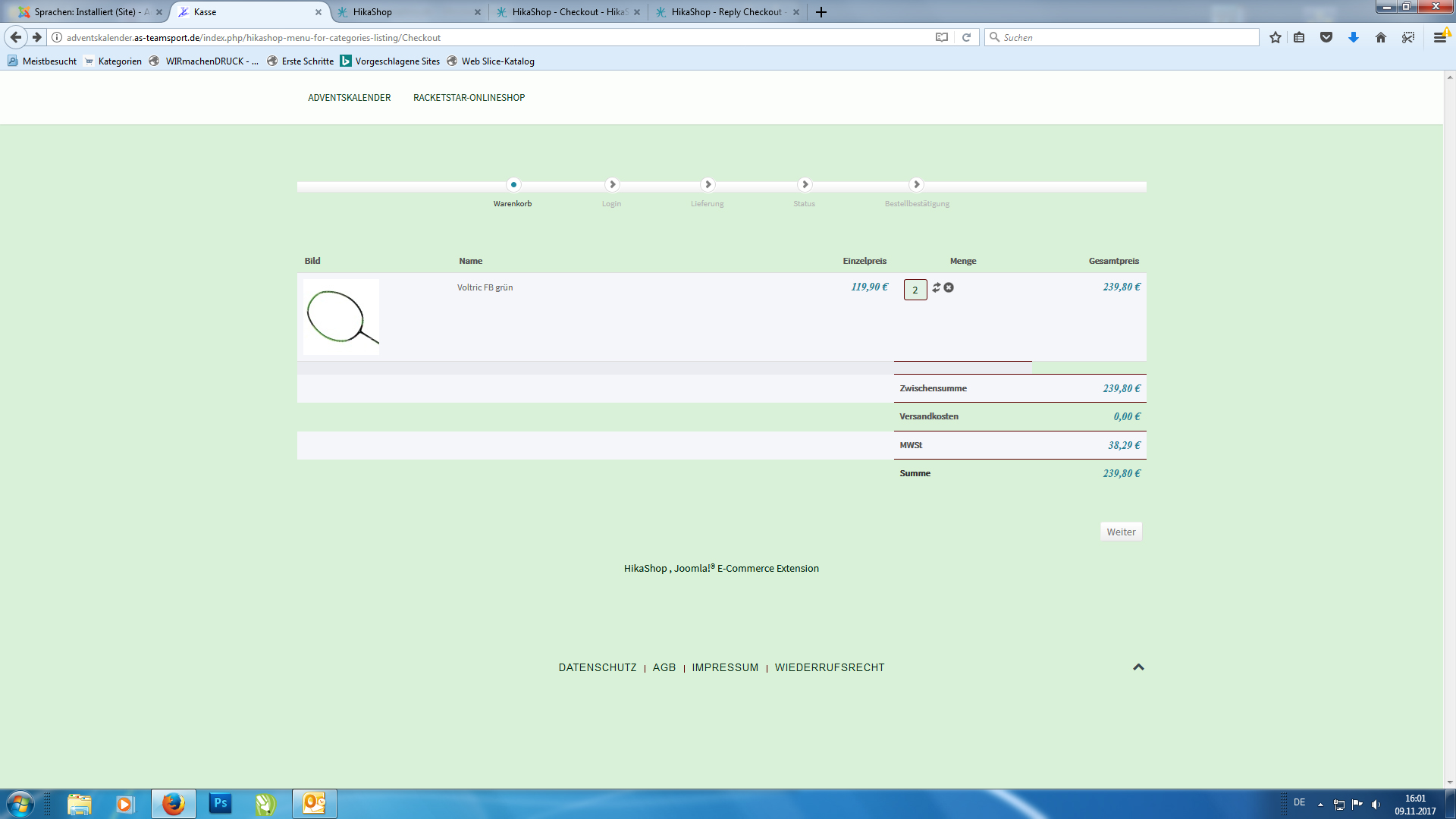

Thanks yes it fixed it,

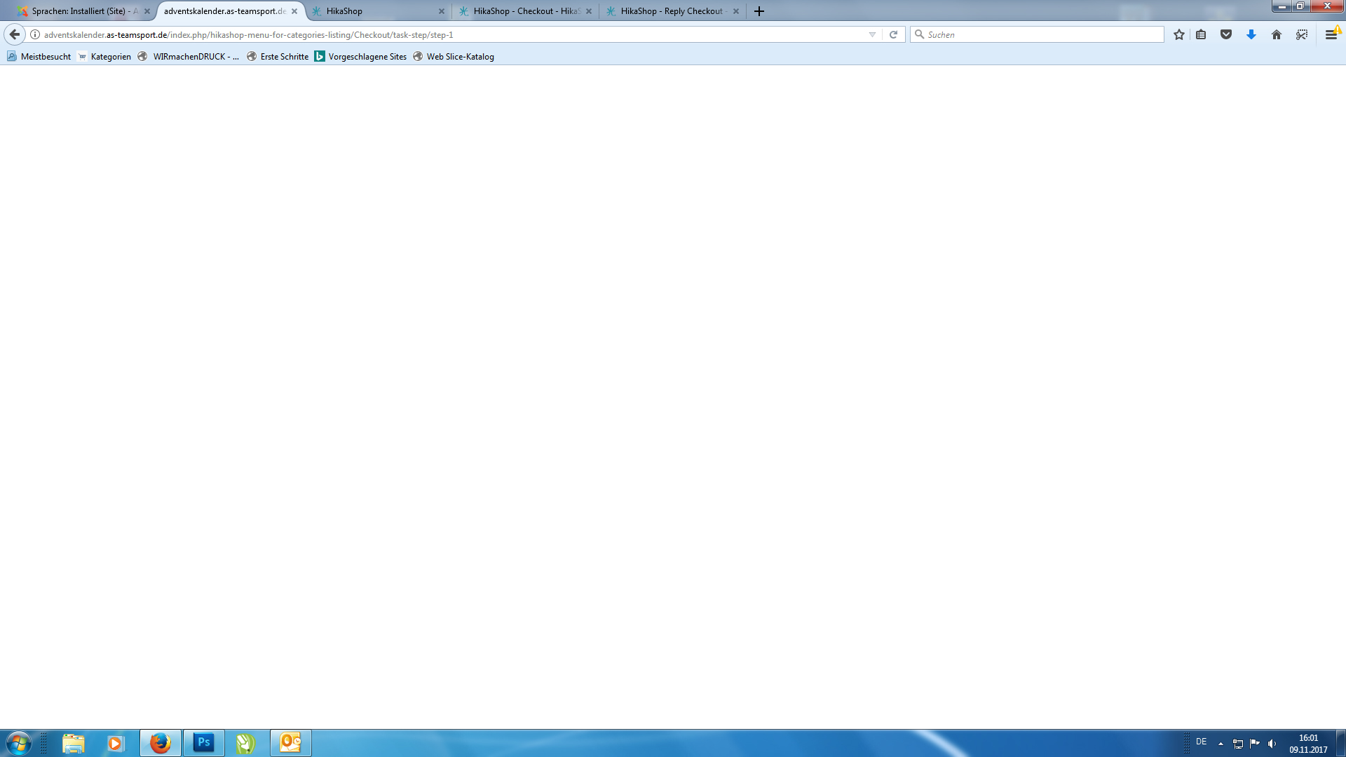

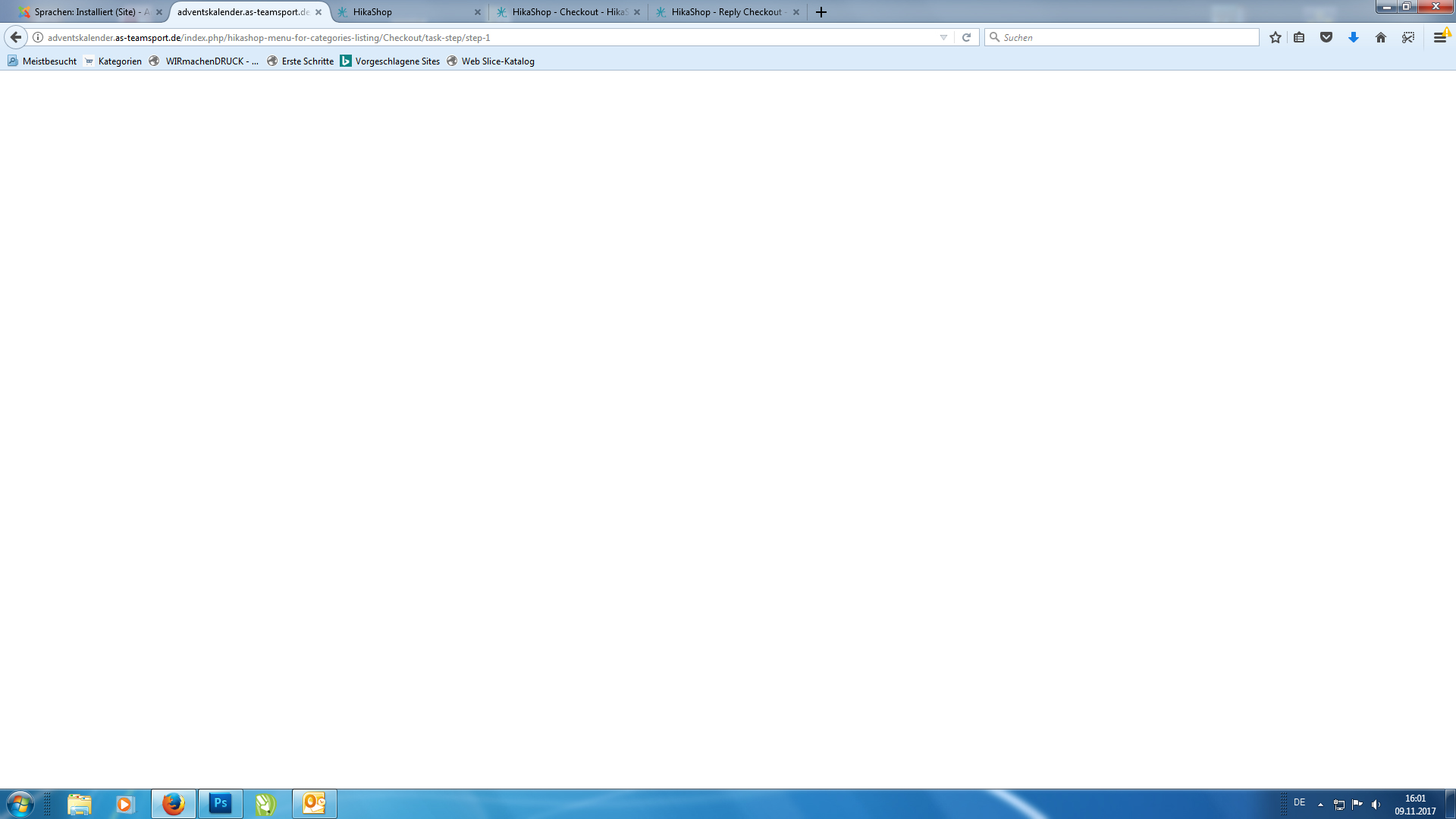

now I come to the checkout but when i do next i have a blank page.

8 years 10 months ago #282191
This is not easy to answer.
It seems Hikashop encounters an error.
I suggest you turn on error reporting in the global settings of Joomla and reproduce the steps. This way you might get an error message. If you do, please post the error message in your reply.

Warning: Illegal string offset 'country_Austria_14' in /mnt/web217/c0/96/5198696/htdocs/joomla_11/administrator/components/com_hikashop/classes/field.php on line 640 Recoverable fatal error: Object of class stdClass could not be converted to string in /mnt/web217/c0/96/5198696/htdocs/joomla_11/administrator/components/com_hikashop/classes/field.php on line 640

That's because you're using an old version of HikaShop which is not meant to work with neither your version of Joomla nor your version of PHP.
Please update your HikaShop and that error will be fixed automatically.

Thanks everyone. If fixed it
