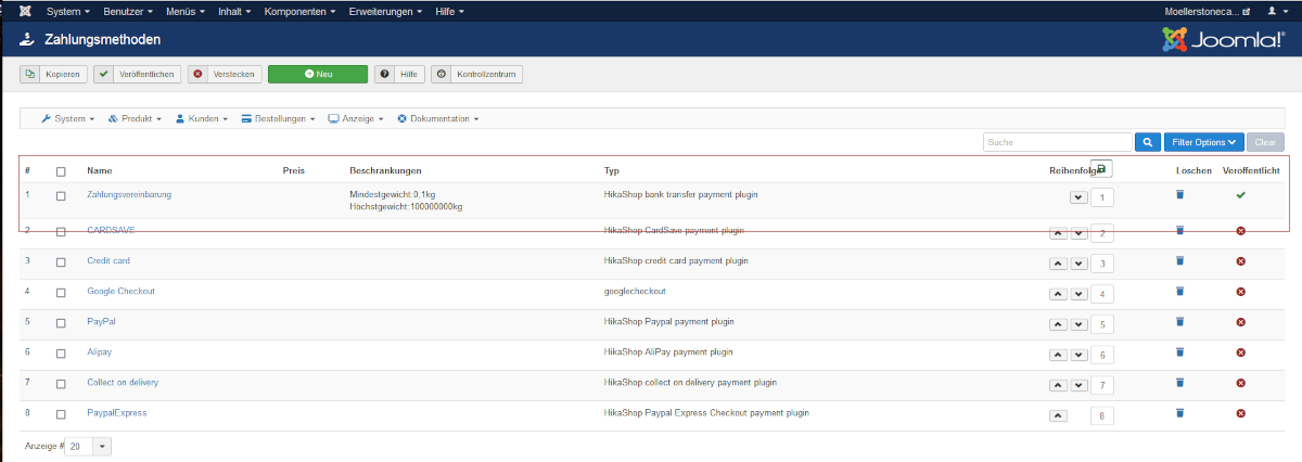

@chli:
du kannst eine URL in den Zahlungsmethoden hinterlegen. Also: Zahlungsmethode(n) editieren und im Feld "Rückkehr URL" einen Link eintragen. Das kann natürlich eine relative URL sein (z.B. zu einem Joomla-Artikel mit alias "/dankeschoen"), und so kannst du auch für jede Zahlungsmethode zu einer jeweils speziellen Seite leiten.

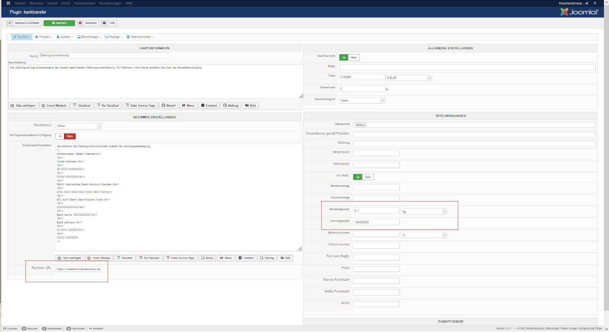

3 years 9 months ago #346914
Hello, unfortunately it still doesn't work.
The entry in the payment information was made, but this has no effect.
There is still only the text information instead of the forwarding.
  • Posts: 86212
3 years 9 months ago #346916
The text I see on your screenshot is the default thank you page of HikaShop. However, the bank transfer payment plugin has its own HTML, which adds for example the bank transfer information you've entered in the settings of the payment method.
This HTML also contains the redirection to the return URL you can specify in the parameters of the payment method.
The only reason I can see it wouldn't use that HTML and instead use the default thank you page is if the file plugins/hikashoppayment/banktransfer/banktransfer_end.php would have been deleted. So please check that this file is still there via FTP.
Note that the "bank transfer" payment method is quite similar to the "collect on delivery". So you could try setup instead a payment method with the "collect on delivery" payment plugin. You'll just need to add 1 or 2 translation overrides to adapt the text displayed.
  • Posts: 103
  • Thank you received: 12
3 years 9 months ago #347556
Thank you for the feedback.
The banktransfer_end.php file is present.
In my shop I created an extra payment method and deactivated all others. Since we operate a B2B shop, the various payment methods are stored in our main system, so the customer only receives information that the order will be carried out in accordance with the agreement made so far.
The return URL is stored in the only payment method I have created, which unfortunately is not used after pressing the purchase button.
Greetings from Christian
  • Posts: 86212
3 years 9 months ago #347559
I don't see how that's possible, unless you removed the "payment" view from your "checkout workflow", or if the total amount of the cart is 0. In these cases, it's possible there is actually no payment method selected at all and thus it displays the default thank you page of HikaShop.
Could you check that it's not the case ?

3 years 9 months ago #347586
Sorry I described that wrong.
I selected the payment method "HikaShop bank transfer payment plugin" and indicated there that it will be used from 0.1 kg. All other payment methods have been disabled.
The forwarding is specified in this payment method.
  • Posts: 86212
3 years 9 months ago #347589
Please make sure you have the "payment" view in the "Checkout workflow" of the HikaShop configuration. And you can remove the restrictions on the weight in the payment method, they won't help, just create potential problems (for example if you forget to set a weight in a product, since it would mean no one would be able to purchase the product as the total weight of the cart would be 0 and thus the payment method wouldn't be available).

3 years 9 months ago #347692
There are no prices and thus no payment required on your shop.
So it's normal the payment method is not taken into account since a payment method is only when the total amount is greater than 0.
Change the shipping to be 0.01 instead of 0 and you'll see the payment method on your checkout and then the return URL of the payment method will be taken into account.
Now, if you want a specific return URL while having no prices, and thus no payment method, in your shop, then you should edit the checkout/end view file to add the redirect yourself with a bit of code like this:
<?php JFactory::getApplication()->redirect('RETURNURL'); ?>
where you replace RETURNURL by the actual URL
