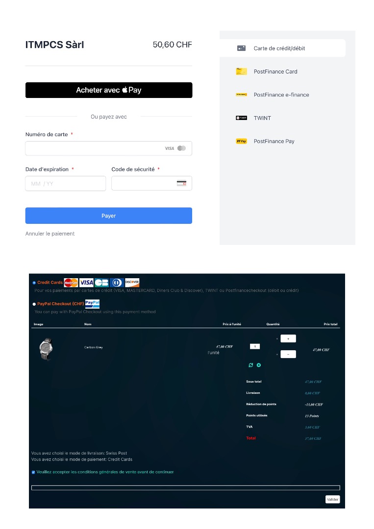

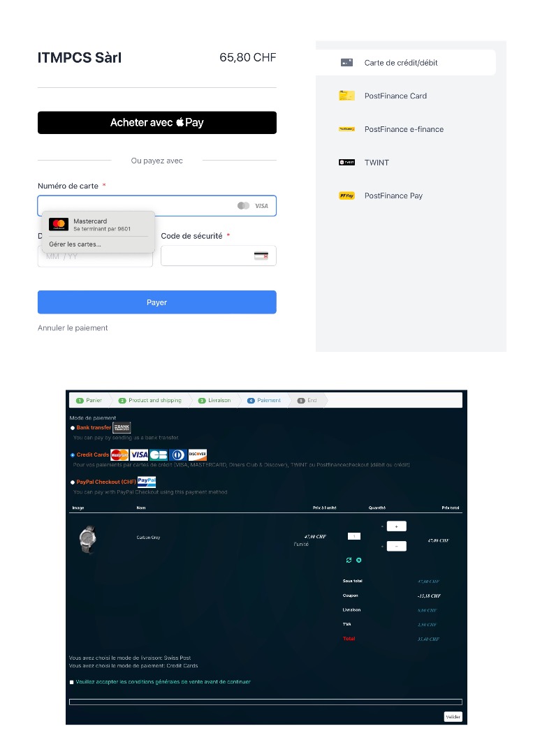

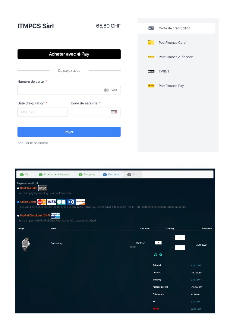

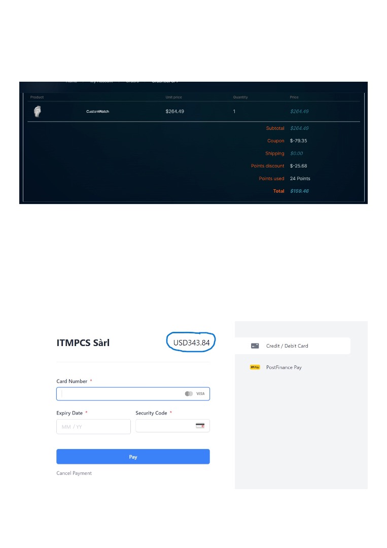

Hello
we noticed that the amount of the order transmitted to credit cards is not accurate when coupon or points plugin are used. I prepared several examples below. Please note that the calculation made by Hikashop is always accurate in the total amount. It is just a different amount that is transmitted for payment to credit cards.
Here below a real order cancelled by the customer:
In this example the total transmitted to CC is in fact the cost of the product + amount of coupon (30%)
Used points not considered (and despite the fact that the coupon amount is added...)
In the example below we have the amount of the product + VAT.
Used points in reduction are not considered
In the next example, the amount transmitted is almost product + coupon + VAT (almost, 10 cents difference)
And in the last, I used only coupon without points. Same behaviour are previous example, same amount

If the total displayed by HikaShop is correct but the amount received and displayed by the payment gateway is different, then it means that the problem is in the middle, with the payment plugin used to connect HikaShop with the payment gateway.
Which payment plugin are you using ?
