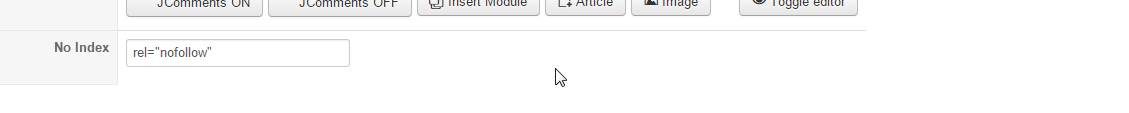

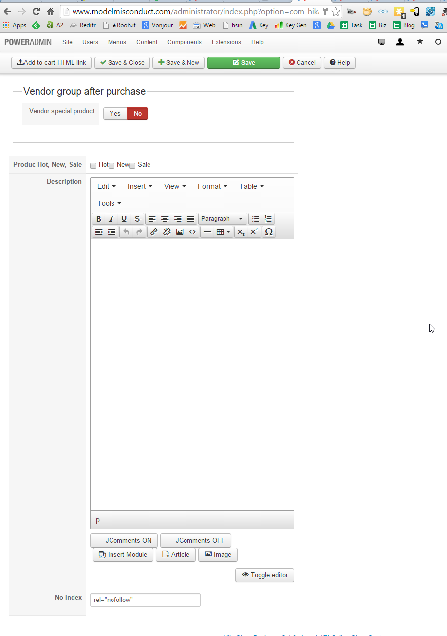

I have a custom field labeled "No Index" associated with a column name for my product called "nofollow"
I set the default value to equal rel="nofollow" (pic attached)

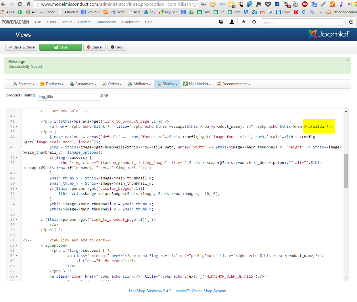

I then go to the listing_img_title file of PRODUCT under DISPLAY->VIEWS for the front end of my specific template
I replace
<a href="<?php echo $link;?>" title="<?php echo $this->escape($this->row->product_name); ?>">
with
<a href="<?php echo $link;?>" title="<?php echo $this->escape($this->row->product_name); ?>" <?php echo $this->row->nofollow;?>>
should the nofollow above be No Index?

11 years 5 months ago #195911
I don't see why that change would generate a 404 error since you don't change the href attribute of the link.
On top of that, your modification is correct so it should work fine.
The 404 error must come from something else.
