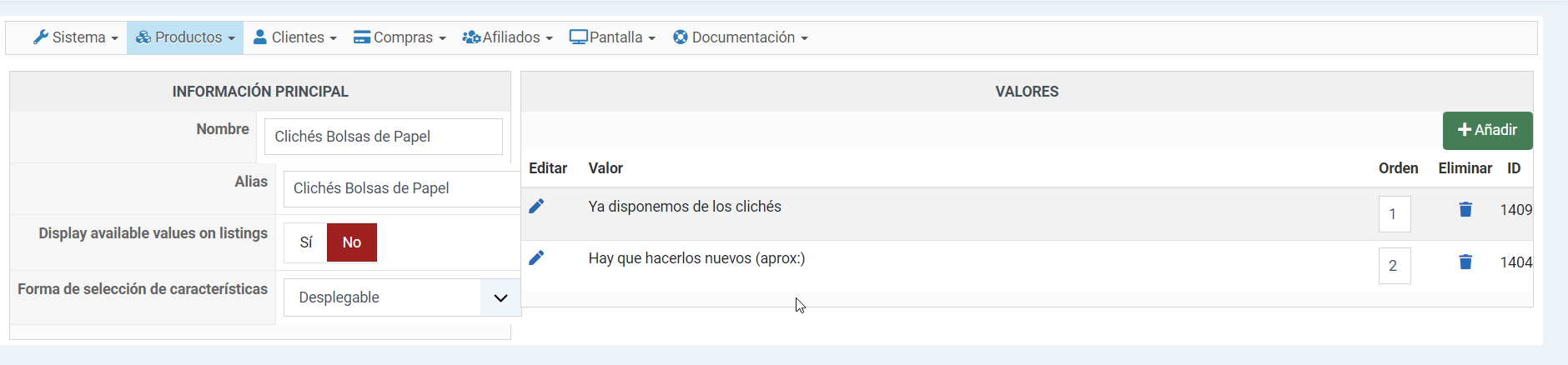

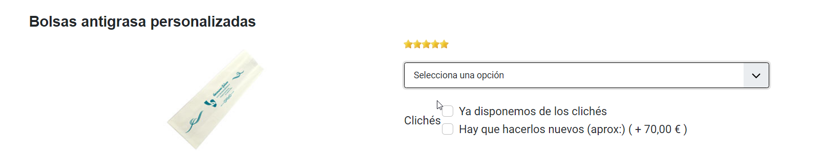

Hi Nicolas.
I am testing in a parallel domain for integration with joomla 4.
In products that have additional options I can't get them to show up as a dropdown.
All are displayed as a radio button.
When I try to enter the product in the variants category, the page is displayed as you can see in the screenshot.
What I can do?

4 years 2 months ago #344577
by nicolas
Replied by nicolas on topic Item options
You have the setting "Product selection method" in the HikaShop configuration to control the display mode of the options.
The setting in the characteristic is only for when a characteristic is used directly, not through an option.
Regarding "when you try to enter the product in the variants category", activate the "debug" setting of the Joomla configuration and try again, you should have the error message at the end of the page. That will help us understand what's going on.

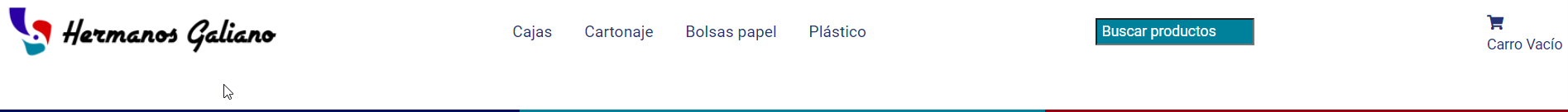

I also have another issue with a Hika search module.
When this module is activated it leaves a lot of space at the bottom and I can't find the CSS for the module to not make it so much white space.
Can you help me?
I enclose a screenshot so you can see the space left by the search module at the bottom.
Problem found and fixed.
Can you help me?
4 years 2 months ago #344591
by nicolas
Hard to say without looking at the HTML / CSS there.
Could you provide a link to that page ?

4 years 2 months ago #344597
by Reincidente
Replied by Reincidente on topic Item options
The url is:
www.singastosdeenvio.es
4 years 2 months ago #344603
by nicolas
In the settings of your filter in the menu Display>Filters, you have a "height" setting. There, you should enter a value small enough so that you can still see the input field while it doesn't increase the height of the header.
Also, you probably want to turn off the "Collapsable filters" setting of the HikaShop filter module.

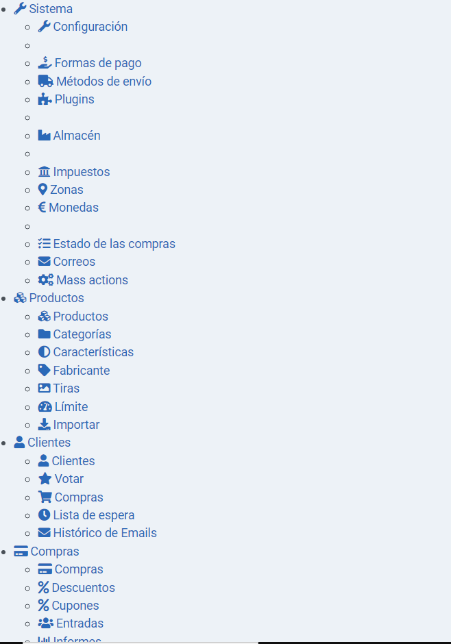

4 years 2 months ago #344611
by Reincidente
Do you mean Hikashop settings?
I can't see filters in the display menu
