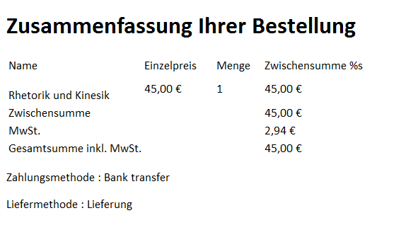

12 years 6 months ago #152265 by Nicole Lewin
I have the problem that the subtotal in the bill contains the VAT.
How I can correct this failure?
Thanks for your help.
