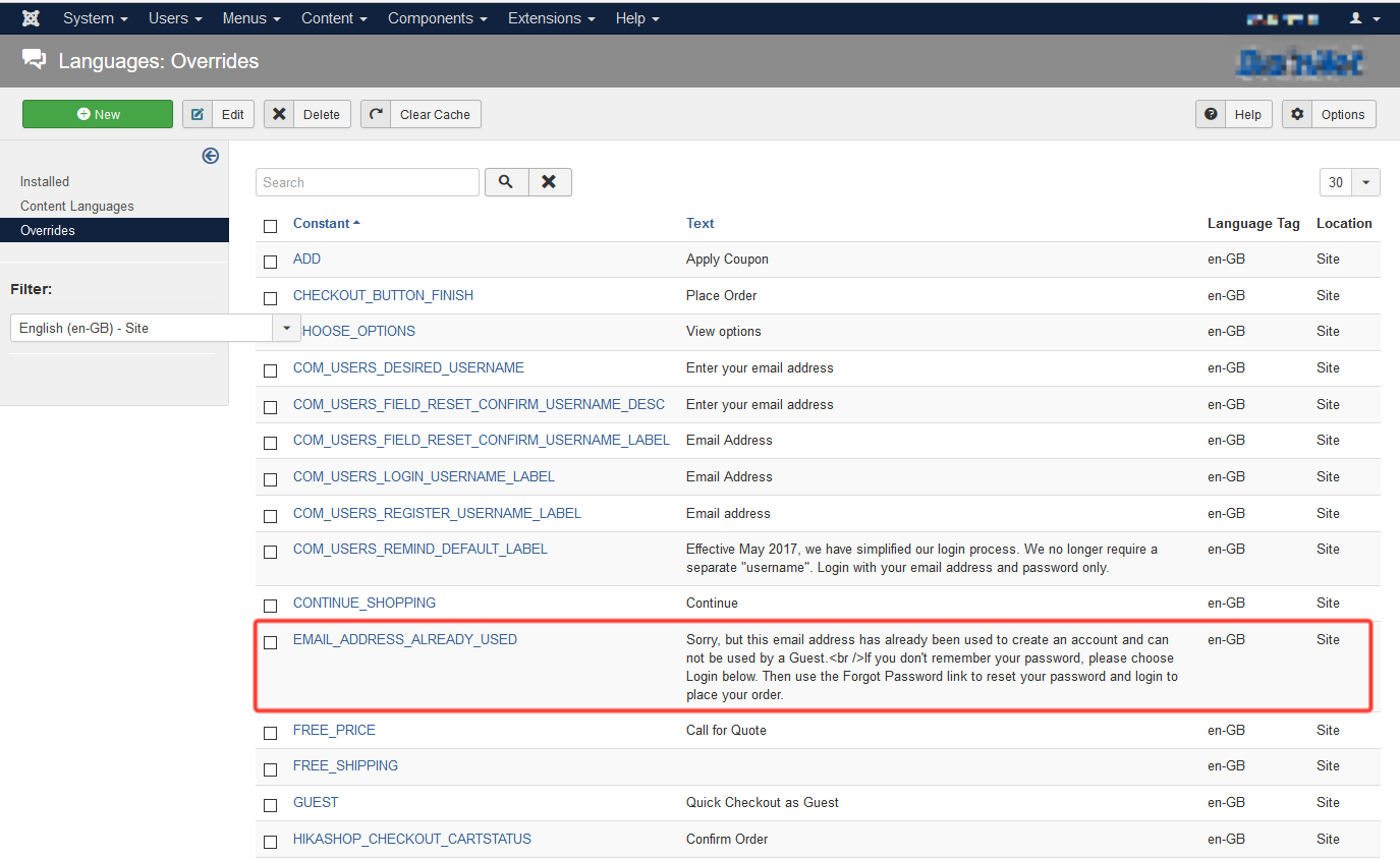

We also ran into this issue, which is more of a Joomla problem than a HikaShop issue. What we did is simply add a language override that provides a much more user friendly error message. Complaints dropped significantly after that.
Like shown here: cl.ly/3L2V3o1n0T3W
