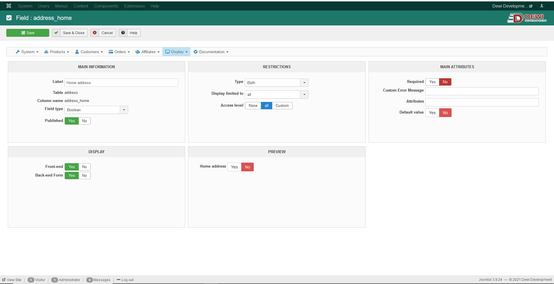

I have setup a custom address field Home Address. Picture attached.
I have setup two custom address fields that get business address information if Home Address is No(False).
The Home Address field will not change in Front View. It does change in Backend View. It is stuck on the default value and does not respond to user interaction.
Thank you
David

5 years 9 months ago #329371
by nicolas
Replied by nicolas on topic Boolean Yes/No not switching
Thank you for your feedback. I was able to reproduce the issue on my end. There is indeed a bug here. I've added a patch on our end for that and it now works fine for me.
Download again the install package of HikaShop on our website and install it on yours and it will add the patch for it.
