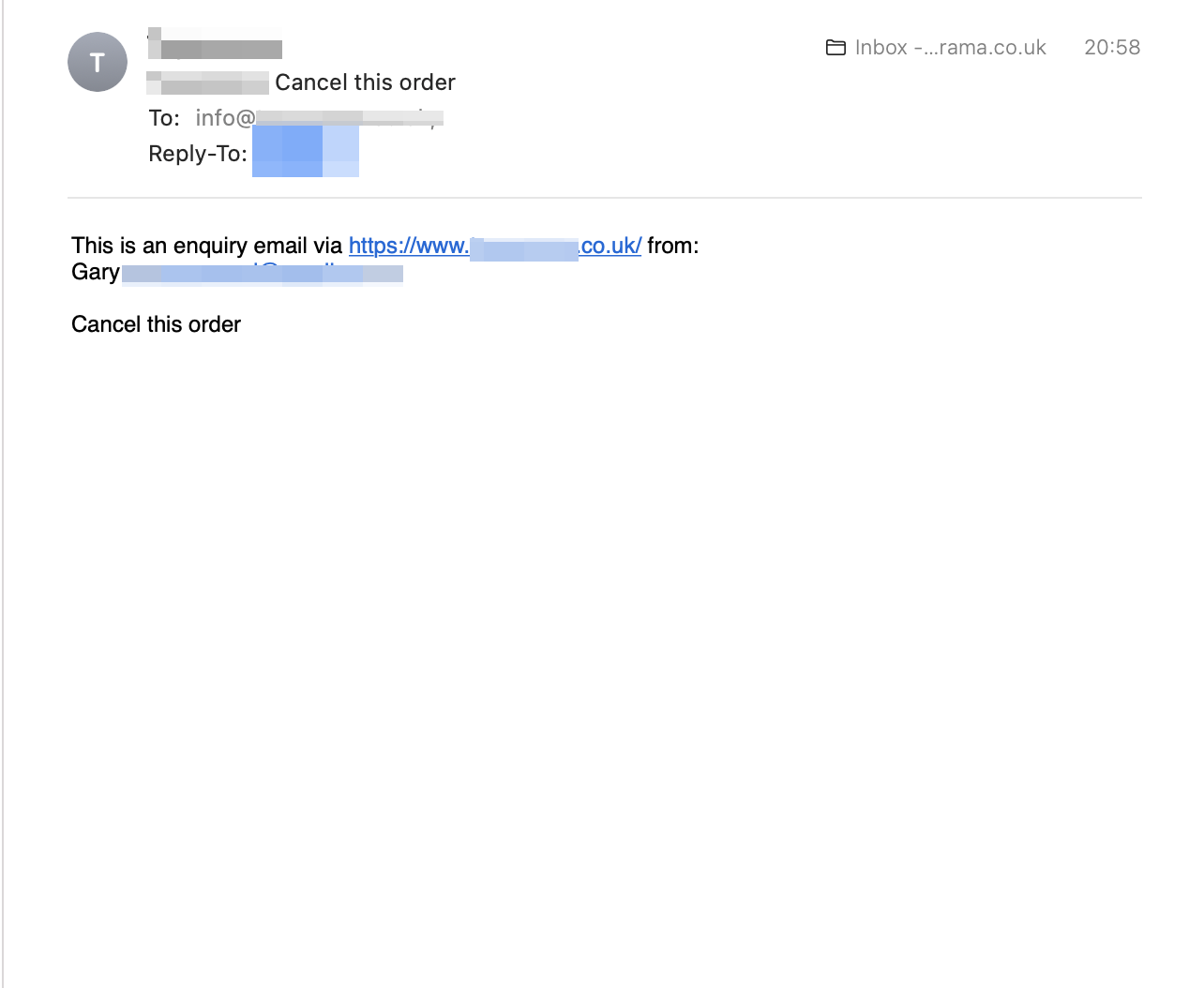

The client has an option for users to amend their orders and then receives an admin email when this happens. However a blank email is being sent. There is no order number or any other reference to which order it relates too. The last email just stated cancel order as per screenshot. Not sure where this email can be adjusted?

this email was triggered by the client using the Amend Order from the user control panel.
I think I have found the issue, the hidden menu item goes to a contact form on the site which is outside of Hikashop. So is there a way to automatically add the information into the email?

Hi Nicolas
the amend option was added as a button by me. The button take you to a Joomla Contact Form. I may have to look at an alternative form that may be able to pull the data from the database.

In that case, I would recommend modifying that button to use HikaShop's contact form page (you can create a menu item of the type HikaShop product contact form via the joomla menu manager to ge tthe link to it).
That way, it will use the "contact request" email of HikaShop when the contact form is submitted, and you'll be able to customize it via the System>Emails menu of HikaShop.
Allowing customers to modify orders is not possible.
It would be problematic if the customer removes a product or add one while the payment has already been done.
Now, having such contact button on the order details page, without the need for a customization to add it, is something we could look into and which looks like an interesting idea.
