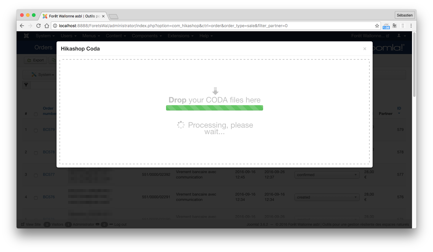

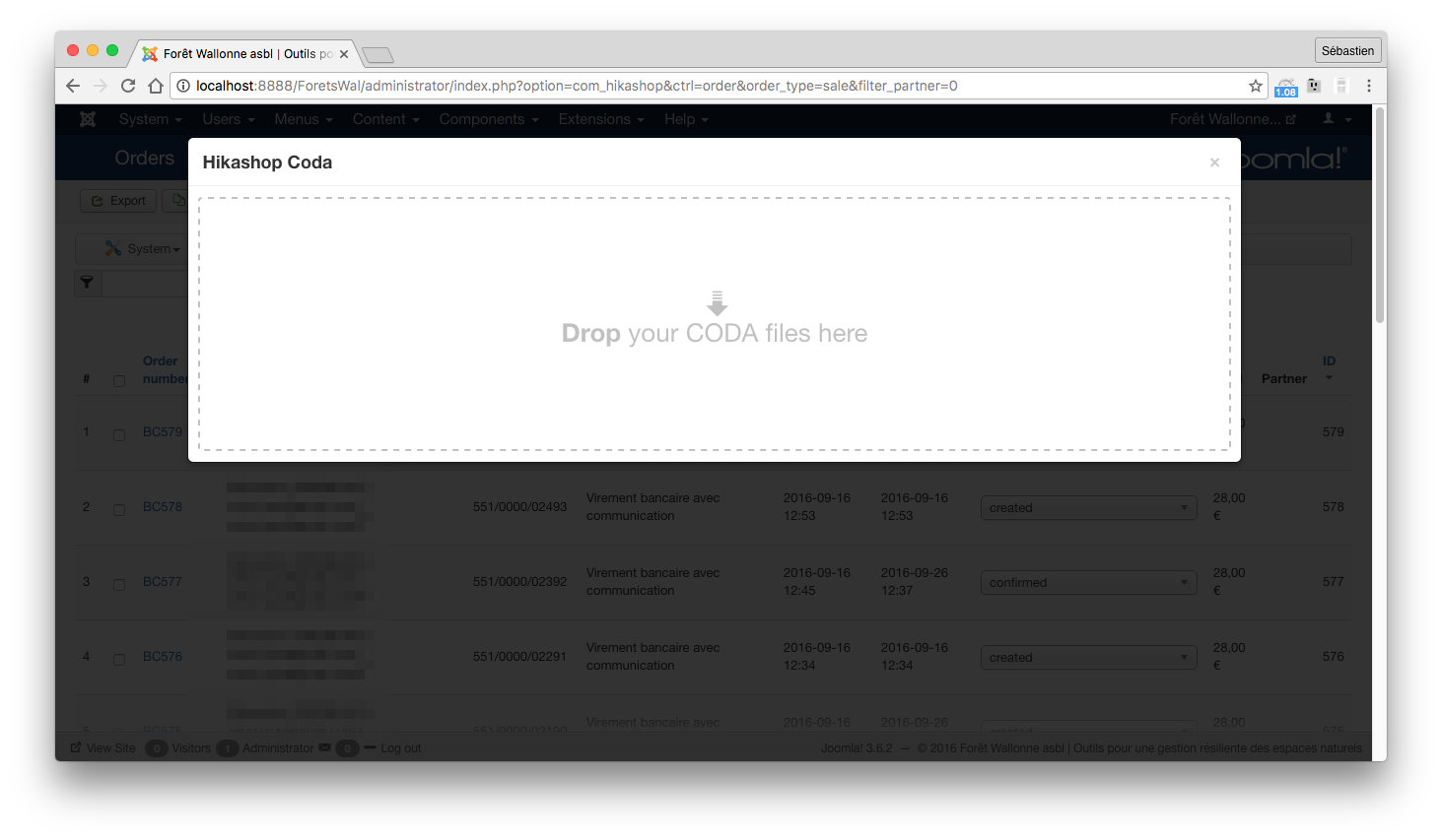

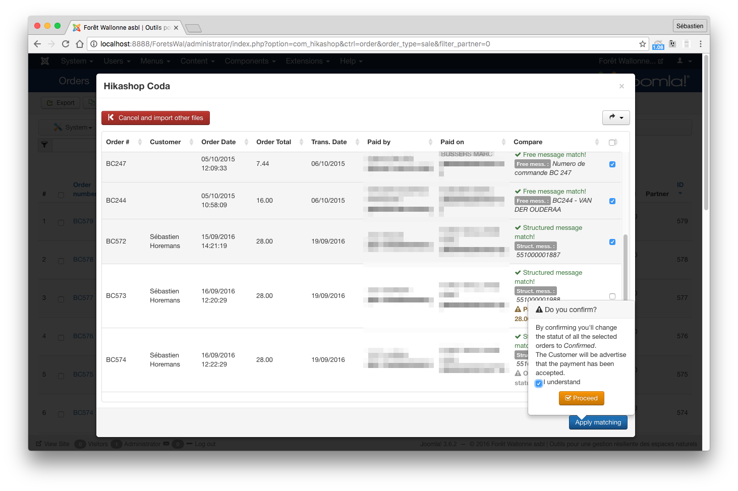

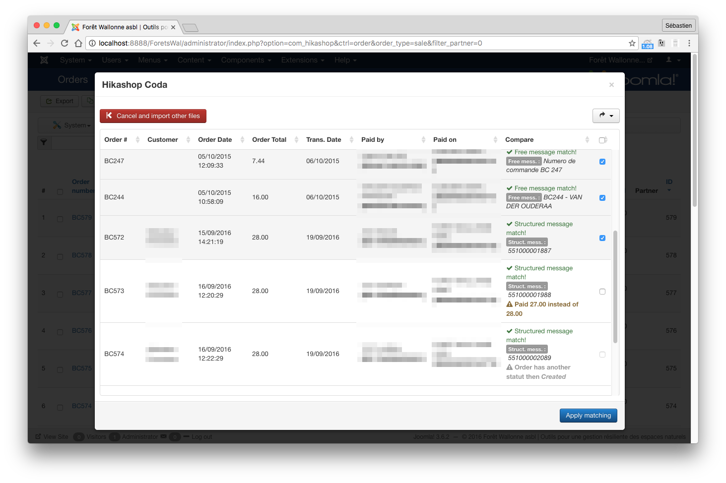

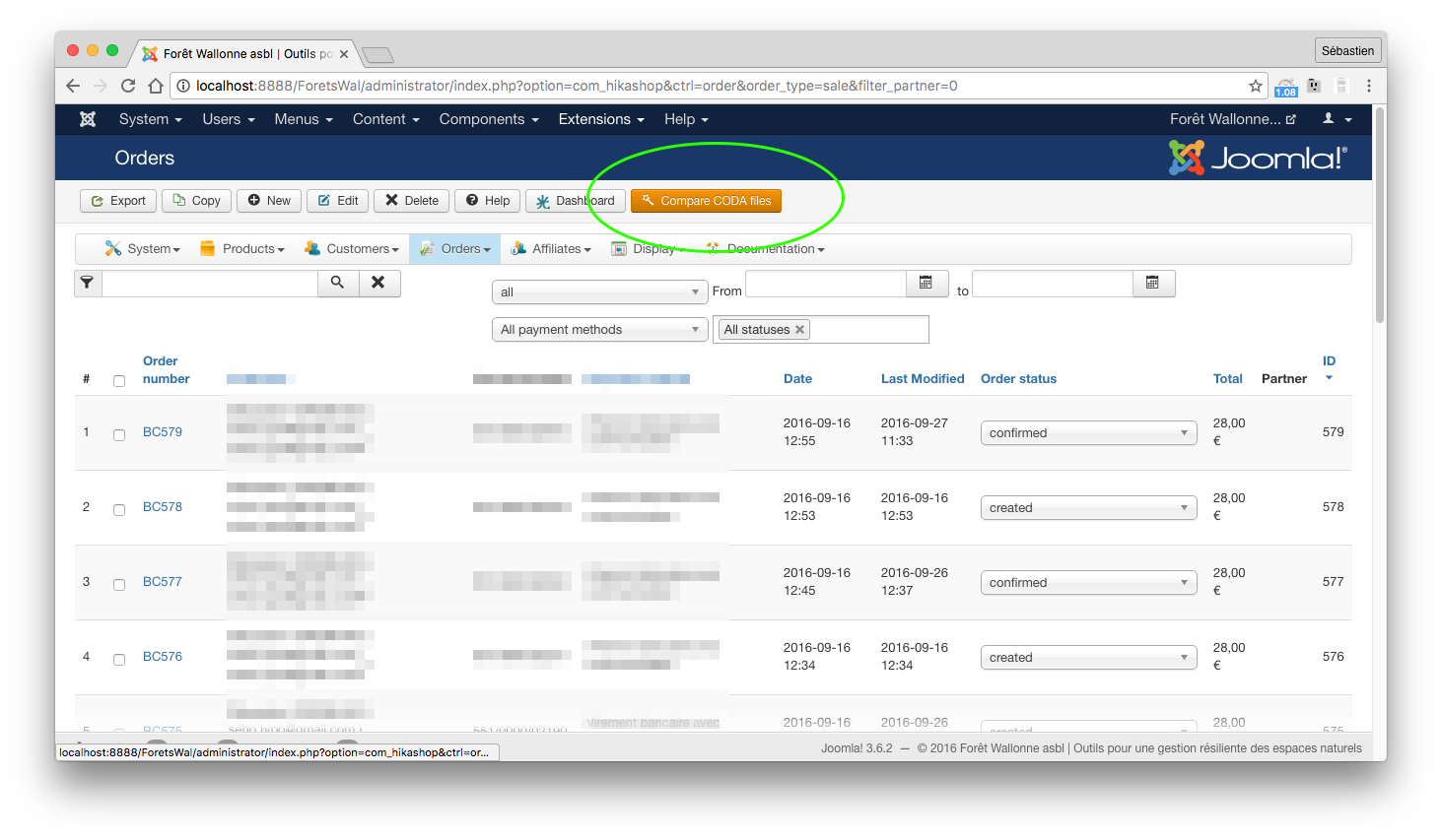

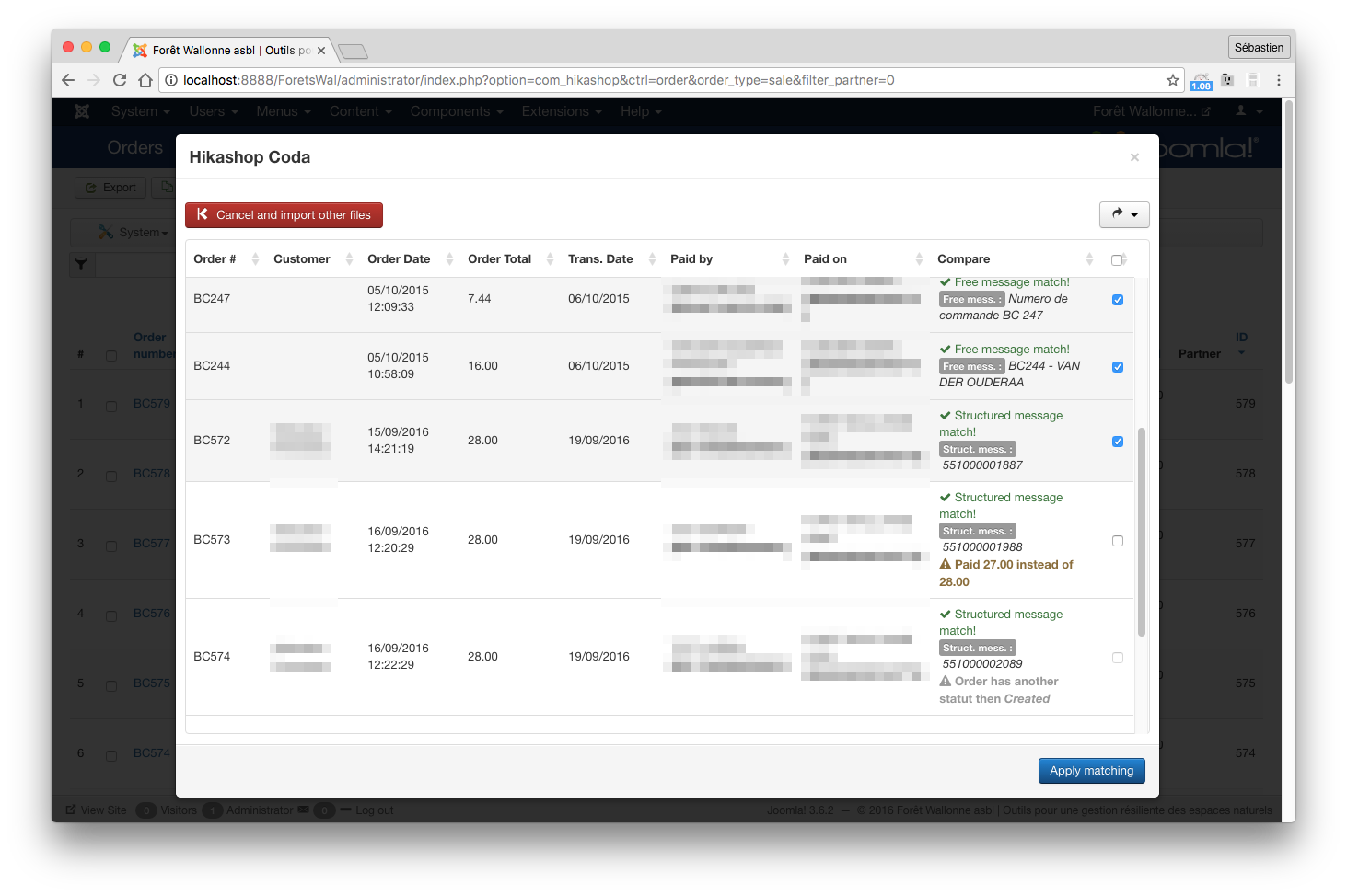

Thank a lot for your mail, you're right for the bank reconciliation

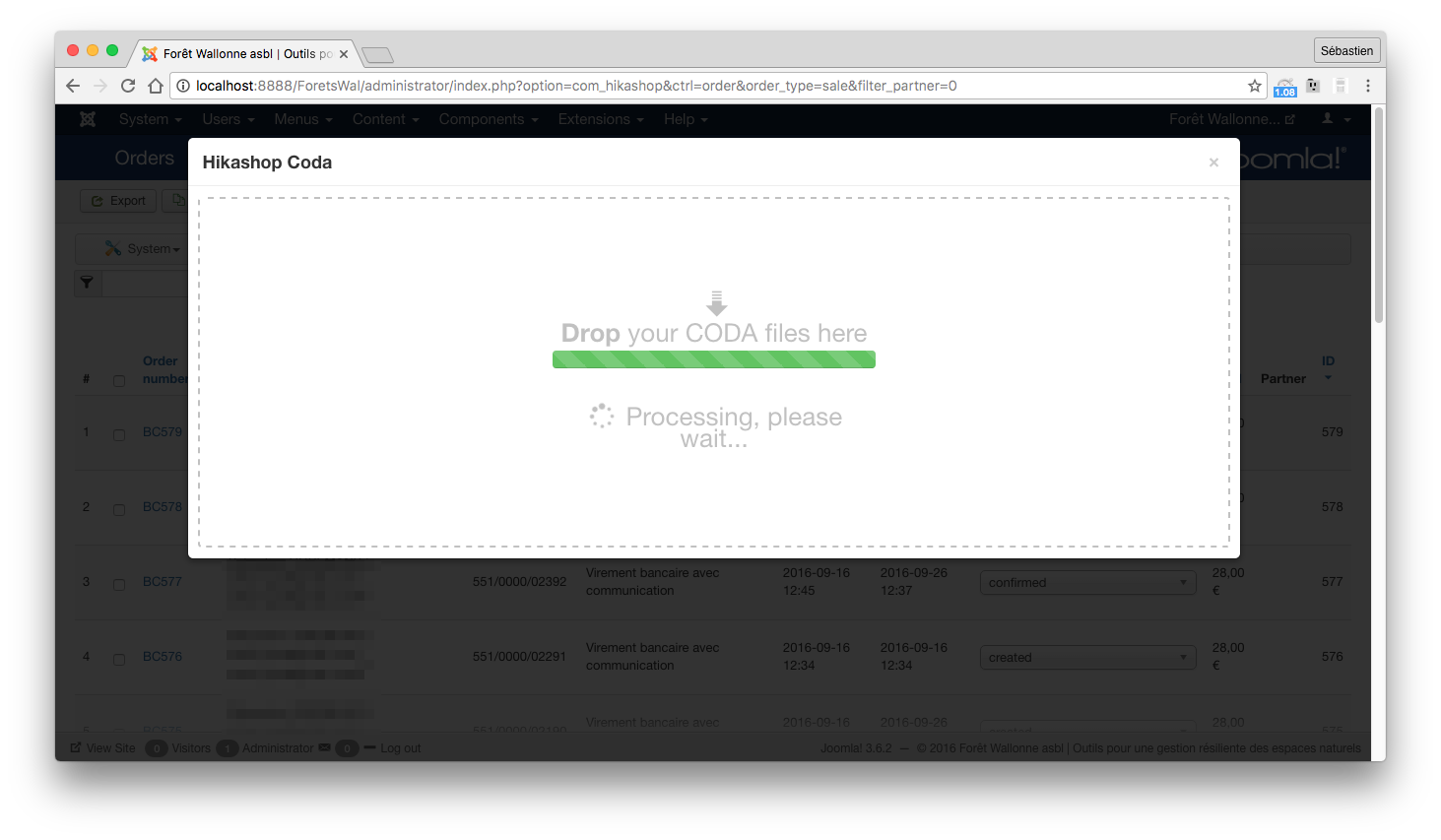

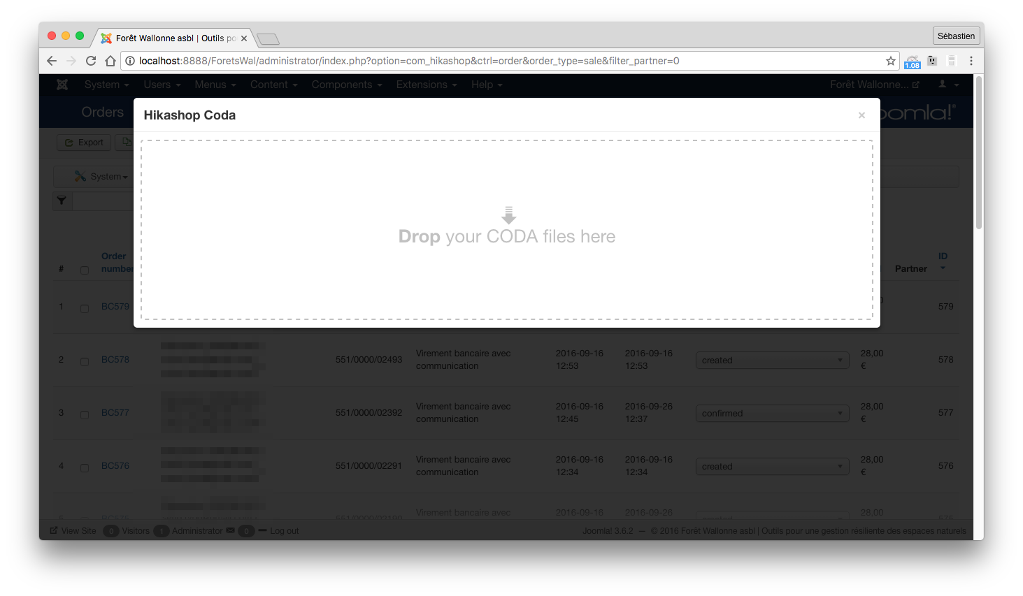

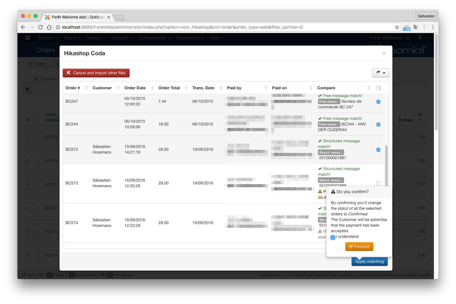

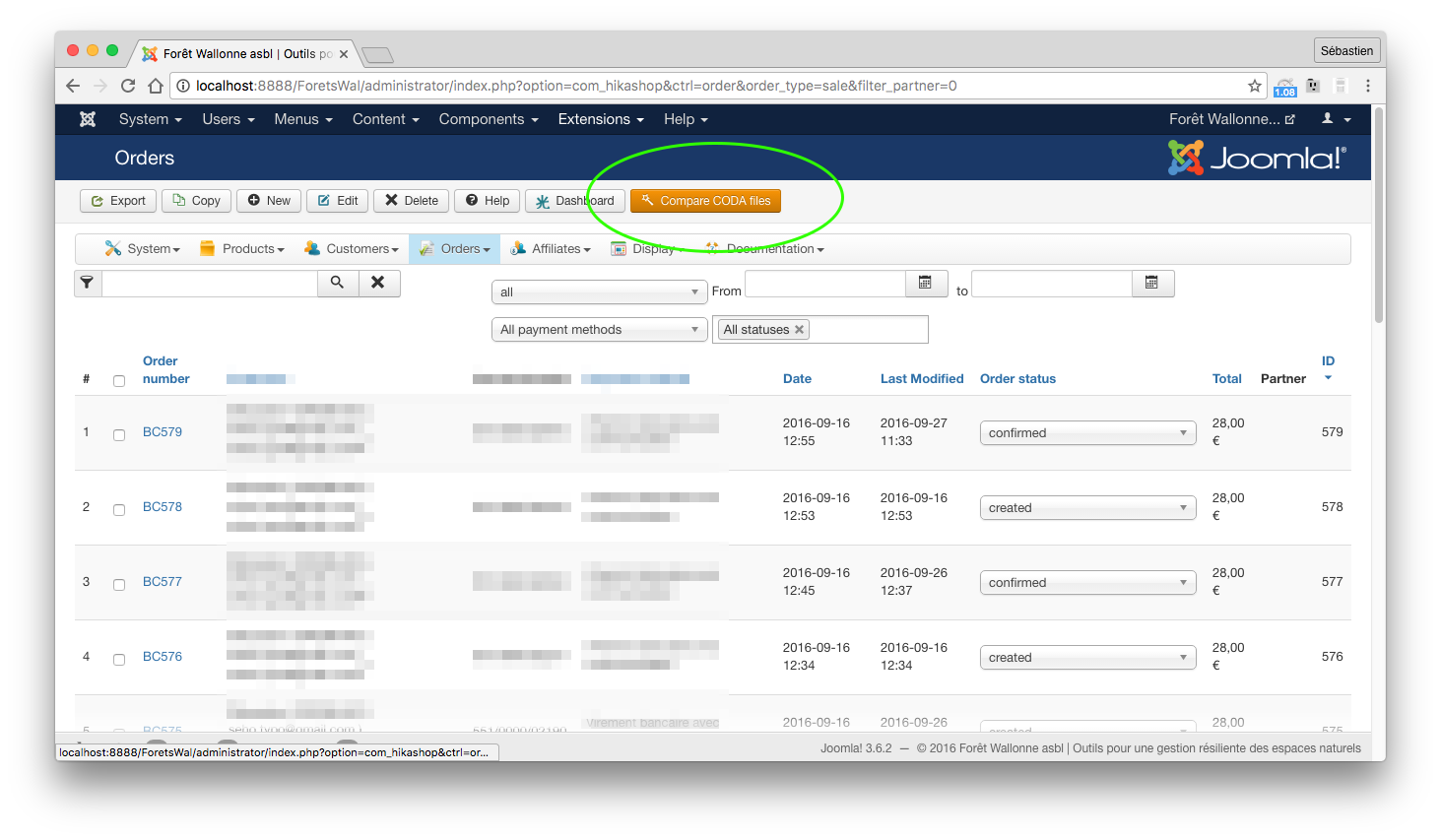

I put some screenshot of my dev for information on attachment
