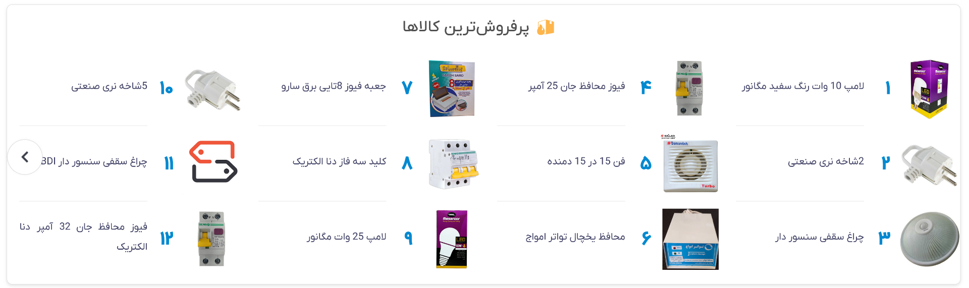

when opening a product through the category listing, everything seems ok, I mean the breadcrumbs display a complete path to the top category and on the product's page there is no module with a module position in the product's top area but when I use the HikaShop Content Module and open a product though the module, breadcrumbs just display "Home/'Product name'" and in the top area of product page I have unwanted module with module position,
what should I do to make a product have the same breadcrumbs as when opened through the category listing?
Thanks in advance
-- Joomla version -- : 5.1.2
-- PHP version -- : 8.1.13
Thanks in advance

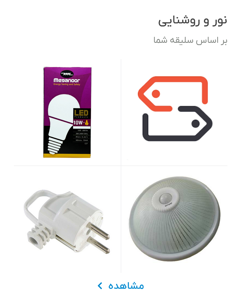

I designed two modules for Hikashop with a custom layout, but I can't add a menu option to them to fix the breadcrumbs issue, is it possible to send them and help me with them?
Thanks in advance

2 years 3 months ago #362346
by diacotm
Replied by diacotm on topic breadcrumbs and module position
2 years 3 months ago #362348
by nicolas
Replied by nicolas on topic breadcrumbs and module position
Well, that's exactly what I was saying in my previous message.
For example, in the file tmpl/default.php of the first module mod_hikashop_2x2productdisplayRev02-Nobreadcrumbs.zip you have the line:
You want to change it to:
where xx is the id of the menu item you want to be used by the module.
Code:
<a class="hphimod4pconrca" href="<?php echo JRoute::_('index.php?option=com_hikashop&ctrl=product&task=show&cid=' . $item->product_id); ?>">
Code:
<a class="hphimod4pconrca" href="<?php echo JRoute::_('index.php?option=com_hikashop&ctrl=product&task=show&cid=' . $item->product_id.'&Itemid=xx'); ?>">
