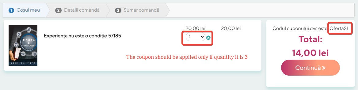

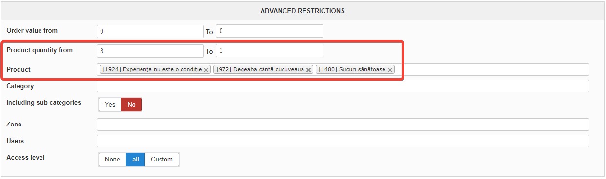

As you can see from my subject, there is a problem when I try to apply a restriction on a coupon based on the "Product quantity from".
This bug affect hikashop 4.6.2 and 4.7.0, same problem on php 7.4 and 8.0.
I have create a coupon that is loaded automatically in cart if the quantity of a specific product it is 3.
But the coupon is applied as soon as I add the product to the cart with quantity 1 and even if the quantity is more than 3 the coupon remains active.

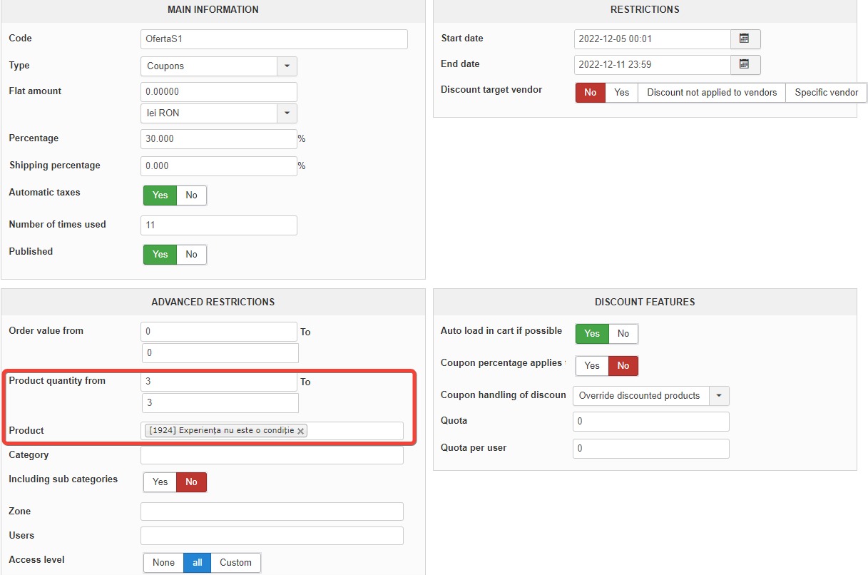

Replied by nicolas on topic Coupon restrictions "Product quantity from" not working
Please activate the "coupon percentage applies " setting of the coupon and try again.

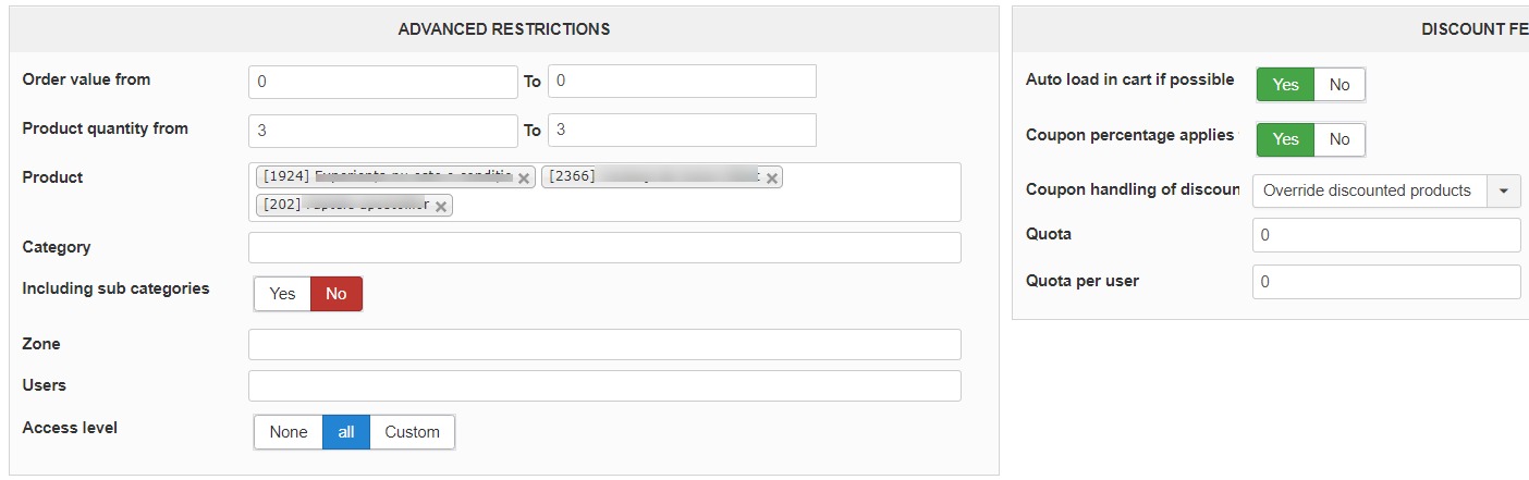

Replied by oxido on topic Coupon restrictions "Product quantity from" not working
Unfortunately, is not working.
That option was activated before, what you saw in my first screenshot it was after I've tried to fix it.
I did what you said anyway, just to be sure, but is not working.

by nicolas
Thank you for the extra details. I was able to reproduce the issue locally and added a patch on our end.
Download again the install package of the 4.7.0 on our website and install it on yours and you'll get the patch for that issue.
