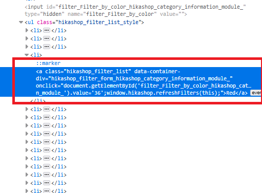

2. Using Filter type list. Now if one of this filter values are selected there is no indication for that value that it is selected. Would be great to have some class here like "filter_selected" or something. So we could make some css styling for it. Small change but very useful!
Also it would be great if you could select more filters not only one...while using filter type list.

1. I don't think adding a reset / filter button for all the filters make sense. You already have the submit on click for that. I guess it only makes sense when you want to allow the user to select several things in the filter and this only apply to checkbox and multiple select filters. So adding this for them could be interesting.
2. That's a good idea yes.
