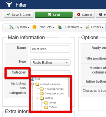

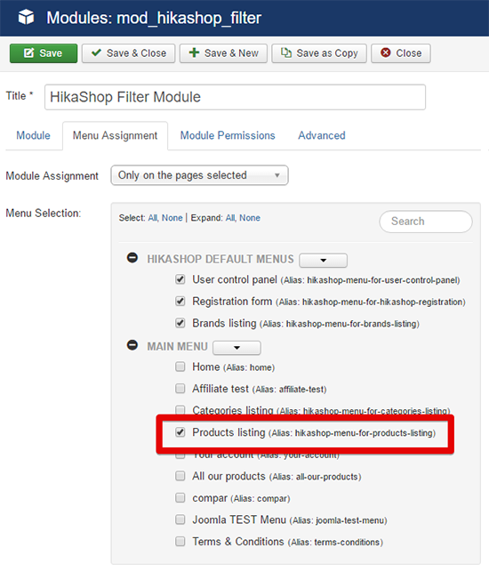

9 years 8 months ago - 9 years 8 months ago #261190 by Philip
I think I get it, you want a filter that only process visible products on the visible listing, right ?
So, if yes, follow this different points:
First in your filter backend edition:
See, the Category that will limited the search only in this specific category.

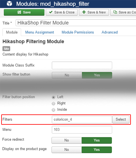

Second step, Use a module with Menu Assignment like on this screenshot and select your required Filter:
And so here, this module will only display ONLY on the required products listing.
You have just to repeat this kind of configuratoion for each listing.
Note: The limit to this way to proceed is that you have to use a Module in order to restrict his display on the required listing.
Maybe you have to select a good position for your module and some Css to have your filter IN your listing.
Hope this will fit your needs.

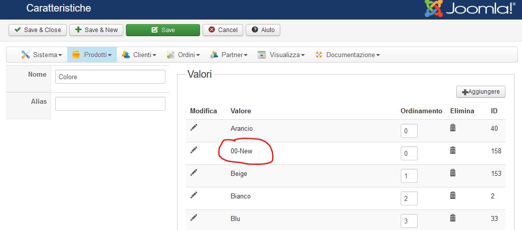

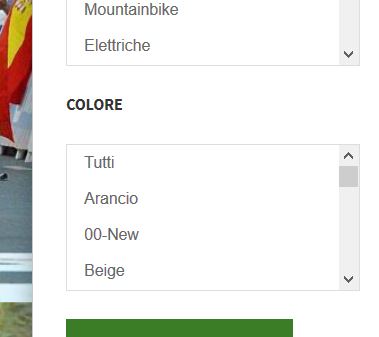

9 years 7 months ago #263415 by simtheo
Hi.
I'm sorry but it doesn't work: my filters show also the characteristics not associated with any product.
I made a test: I create a new color called 00-NEW. This color, obviusly, is doesn't associated with any product: I expect not to see its. But it doesn't happen: I see it inside my color filter list.
This is my site configuration:

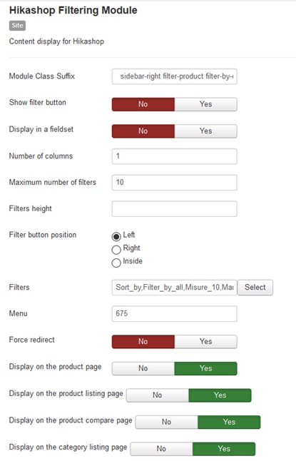

- IMAGE 1: my HIKASHOP filter module configuration. I set the MENU parameter with the menu id where is possible to see the filter

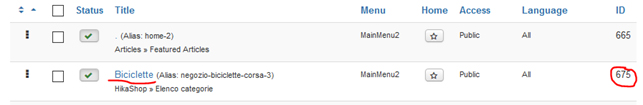

- IMAGE 2: the menu item where is shown the filter module, on the left side of the page. In this page, is possible to see the product of category BICICLETTE
- I associated the characteristic COLORE to this product category

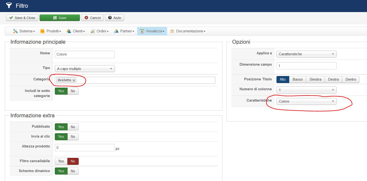

- IMAGE 3: the filter configuration. I create a filter called COLORE (=color in english); I set the category BICICLETTE, the same of the menu; the characteristic associated is COLORE (parameter on the right of the image), I included the subcategory;
- IMAGE 4: the characteristic COLORE, where is possible to see the test value 00-NEW
- IMAGE 5: the hikashop filter, that doesn't limit the list with only filters value associated with one product at least. You can see the value 00-NEW, that it doesn't associated to any product.

9 years 7 months ago #264036 by nicolas
The issue is that you customized the "filter" file of the view "product" and commented out the line:
$datas=$this->filterClass->getProductList($this, $filters);
It's this line which allows the filters system to activate the "dynamic display" of the filters and display only the values used in the products of the listing. If you uncomment that line, it will display like it should.

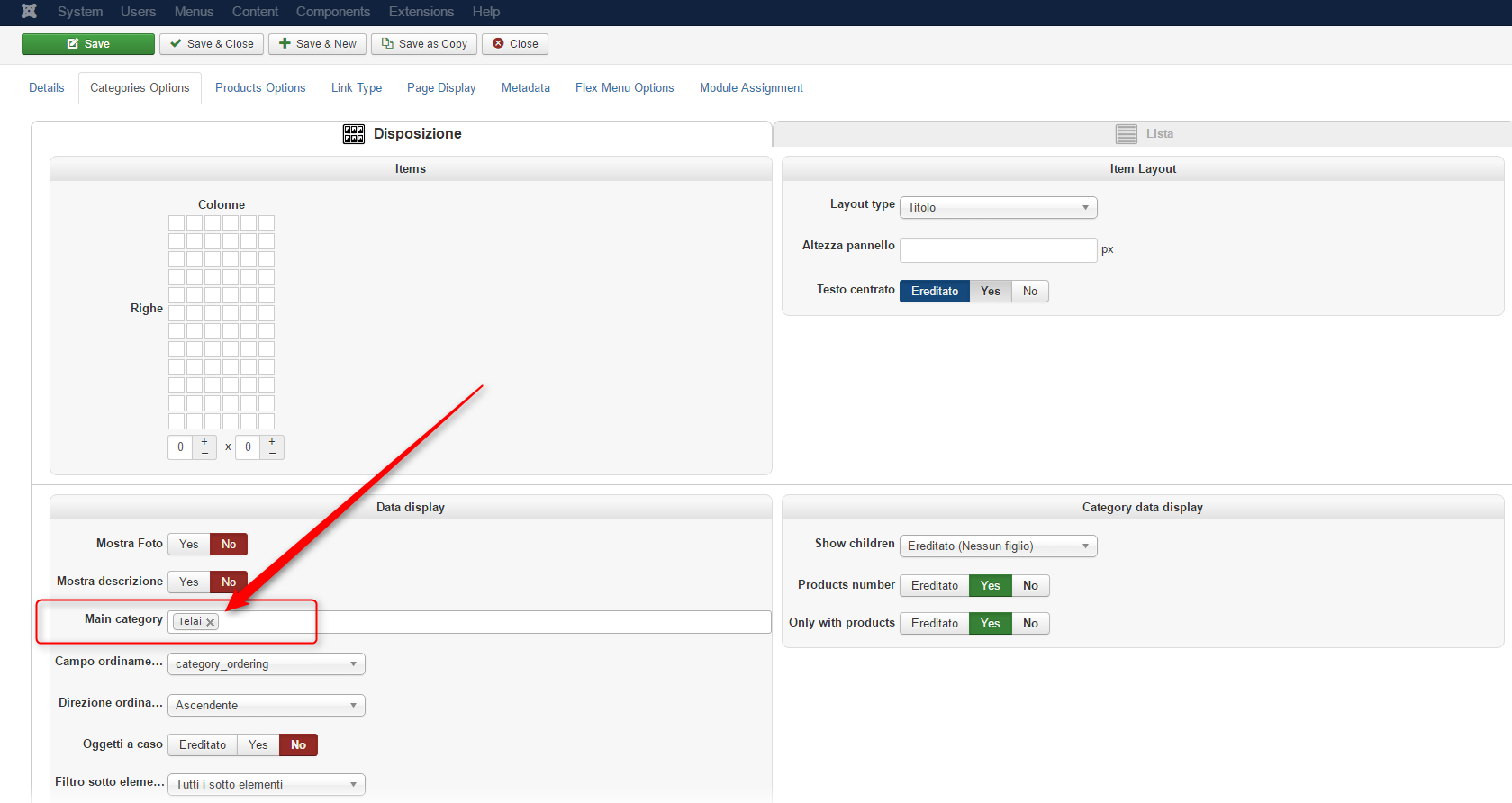

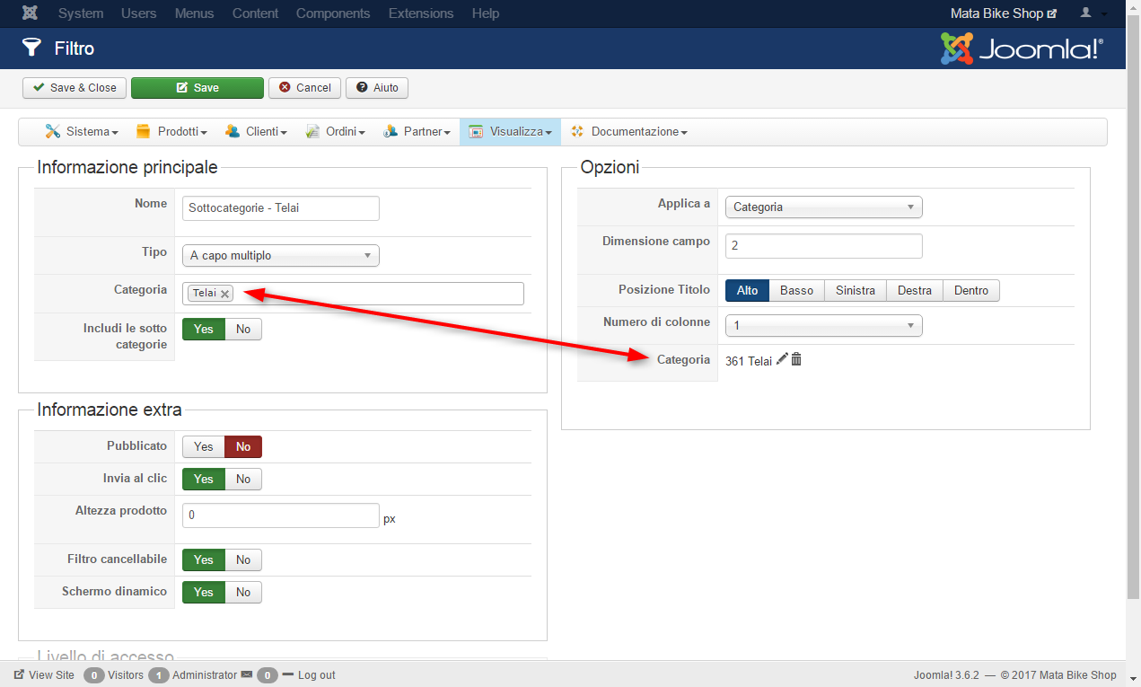

9 years 7 months ago - 9 years 7 months ago #264104 by simtheo
It works ... incredibile !!! Really thank you !!!
Characteristic filters work correctly but now I have problems with CATEGORY filters, insiede the same filters structure: probably there are another template customization that crash the system.
Could you make another check?

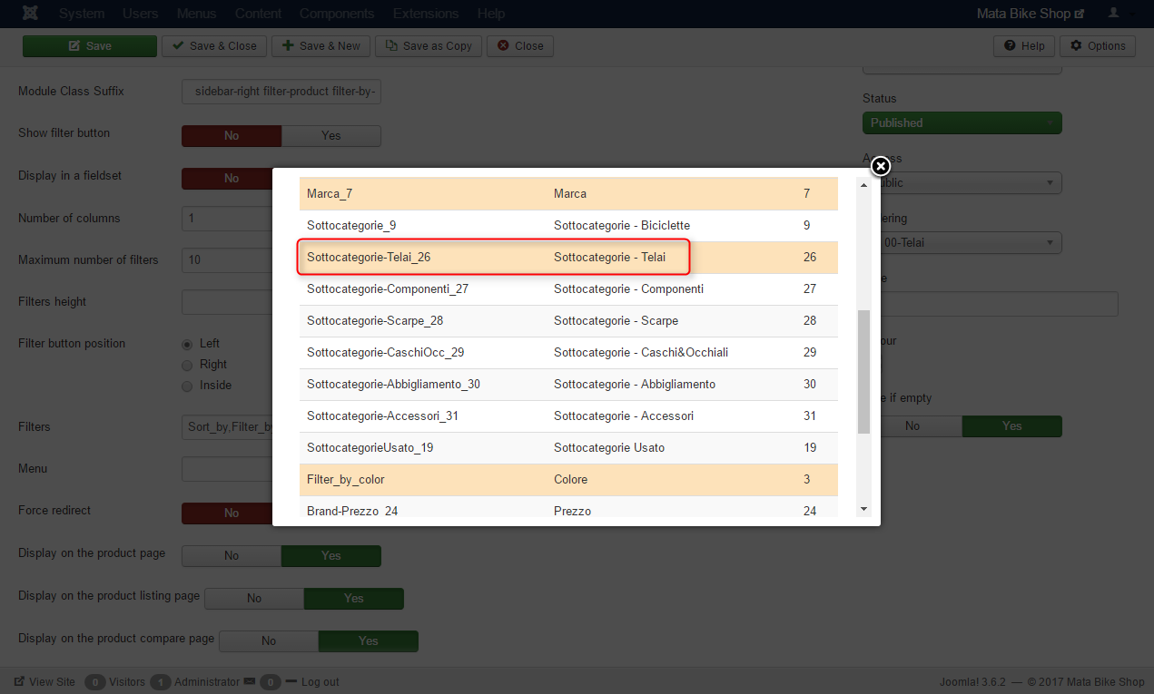

I attached three images:
- one about the filter configuration, where you can see where I selected TELAI category;
- one about the selection filter into module filter.
- one about the category menu
The filter configuration is correct?
Considers that I would create ONE filter for every category menu; for this reason, into filter configuration, I selected the main category. I expect to see, in the filter, the list of subcategory of the corresponding category menu page.

9 years 7 months ago #264282 by nicolas
The settings look fine.
