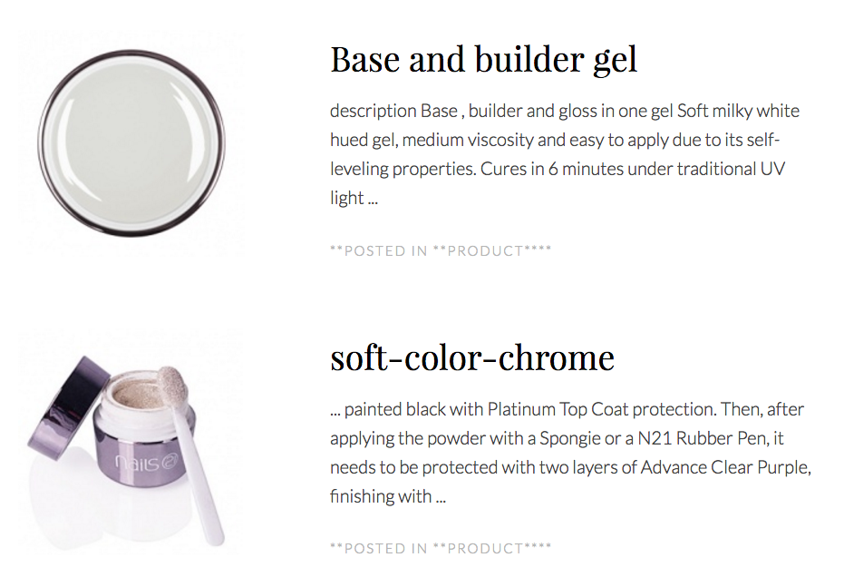

In our site ( www.nails21.com/en/search ) if we search products, with English Language Selected (it only happens when english is selected), the search results appears with some products, with the title value of a custom field or from the alias field, instead of the name of the product.
We have a local version, and "debugged" it, but the behaviour doesn't happen in localhost..
Does this seems familiar to you?
Try to search "Advance" word when on English language, and the results will be something like the attachment.
When it should be only the Product Name that should appear and not 'soft-color-chrome' that's the alias but the 'Convert colors into chrome/mirror' name.
Thanks,
AllBS

So, our hikashop products search plugin is configured to search in these fields "product_name,product_description".
And after debug, the following query is executed:
SELECT DISTINCT a.product_id AS id, a.product_name, a.product_alias, a.product_canonical, a.product_created AS created ,
a.product_description, "1" AS browsernav, a.product_type, a.product_parent_id, b.category_id as category_id
FROM q5sod_hikashop_product AS a
INNER JOIN q5sod_hikashop_product_category AS b ON a.product_parent_id=b.product_id OR a.product_id=b.product_id
WHERE a.product_published=1 AND (a.product_access = 'all' OR a.product_access LIKE '%,9,%')
AND b.category_id IN (2,67,68,69,......)
AND ((((a.product_name LIKE '%advance%'))) OR (((a.product_description LIKE '%advance%'))) OR (((a.product_code LIKE '%advance%'))))
GROUP BY (a.product_id) ORDER BY a.product_modified DESC
Then on hikashop products plugin, this code is executed:
$row->title=$row->product_name;
But somehow, on the live site the "title" on the search page has that 'soft-color-chrome' when the product name is "SOFT MIRROR POWDER / COLOR CHROME".
We don't know where that "alias" comes from.. and it's not even the alias of that specific product that's "soft-mirror-powder-color-chrome".
It's a very strange issue.
We even thought it could be because of Falang, but after analysis it doesn't seem to be..
What could this be? Do you need access to our backoffice to check it out?
Thanks.
Best regards,
AllBS

9 years 5 months ago #265943
It's easy to check if it comes from your translations or not.
Disable the Falang system plugin via the Joomla plugins manager and try the search again.
If the product name appears correctly with Falang deactivated, then it means that the text you see comes from the translation of the product name that you have in Falang.
Looking at the code of the plugin, I might actually have an idea.
Try changing the code:
							if($item->reference_field=='product_name'){
								$row->product_name=$item->value;
							}elseif($item->reference_field=='product_description'){
								$row->product_description=$item->value;
							}else{
							break;
to:
								break;
								break;
							}else{
and it might help prevent that.

9 years 5 months ago #266035
once again, great help :) you pointed to the right direction.
The solution was to take the entire final else:
	break;
	break;
} //else{
//	$row->product_name=$item->value;
//break;
Because we have more than just the product_name and product_description translated. In fact it was the product_alias field, that was showing in the translated Product Title (the last translated field).
Now it shows fine the name of the products :)
Thank you very much.
AllBS
Last edit: 9 years 5 months ago by Jerome. Reason: [code] is nice
  • Posts: 86217
  • Thank you received: 14222
9 years 5 months ago #266048
Then try like that:
								break;
							}else{
we need to keep the line $row->product_name=$item->value; as we want to have the matching value replacing the product name on the listing when a match is found on something else than the product_name and that the product_name itself doesn't match.
