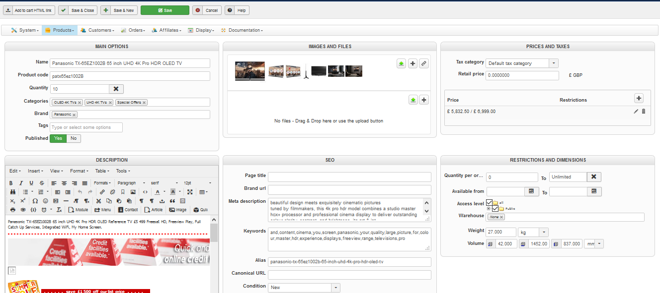

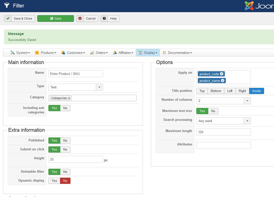

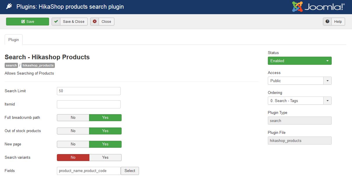

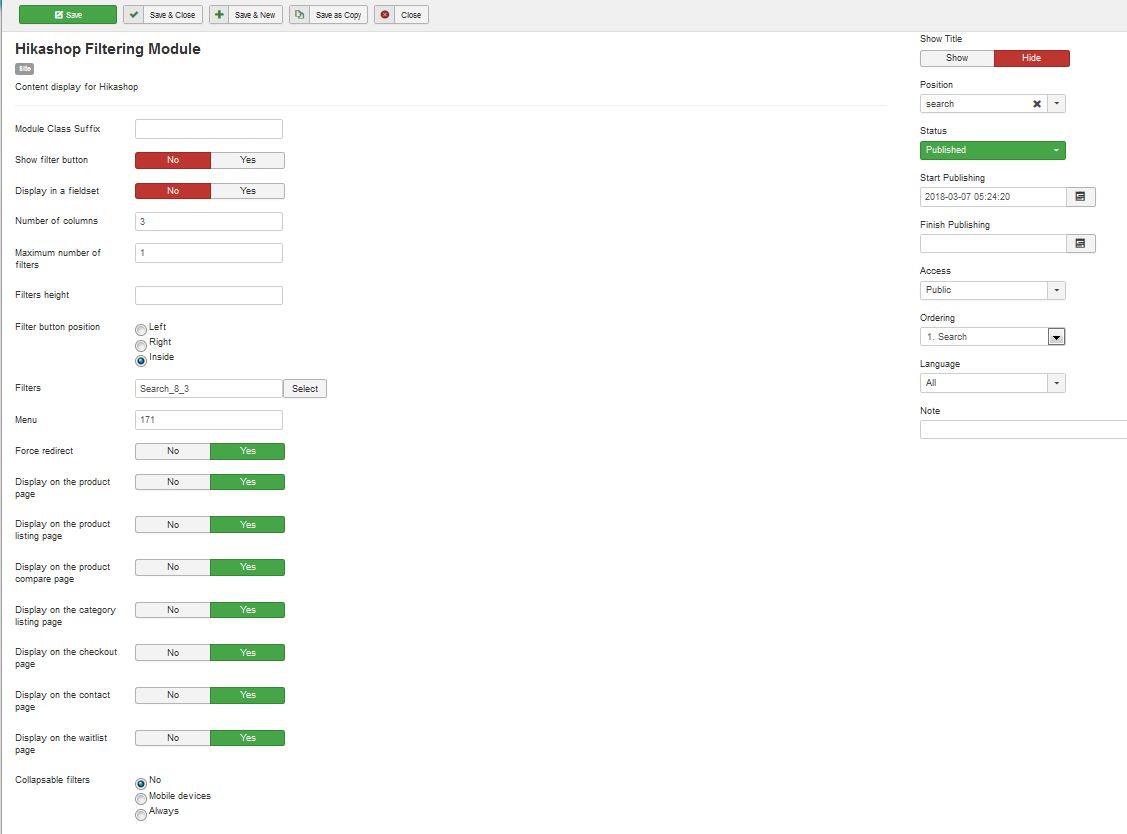

Hello, I'm having issues with my search. I've configured it to search on the product name and sku, but when I cut n paste the full product name into my search bar, it finds nothing. I also can't get the product code search to work either. It does return basic search results i.e. if I type in part of the product name - very odd!
I've attached my config screens
-- Joomla version -- : 3.8.12
-- PHP version -- : 7.1

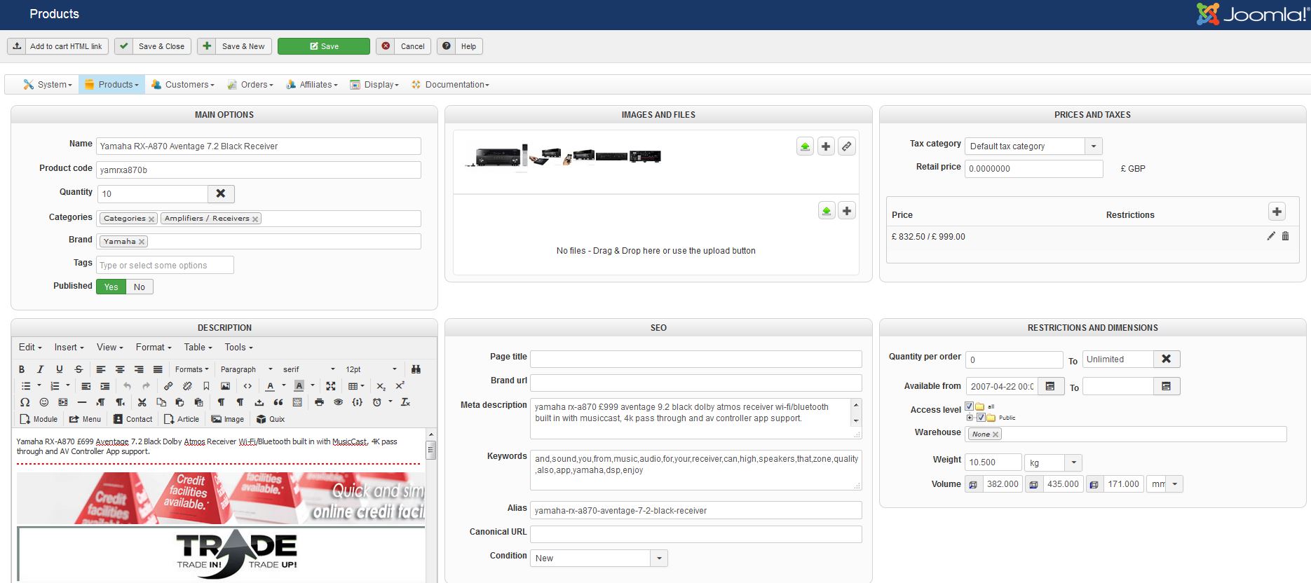

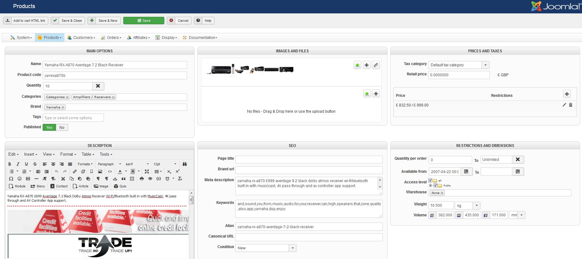

Here's an example ... Yamaha RX-A870 Aventage 7.2 Black Receiver returns a page of assorted products including other yamaha products but not the one I searched for?
Here's the config for that product.I thought it might be the canonical urls as I changed the menu heading recently but none of my products have them.

I do see that product at the end of the first page of results when searching for its name:
monosnap.com/file/dfwOL43R0lXId4shbm1BvLVOCI5zOB
And it's normal that you have the other products there since you've configured your filter's "search processing" setting to "any word".
So if you search for "Yamaha RX-A680 Aventage 7.2 Black Receiver" all the products with at least one of these words will show up in the results.

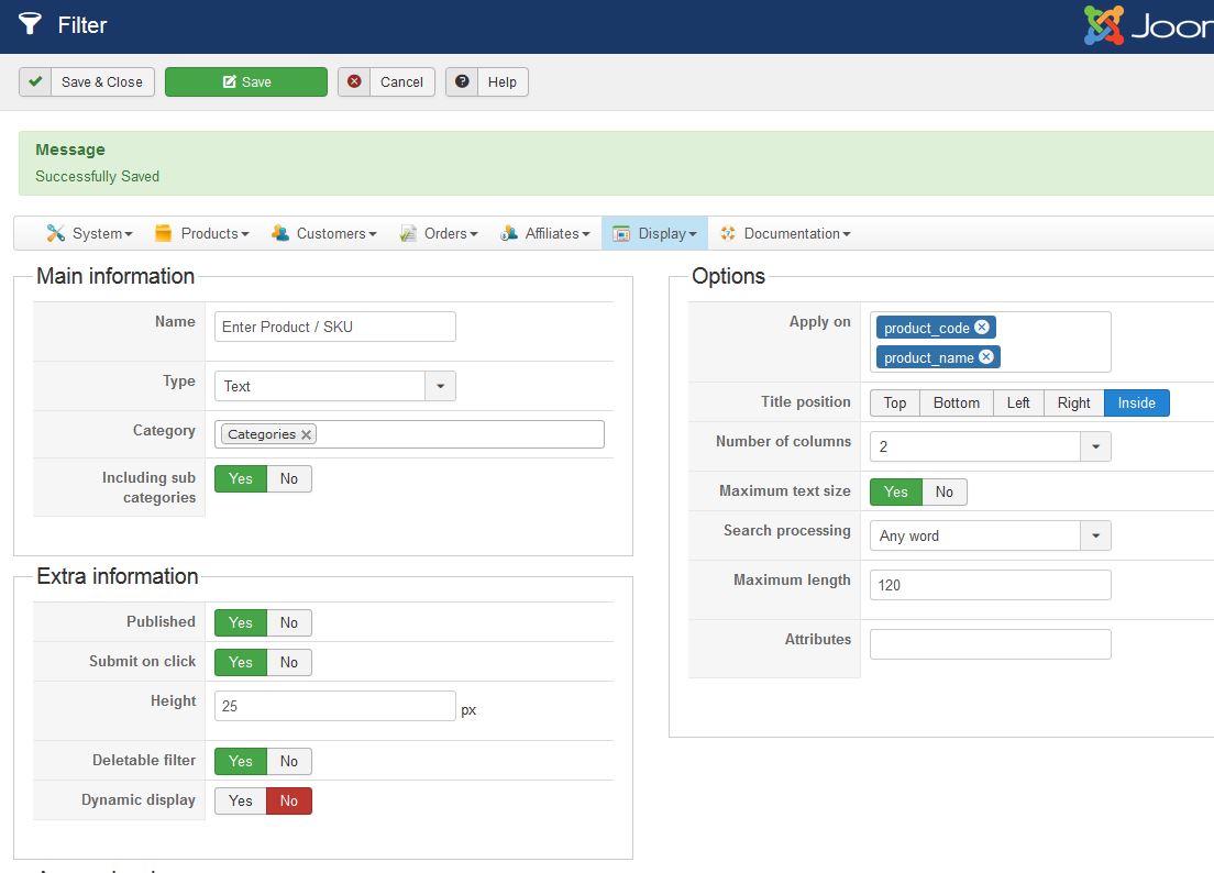

When you're looking at that page without any filter:
test.leconcepts.com/search
you get a listing of 115 products. So it's supposed to be all the products of your shop.
And the filters will search among these products.
However, that product doesn't appear there:
monosnap.com/file/npwPRPDBDGCsas2vKmbYuSt8zwFrt3
So that's why you can't search for that product.
In the menu item "search", you need to configure it to display a listing of all the products of your shop if you want the filters to apply on all of them.
So you need to check the settings of that menu item via the Joomla menu manager.
