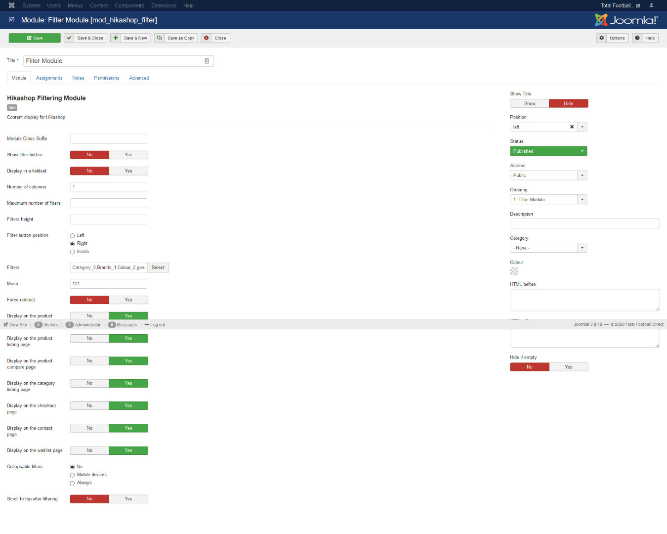

Ok It seems the issue is SEF and then the fact there is two filters on one page.
If I turn the search filter at the top of the page off the side filter works.

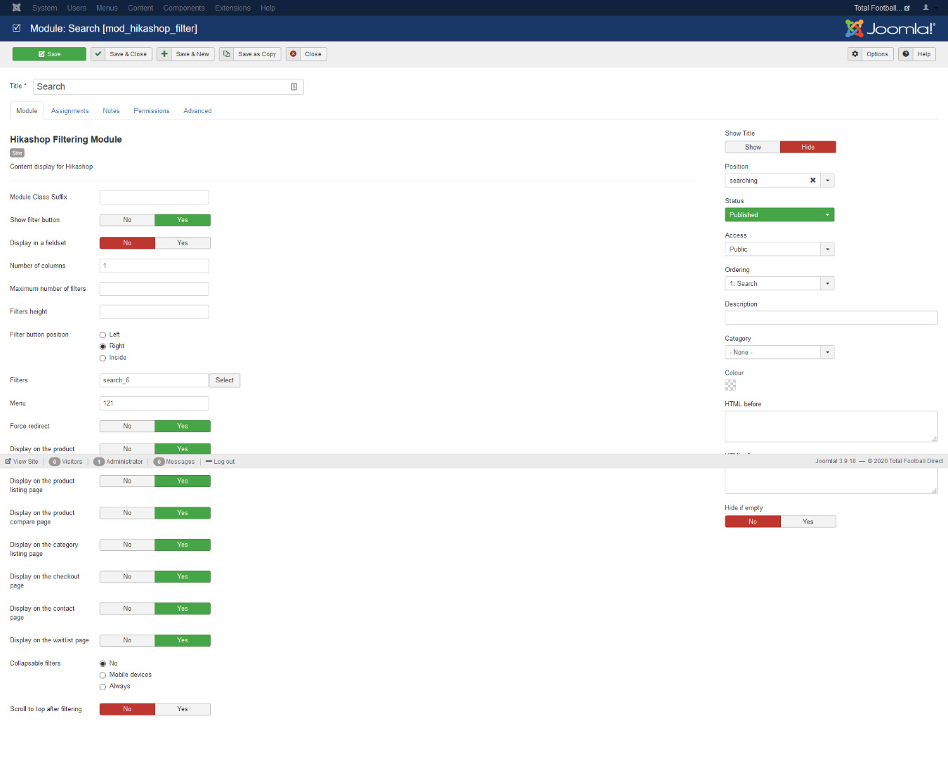

I have found a fix. In sh404sef please slect Automatic redirection fo none sef urls to sef urls.

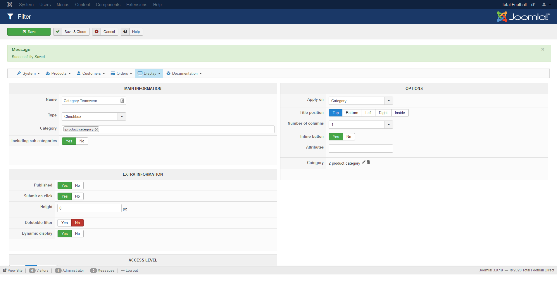

I have another issue. Plese see setting for category filter attached.
if setup was
Cat 1
Sub cat 1
Sub cat 2
Cat 2
Sub cat 1
Then we navigated to Cat 1 I would expect Sub cat 1 and 2 to display in the filter? This is not happening - I can't even describe what its showing its odd.
Do I have the settings wrong? How would I achieve this?
if setup was
Cat 1
Sub cat 1
Sub cat 2
Cat 2
Sub cat 1

6 years 6 months ago #318927
by Mohamed Thelji
Replied by Mohamed Thelji on topic Filter Issue with SH404SEF
I think you filter information were not properly used.
The "Category" option from the "Main information" tab is used to only display this filter field on pages of that category, and the "Including sub categories" option is used to also display it on these sub categories.
The "Category" option from the "Options" tab is used to control which categories to display.
Kind regards,
Mohamed.
Kind regards,
Mohamed.
