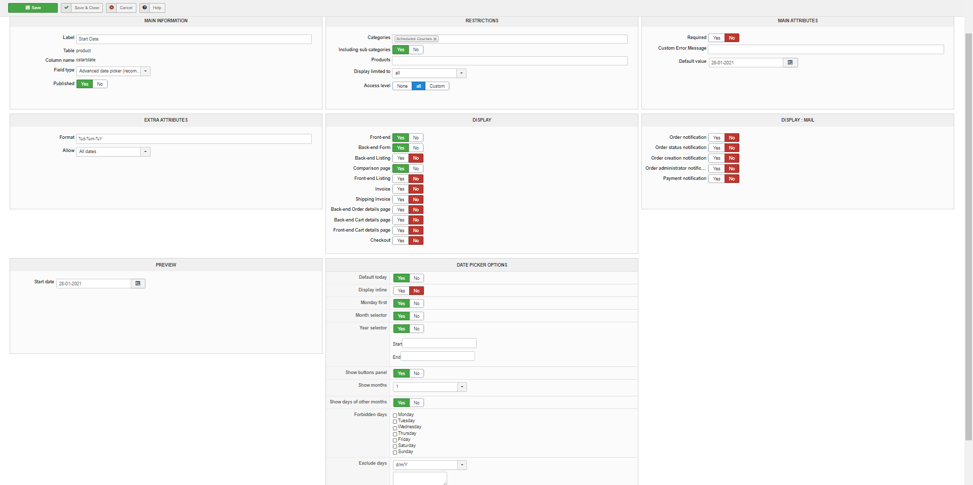

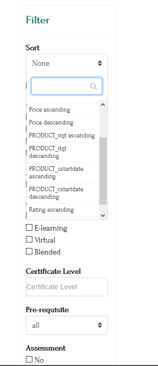

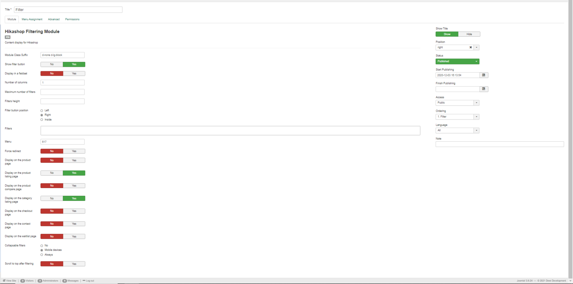

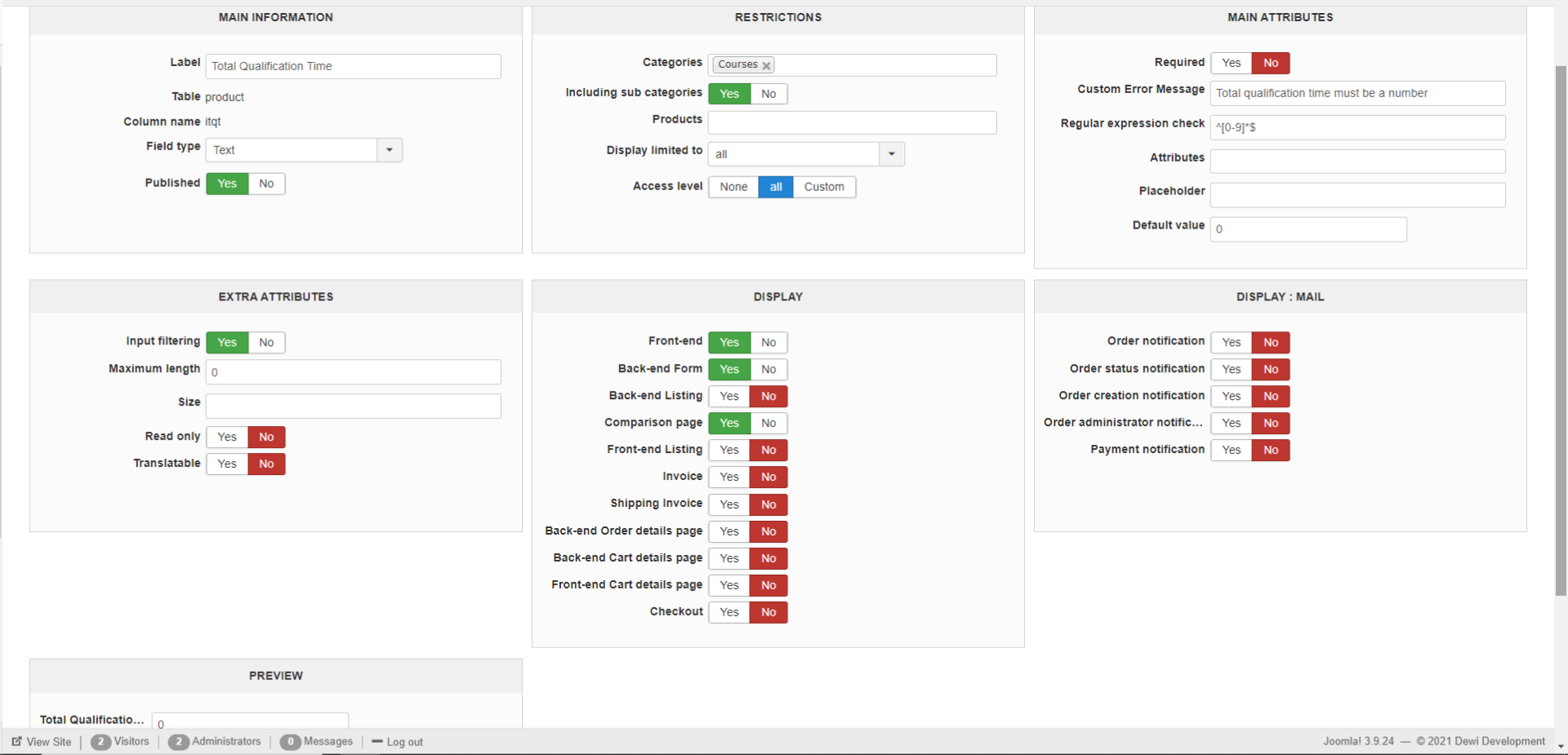

I have setup a number of custom fields and I have linked a number of them to the sort in the filter
The custom fields do not display custom field text, but the table, code and sort order.
Please see screen shots attached of the error, the setup of the fields and the setup of the filter module.
Please advise how to resolve.
Thank you

Thank you for the details on the issue. I was able to reproduce the issue.
The sort filters on custom fields limited to products or categories would not display the field name properly in the filter.
I've added a patch on this on our end.
Download again the install package of HikaShop on our website and install it on yours and it will add the patch, which will fix the problem.
