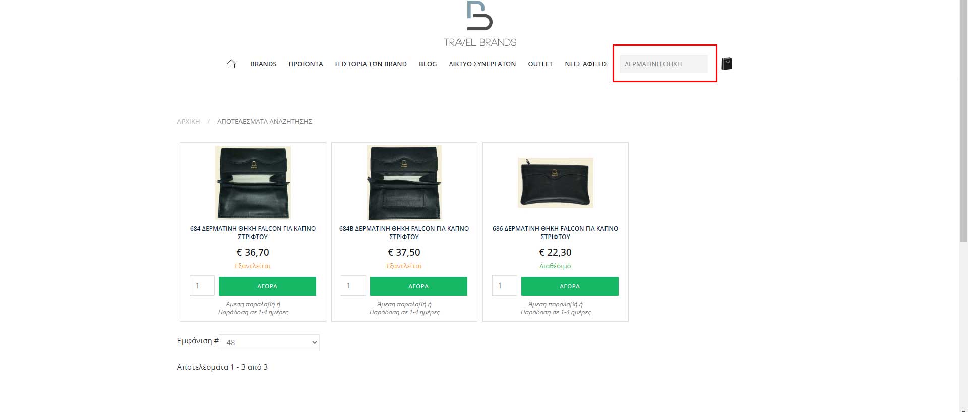

Hi!
No. i meant when you search from search field the filters disappear.

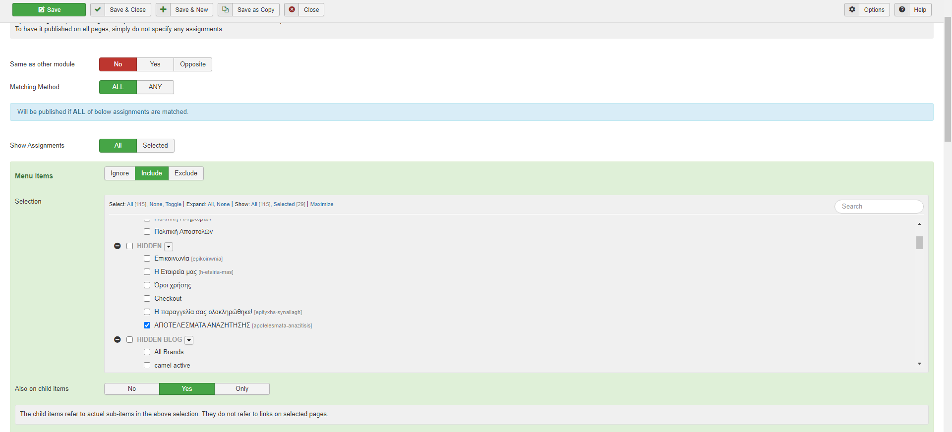

Hi!
I have assigned "apotelesmata-anazitisis" to the sidebar filter module but still does not show up.

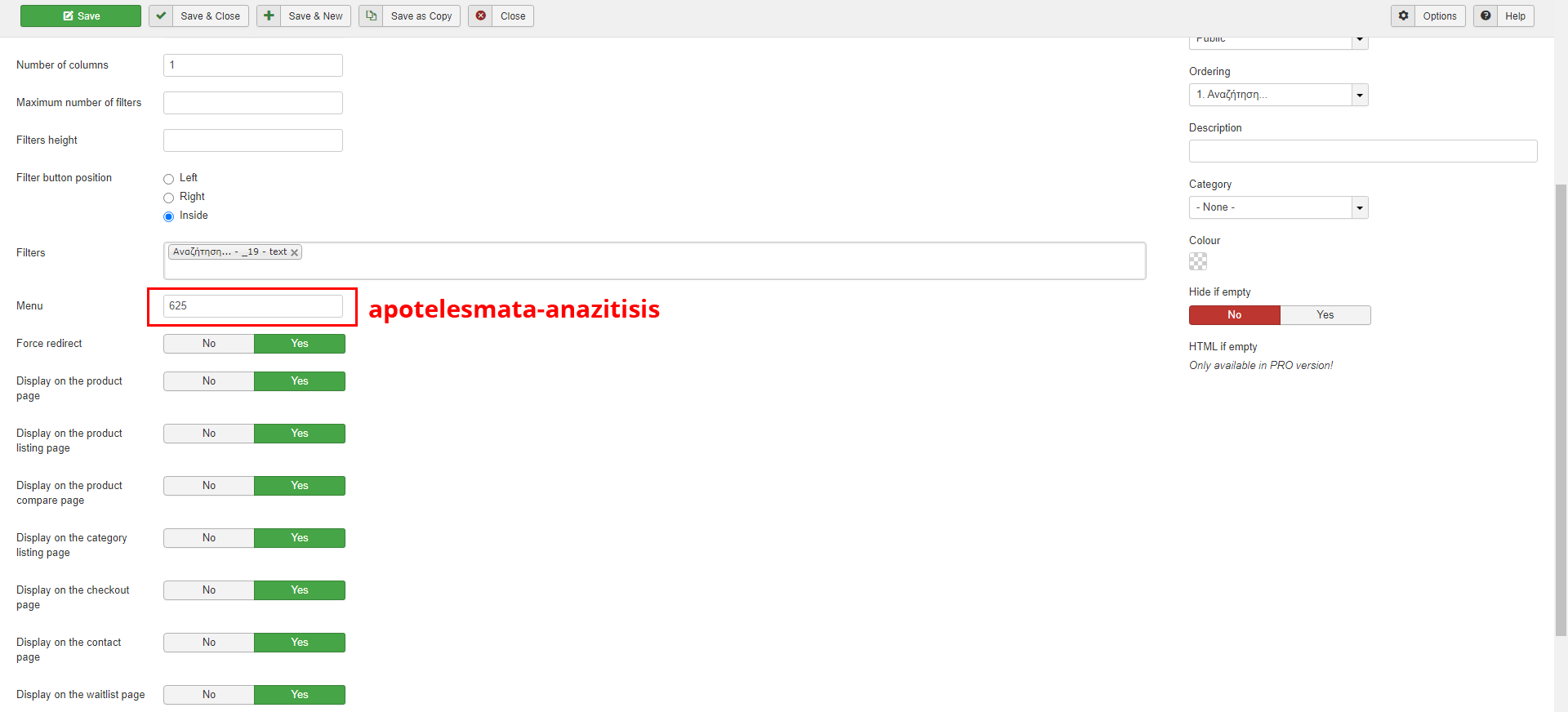

In sidebar filter module i have entered the menu id (apotelesmata-anazitisis) that is product listing diplaying all elements.
