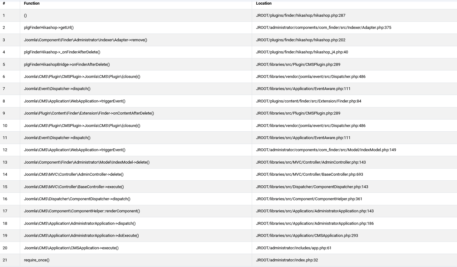

I just updated to the lastest version. I wanted to delete the index but I have a new issue, I can't delete it, it returns an error "Call to undefined function hikashop_get() "
Sandra

Please activate the "debug" setting of the Joomla configuration and try again. It should display an error message with more information which should help us to better understand what's going on.

Hope it can help

Thanks !
Add the line:
$this->setup();
before the line:
parent::__construct($subject, $config);
in the file plugins/finder/hikashop/hikashop_j4.php and it should fix the problem.
We'll add the patch on our end too.
