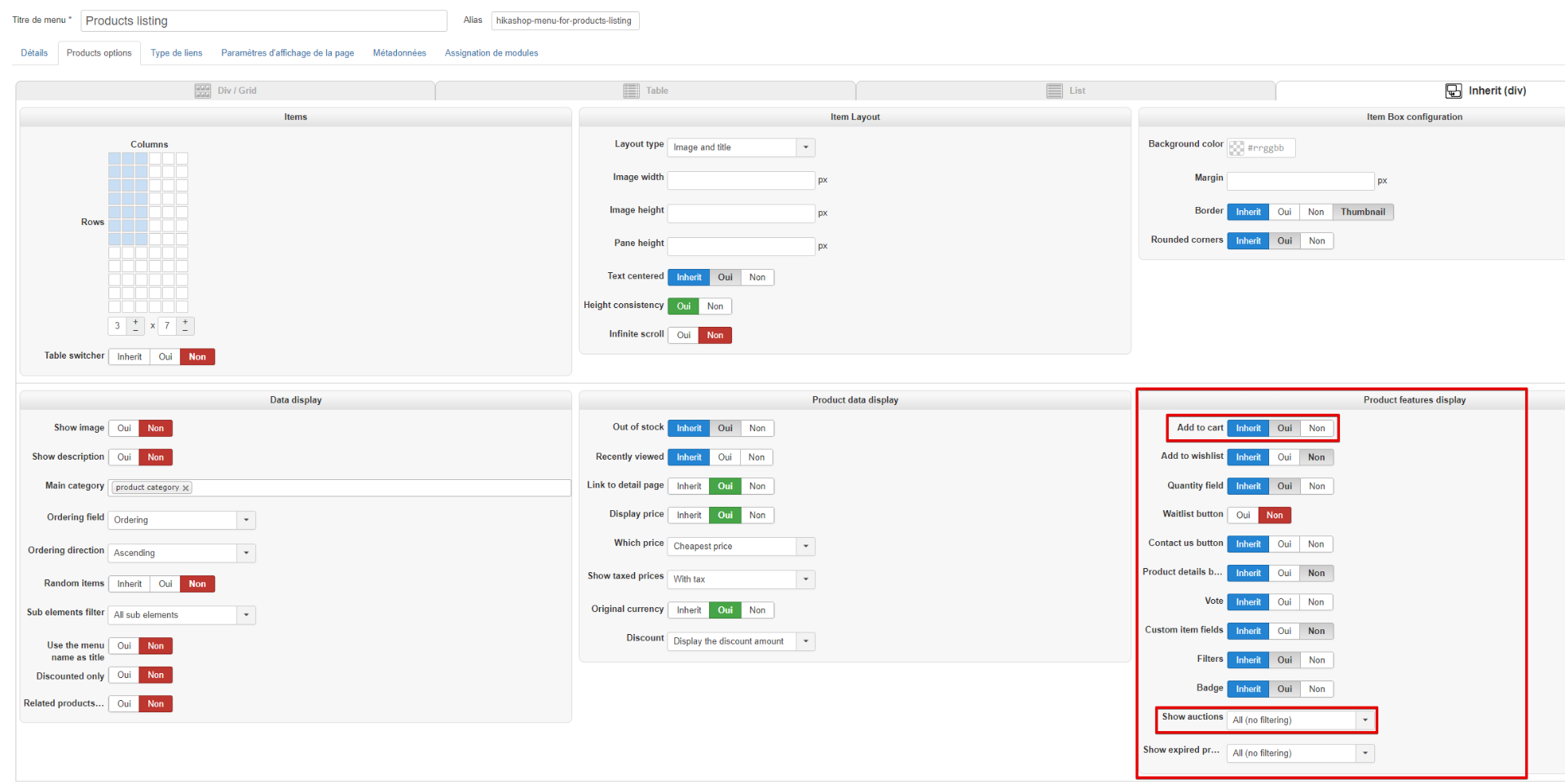

10 years 5 months ago #236313 by Mohamed Thelji
Hello Lene,
If you want to remove it through your product listings, a solution can be to use separate auctions and products listing by using the "Show auctions" / "Add to cart" options of your product listing content menu/module configuration page.

5 years 8 months ago - 5 years 8 months ago #329057 by Mohamed Thelji
You'll find these option through your product listing's content menu configuration page. I attached a screenshot for more information.

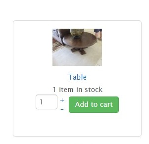

5 years 8 months ago - 5 years 8 months ago #329162 by ddevine
Alright, I found it and applied that too, BUT the "Add to Cart" Button shows up when
bidding is made.
If I can't remove the button, can I change the text in the button? I would rather have it
say "Items with Bids" or something more relevant.
Thank you

5 years 8 months ago #329246 by Mohamed Thelji
What you need to do is :
- Edit the Joomla content menu which have the ID 841
- Go to the "Product options" tab
- Set the add to cart to NO
If you're still having that issue, can you send us a temporary access to your back-end using our contact form so that we can directly test it ? Thank you :
Please don't forget to add a link to that thread in your message.
Kind regards,
Mohamed.

5 years 8 months ago #329333 by ddevine
Great, that was annoying and confusing for several people. Is there a way to display something like
"add to bidding" so that it shows up when someone has bid on an item.
I liked the fact that it did show which ones had a bid, but i don't want it to say "add to cart", but only
for items that have been bid one
