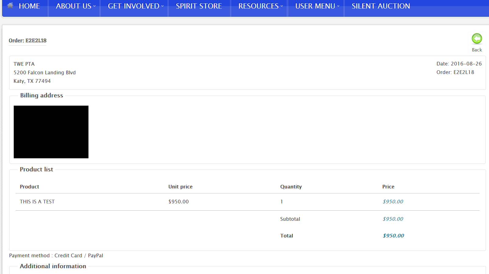

I select proceed to checkout, then I see a list of orders (previous orders as well as the new auction w/"created" status). I click on the auction item and am taken to the details of the order.
How can I make it so the user is directed to payment page? Thank you for your support!

10 years 1 month ago #248612
by mduda
Replied by mduda on topic How to get to payment page?
Solved!
I didn't realize that the config was not setup for unpaid order statuses. Just added "created", and all is fixed

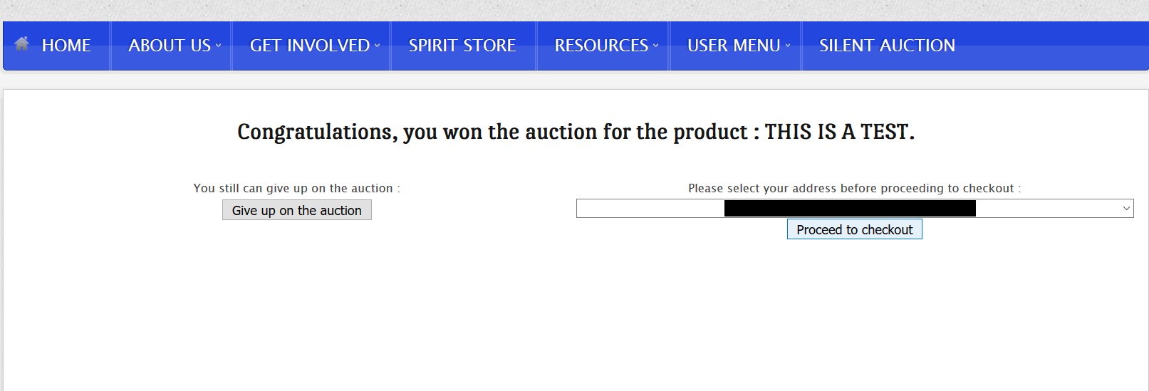

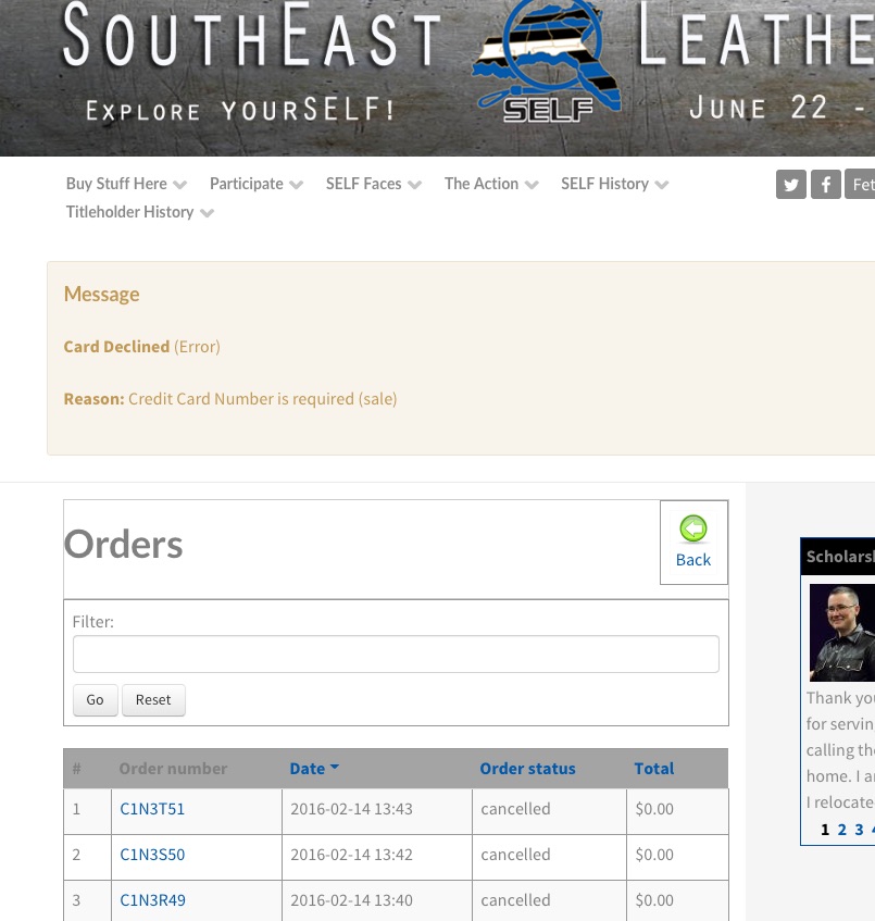

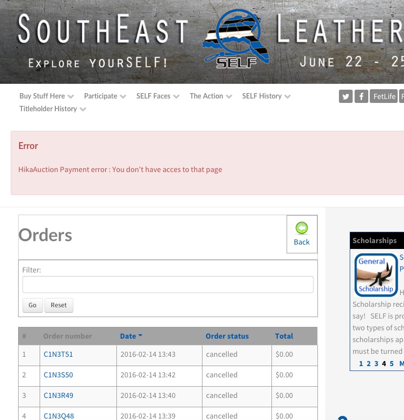

I'm having a similar issue. I click the link provided in the email and end up with this. Please see screen shot 1 & 2. I am logged in and link goes to screen shot 1. When I click and go to screen shot 2, I haven't been asked for a credit card. The auction doesn't appear in my account history either. The winner appears in the history of the auction but not in the user account or the user order list.

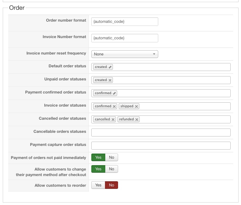

Can you give us more information about your configuration order configuration via "Hikashop->System->Configuration->Main->'Order'" through some screenshots for example ?
Also, can you tell me which payment method you're using on your shop and if you have enabled the Hikashop "Payment of orders not paid immediately"* option via "Hikashop->System->Configuration->Main" ?

Yes, winners account is logged in. Payment of orders not paid immediately is enabled. Payment method is USAePay Plugin. See screenshot.
