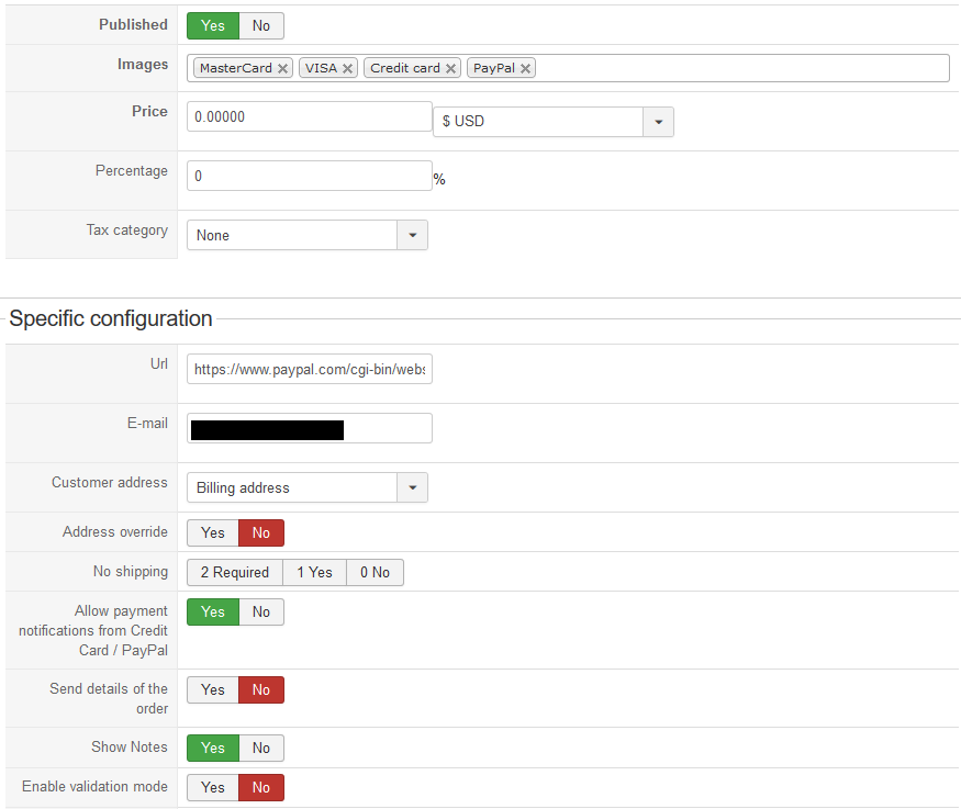

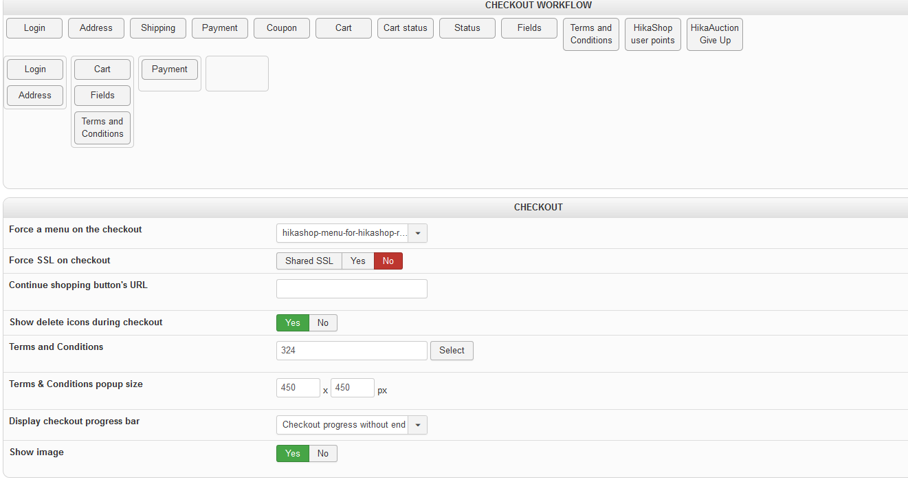

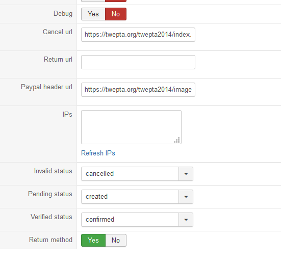

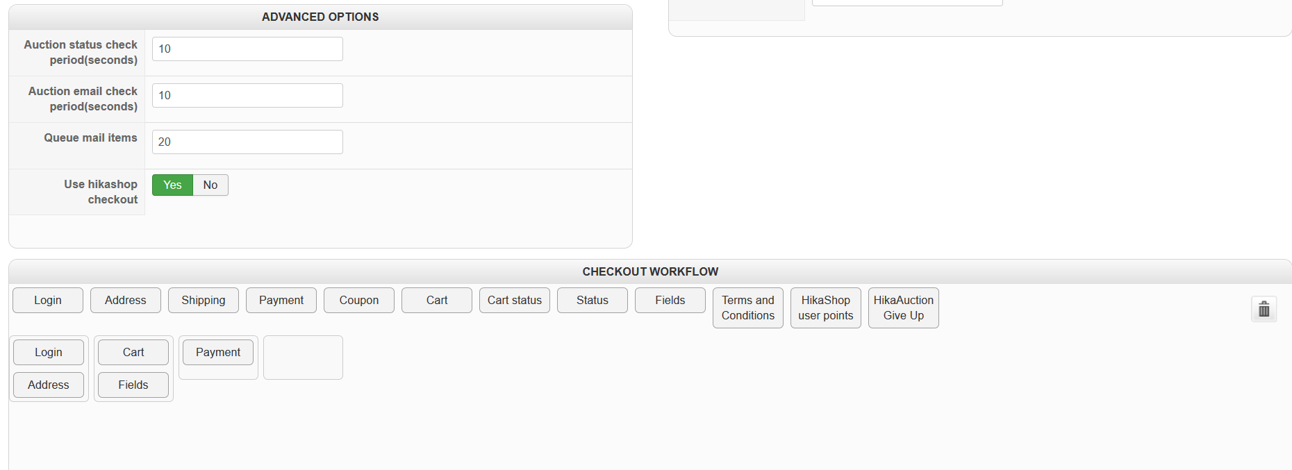

As I said through my last message, we'll more information through some screenshots about how you configured :
- Your Hikashop checkout workflow via "Hikashop->System->Configuration->Checkout"
- Your HikaAuction checkout workflow via "HikaAuction->Configuration"
- Your PayPal payment method via "Hikashop->System->Payment methods"
Thank you.

8 years 11 months ago #280950
by mduda
Replied by mduda on topic Payment Not Redirecting

8 years 11 months ago #280978
by Mohamed Thelji
Replied by Mohamed Thelji on topic Payment Not Redirecting
Thanks for these information.
We'll try to reproduce it on our end and fix it but the "Return URL" option of your PayPal payment method is only supposed to affect where your customers will be redirected after paying for their order through PayPal platform.
