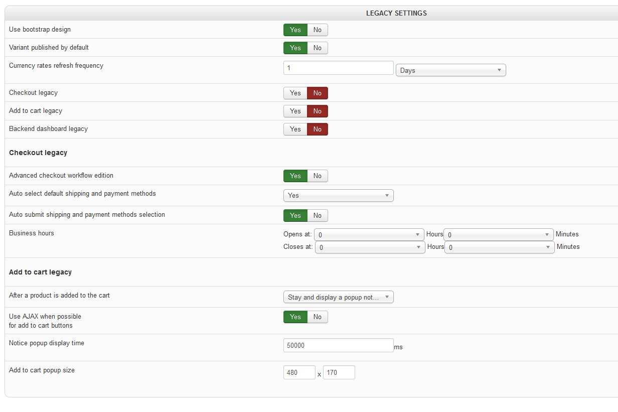

Just installed beta version and it looks great. Run smooth.
1. What is the status of the user points plugin?
It looks like after enabling use bootstrap design there are some mistakes with yes and no buttons. Also on change it refresh page and no ajax.
2. Not sure why but when i press add to cart with legacy turned off nothing happens. I also couldnt find that new cart plugin which was in alpha version. Tried with protostar template.

2 - Thanks for your feedback.
Indeed the "cartnotify" plugin was not correctly added in the Essential & Business packages but was still in the starter one.
I have updated the files so you will find that plugin (and also the backend dashboard module) in all packages.

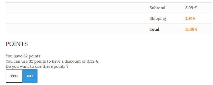

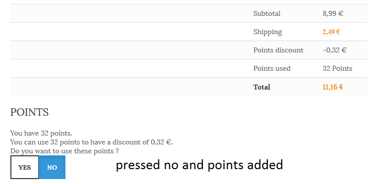

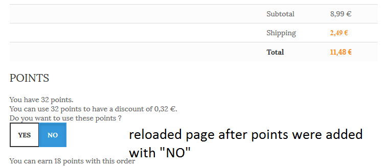

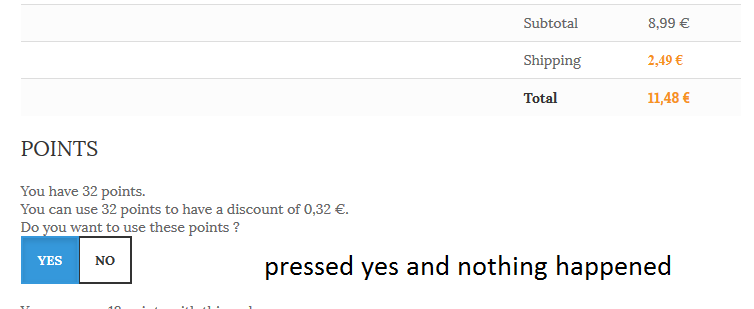

1. Will it be any updates to this plugin so it will use new checkout? I still see some issue with user points buttons.
This is what happening.
a. I come to checkout page which has user points. By default button is set to "NO" and all looks good.
b. To use points i press "YES" and points are used.
c. I press "NO" points are still used.
d. I press "YES" points are removed. ( if i refresh page here points are added again here ).
e. I press "NO" points are used.
This is happening with default protostar template.

1. 4. Could you provide some screenshots of the issue and of how you've configured your checkout and advanced settings and the user points plugins settings so that we have a clearer look at what you have on your end ?

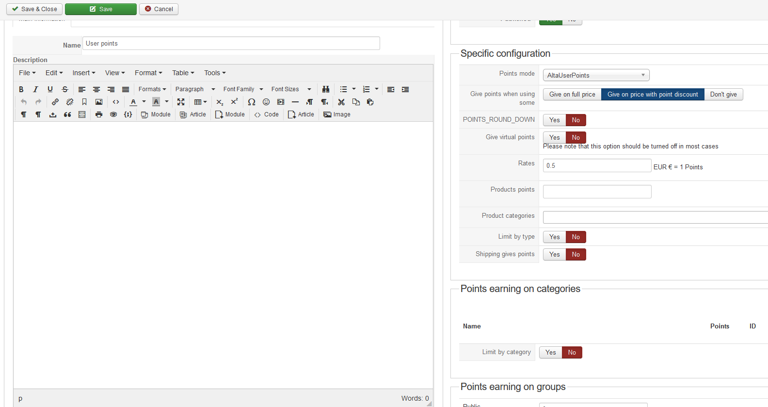

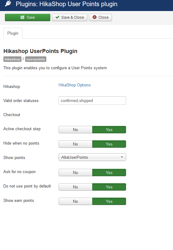

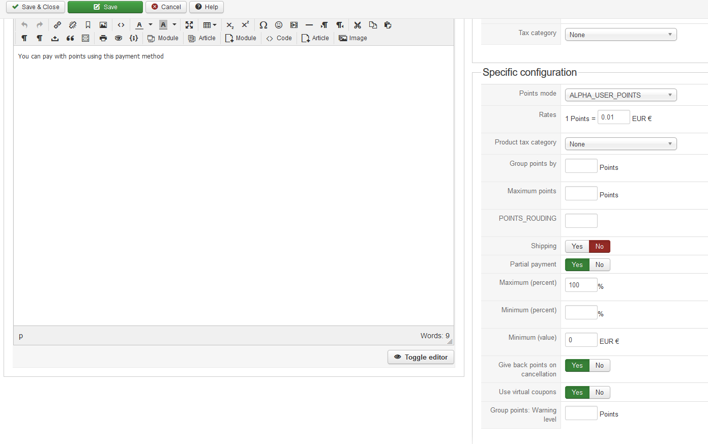

1. I have tried to be more clear as possible with my images. This for user points on checkout issue

1 - But, if you haven't the "bootstrap design", do you still have the "yes/no" issue ?
I'm trying to understand if the issue is related to "user points" or to the "yes/no".

1. I have tried to disable bootstrap and problem still there with new checkout system. Checkout legacy off.
If checkout legacy is on everything is working fine.

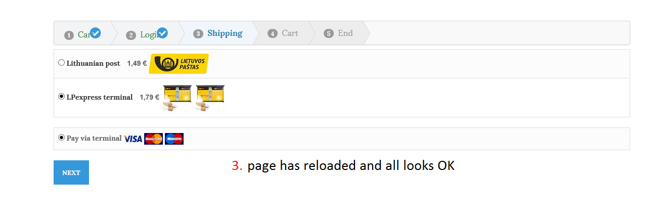

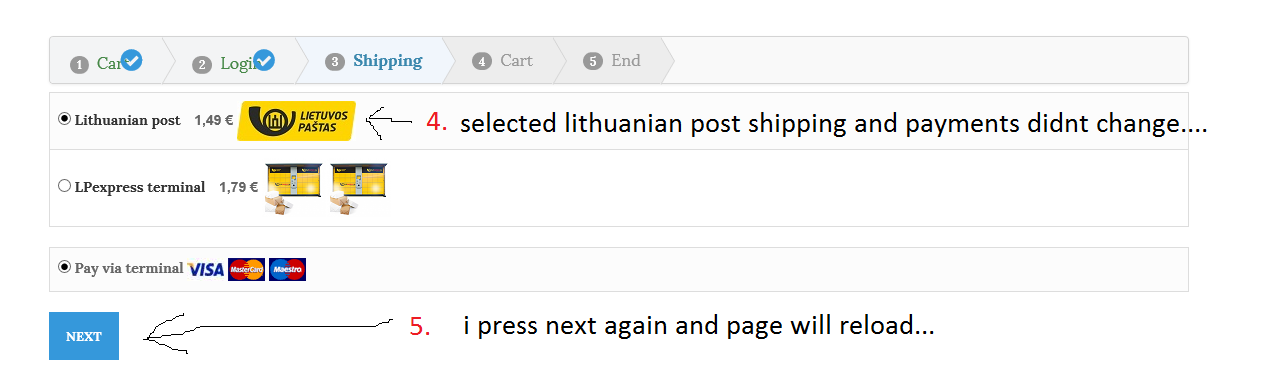

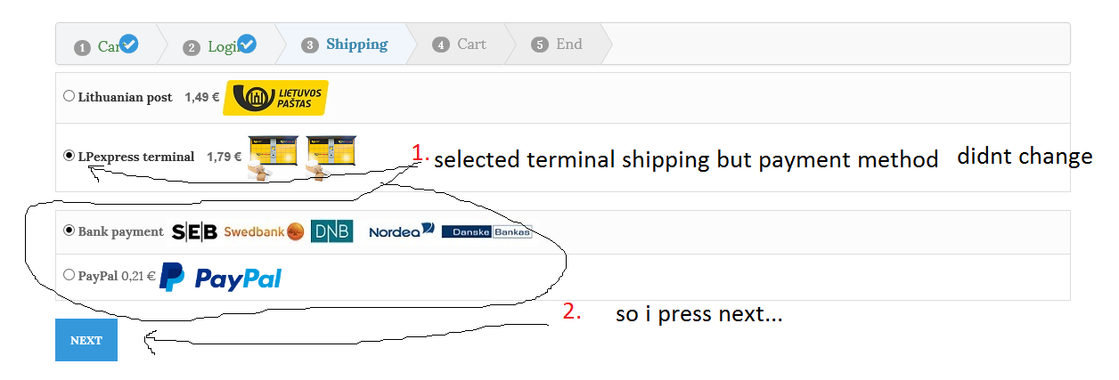

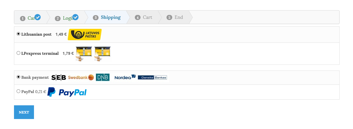

2. As I said in my previous message I have some issues with payment method restriction to shipping zones. As example I have restricted one payment method to show only if 1 shipping method selected. When I select that shipping method, shipping div refreshes but payment methods does nothing. If I try to select one of payment method which shouldn't be seen it does nothing. Its like selecting checkbox....
Only one thing what helps is to press button next, then all page refreshes and it shows as it should be. Then you can press button next again to proceed to next step....
3. I see same problem with fields view with both new and old checkouts. Field view isn't showing with checkout legacy on or off....All happened after beta installation....

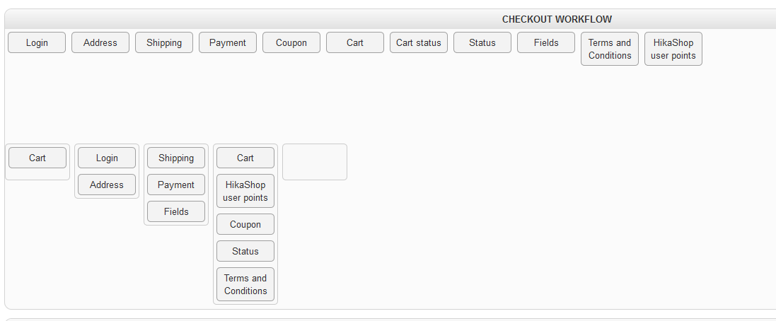

5. My checkout workflow is set up like this: Cart-> login, address-> shipping, payment, fields->cart,userpoints,status,terms->end
I am not logged in. I add product to cart, go to checkout and I am in cart view, press next I see login form, I LOG IN here, I see address form, trying to press edit icon it gives me invalid token (address form hidden, only next button shows), I press next and I see blank page with "invalid token" on the top left corner, pressing browser button back and all works fine. I can edit address. I have tried many times and always same result...
I can give back end access of test site if it would help to resolve it faster for you Jerome.

1. Okay ; we will take a look at it.
2. Would it be possible to have screenshots of your specific restriction/configuration in order to reproduce it in a local website ?

5. I'm sorry but I need to "see" a checkout workflow configuration using a screenshot and with the rest of the checkout settings.
Checkout is complexe and to reproduce an issue we need to know the exact configuration and the exact user workflow.
But in our case hopefully, the workflow is not required.

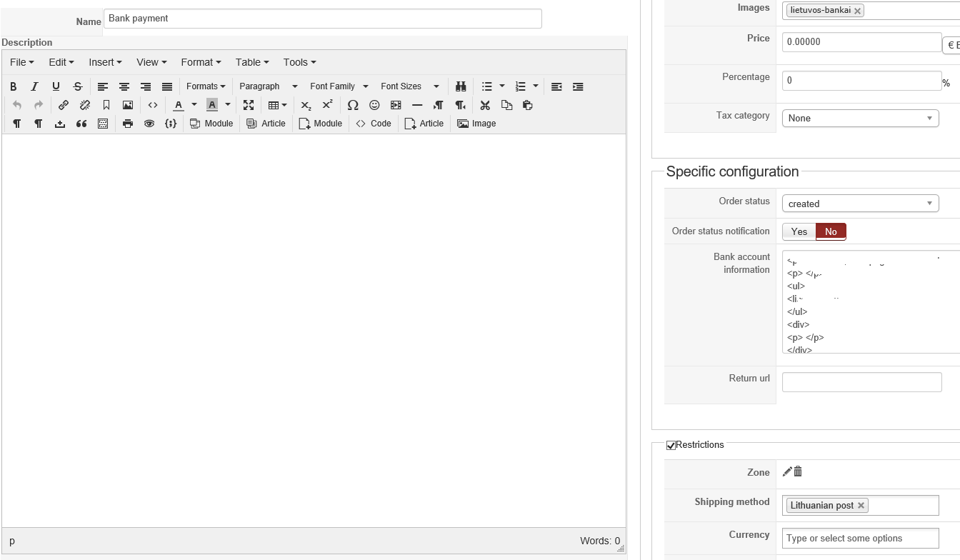

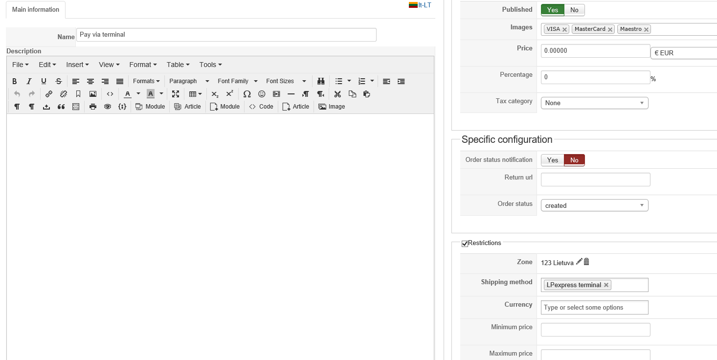

2. So I have 2 shipping methods and 3 payment methods.
Shipping methods: 1.Lithuanian post, 2.LPexpress terminal
Payment methods: 1. Bank, 2. Paypal, 3. Pay via terminal
Bank and paypal payment are restricted to Lithuanian post shipping method
Pay via terminal payment method is restricted to LPexpress terminal shipping method
Screenshots attached....
Please take a look at screenshot named "shipping" you will see what is the issue...
3. Ok, I see. Will check it later after finished version.

It contains elements to fix your issues : 2 & 5.

Great. It works perfect now. If I find any other issues i'll update it here.

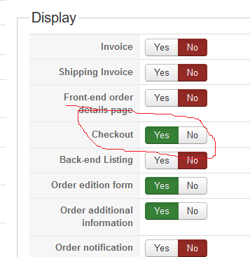

For point 3 i am confused. Should i set it to display in front-end to YES? If i set it to yes it shows in checkout but problem is that i would like to show some fields based on shipping method selected.

9 years 9 months ago #259463 by nicolas
Replied by nicolas on topic Hikashop 3 beta questions
Yes, that option must be turned on.
And that code can still work but you need to add it in the file "show_block_fields" for the new checkout as fields is used only for the legacy checkout.
More
