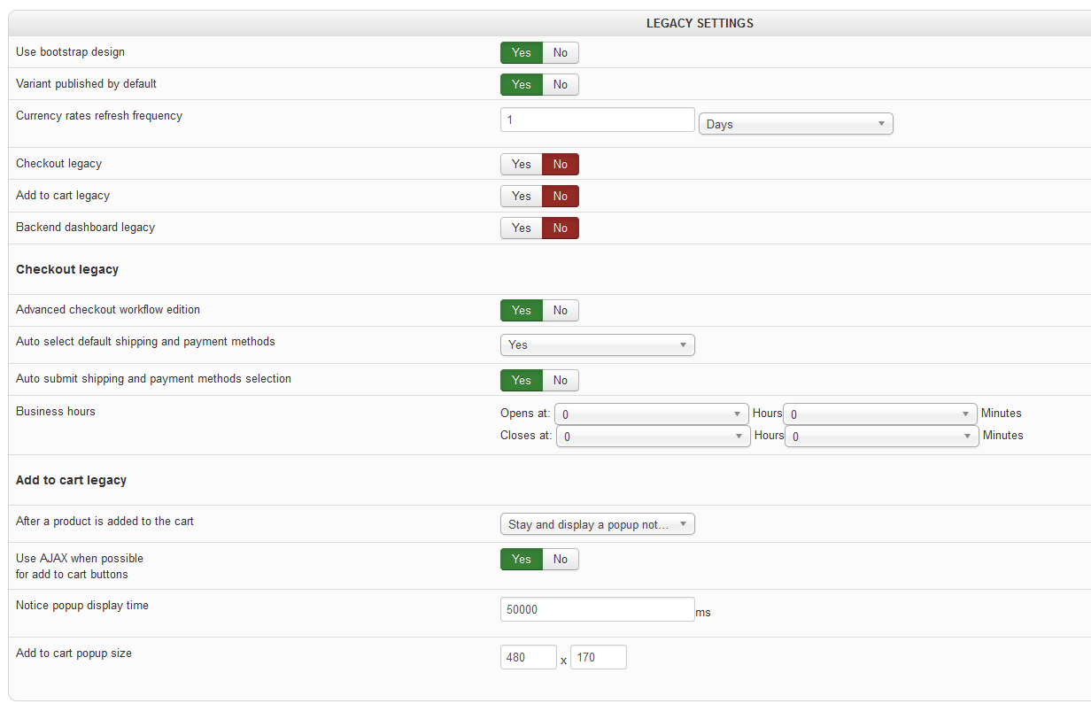

2. Not sure why but when i press add to cart with legacy turned off nothing happens. I also couldnt find that new cart plugin which was in alpha version. Tried with protostar template.

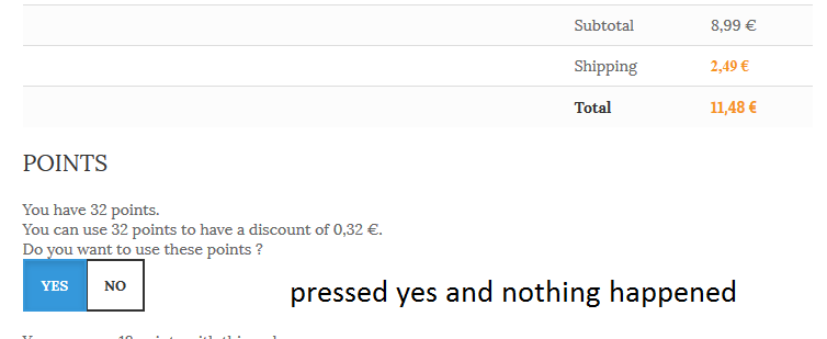

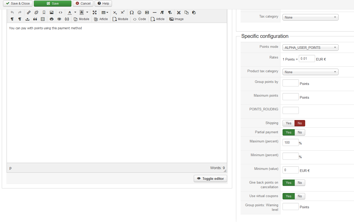

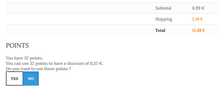

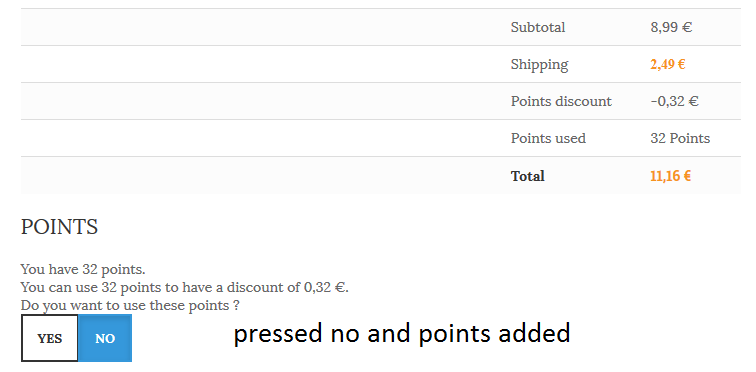

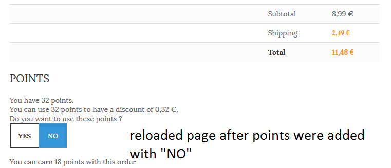

1. Will it be any updates to this plugin so it will use new checkout? I still see some issue with user points buttons.
This is what happening.
a. I come to checkout page which has user points. By default button is set to "NO" and all looks good.
b. To use points i press "YES" and points are used.
c. I press "NO" points are still used.
d. I press "YES" points are removed. ( if i refresh page here points are added again here ).
e. I press "NO" points are used.
This is happening with default protostar template.

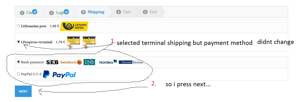

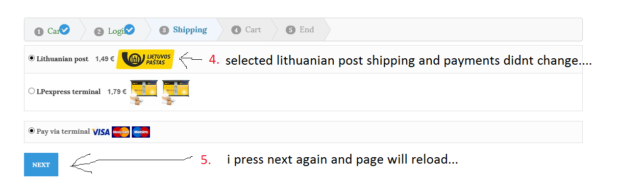

4. I have shipping and payment on one checkout step. Changing shipping method payment methods are not refreshed. You need to press next button for it to update. I am talking about restriction....

1. 4. Could you provide some screenshots of the issue and of how you've configured your checkout and advanced settings and the user points plugins settings so that we have a clearer look at what you have on your end ?

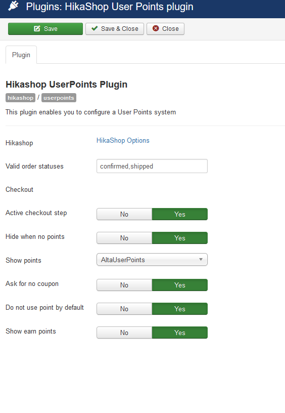

1. I have tried to be more clear as possible with my images. This for user points on checkout issue

1 - But, if you haven't the "bootstrap design", do you still have the "yes/no" issue ?
I'm trying to understand if the issue is related to "user points" or to the "yes/no".

1. I have tried to disable bootstrap and problem still there with new checkout system. Checkout legacy off.
If checkout legacy is on everything is working fine.

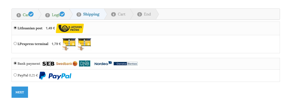

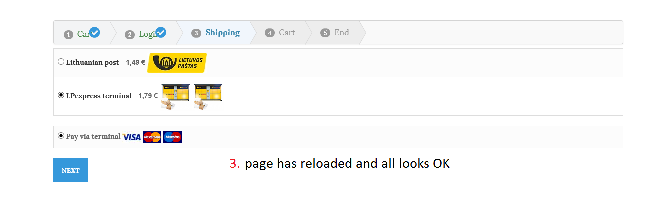

2. As I said in my previous message I have some issues with payment method restriction to shipping zones. As example I have restricted one payment method to show only if 1 shipping method selected. When I select that shipping method, shipping div refreshes but payment methods does nothing. If I try to select one of payment method which shouldn't be seen it does nothing. Its like selecting checkbox....
Only one thing what helps is to press button next, then all page refreshes and it shows as it should be. Then you can press button next again to proceed to next step....

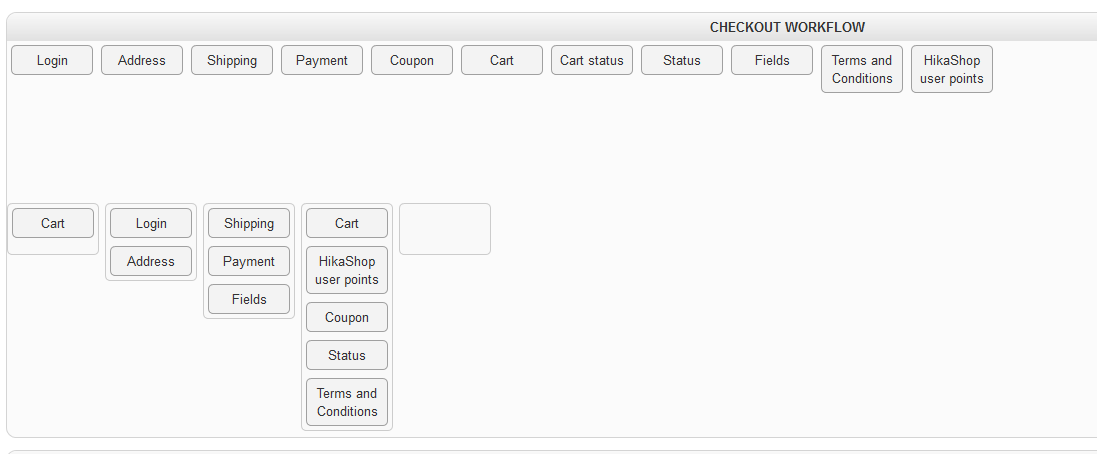

5. My checkout workflow is set up like this: Cart-> login, address-> shipping, payment, fields->cart,userpoints,status,terms->end
I am not logged in. I add product to cart, go to checkout and I am in cart view, press next I see login form, I LOG IN here, I see address form, trying to press edit icon it gives me invalid token (address form hidden, only next button shows), I press next and I see blank page with "invalid token" on the top left corner, pressing browser button back and all works fine. I can edit address. I have tried many times and always same result...

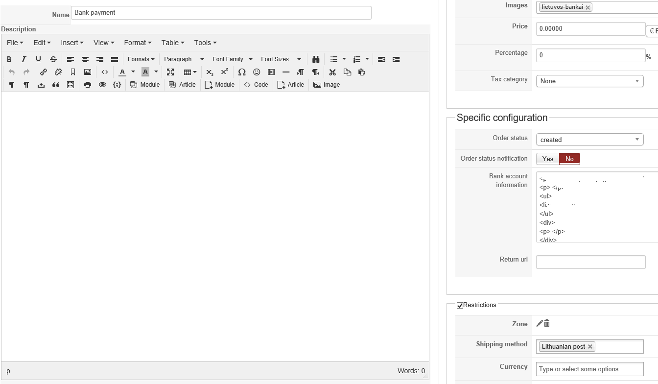

2. Would it be possible to have screenshots of your specific restriction/configuration in order to reproduce it in a local website ?

5. I'm sorry but I need to "see" a checkout workflow configuration using a screenshot and with the rest of the checkout settings.
Checkout is complexe and to reproduce an issue we need to know the exact configuration and the exact user workflow.
But in our case hopefully, the workflow is not required.
You're facing the problem I just described in my previous post. So we will investigate on it.

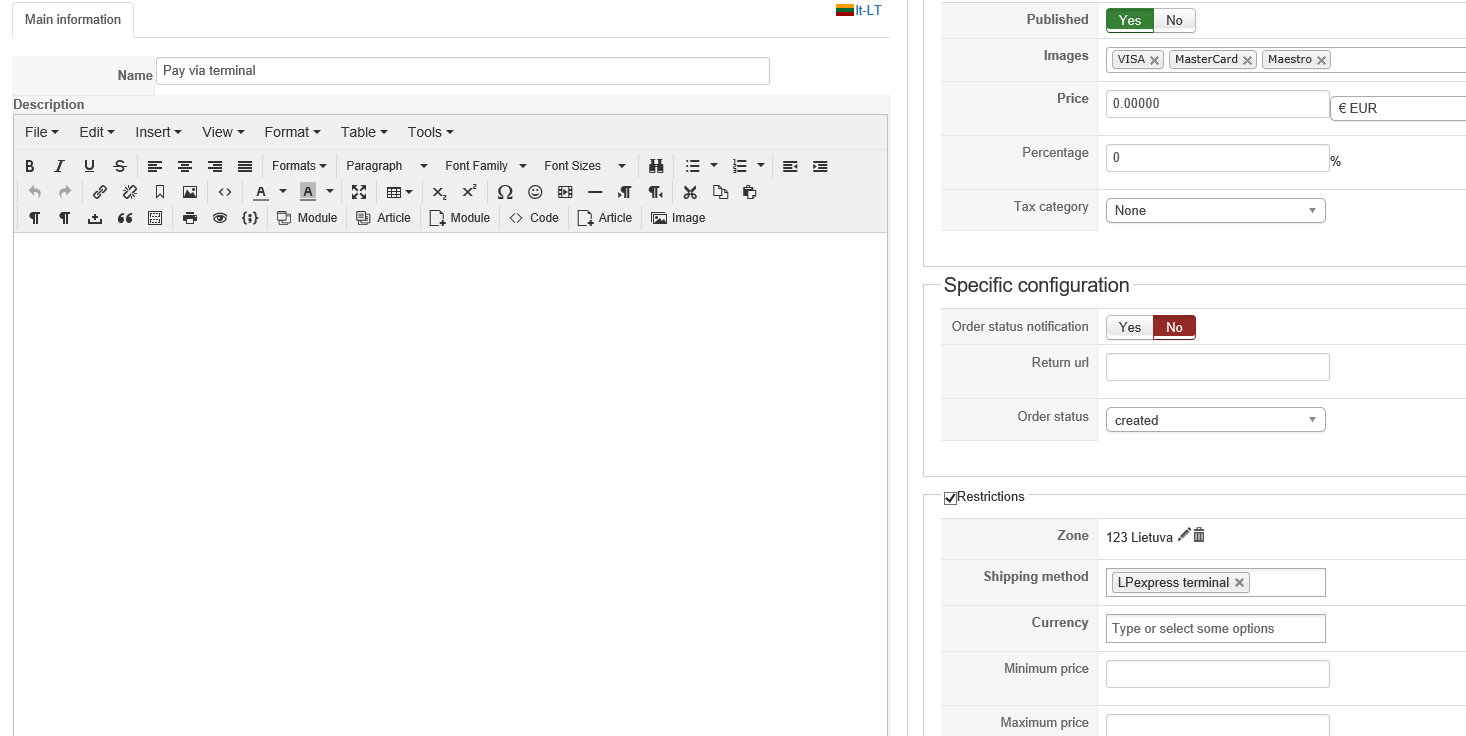

2. So I have 2 shipping methods and 3 payment methods.
Shipping methods: 1.Lithuanian post, 2.LPexpress terminal
Payment methods: 1. Bank, 2. Paypal, 3. Pay via terminal
Bank and paypal payment are restricted to Lithuanian post shipping method
Pay via terminal payment method is restricted to LPexpress terminal shipping method
Screenshots attached....
Please take a look at screenshot named "shipping" you will see what is the issue...

9 years 8 months ago #257813
I have just update the beta package with some fixes and improvements.
It contains elements to fix your issues : 2 & 5.
For the issue 1 ; I still have to take a look at it, it's in my list :)

9 years 8 months ago #257827
Great. It works perfect now. If I find any other issues i'll update it here.

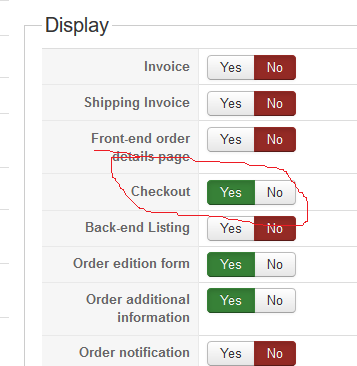

For point 3 i am confused. Should i set it to display in front-end to YES? If i set it to yes it shows in checkout but problem is that i would like to show some fields based on shipping method selected.

1. So it looks like the settings are a little bit different with hikashop 3. Why you have removed checkout display option in custom field?
I have set option display in front-end to YES and it is working fine with old checkout but it seems i can't get it work with new one.

9 years 7 months ago #259512
1. I've removed it as we now use the "frontend" setting instead.
