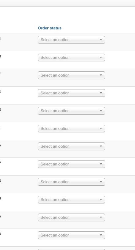

  • Posts: 57
9 years 7 months ago #260998
Hey
I know it's in French here but couldn't find anything in English...
I have made a copy of a Hikashop Business 2.6.4 site and redesigned it. Then upgraded to Hika 3. The I tried to import orders from 2.6.4 to 3 and got the error :
1146 Table 'xxxxxxxxx.#__hikashop_orderstatus' doesn't exist SQL=SELECT orderstatus.* FROM #__hikashop_orderstatus AS orderstatus WHERE orderstatus.orderstatus_published = 1 ORDER BY orderstatus.orderstatus_ordering
I have created the table orderstatus using :
CREATE TABLE IF NOT EXISTS `theret_hikashop_orderstatus` (
	`orderstatus_id` int(10) unsigned NOT NULL AUTO_INCREMENT,
	`orderstatus_namekey` varchar(255) NOT NULL,
	`orderstatus_name` varchar(255) NOT NULL DEFAULT '',
	`orderstatus_description` text NOT NULL,
	`orderstatus_published` tinyint(4) NOT NULL DEFAULT '0',
	`orderstatus_ordering` int(10) unsigned NOT NULL DEFAULT '0',
	`orderstatus_email_params` longtext NOT NULL DEFAULT '',
	`orderstatus_links_params` longtext NOT NULL DEFAULT '',
	PRIMARY KEY (`orderstatus_id`),
	UNIQUE KEY `orderstatus_namekey` (`orderstatus_namekey`)
) ENGINE=MyISAM /*!40100 DEFAULT CHARACTER SET utf8 COLLATE utf8_general_ci*/;
Now, how to import all the values from 2.6.3 to hika 3?
